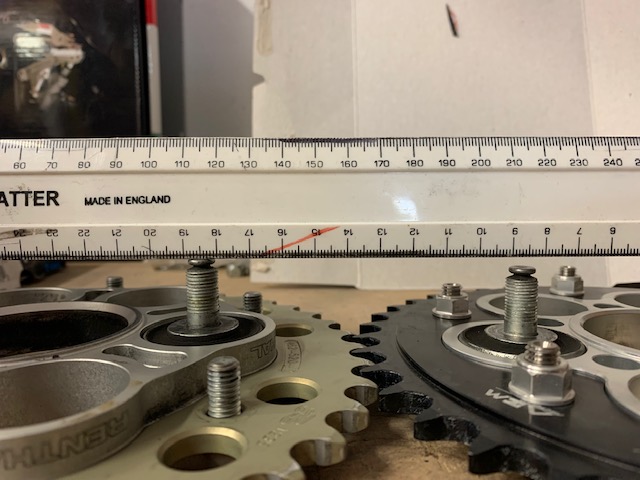

  2. if you have a 182 you need 183
    if you have a 183 you need a 182
  3. here's a good picture of the difference..

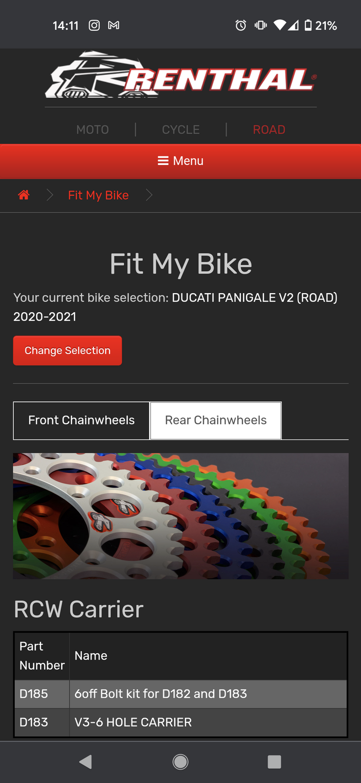

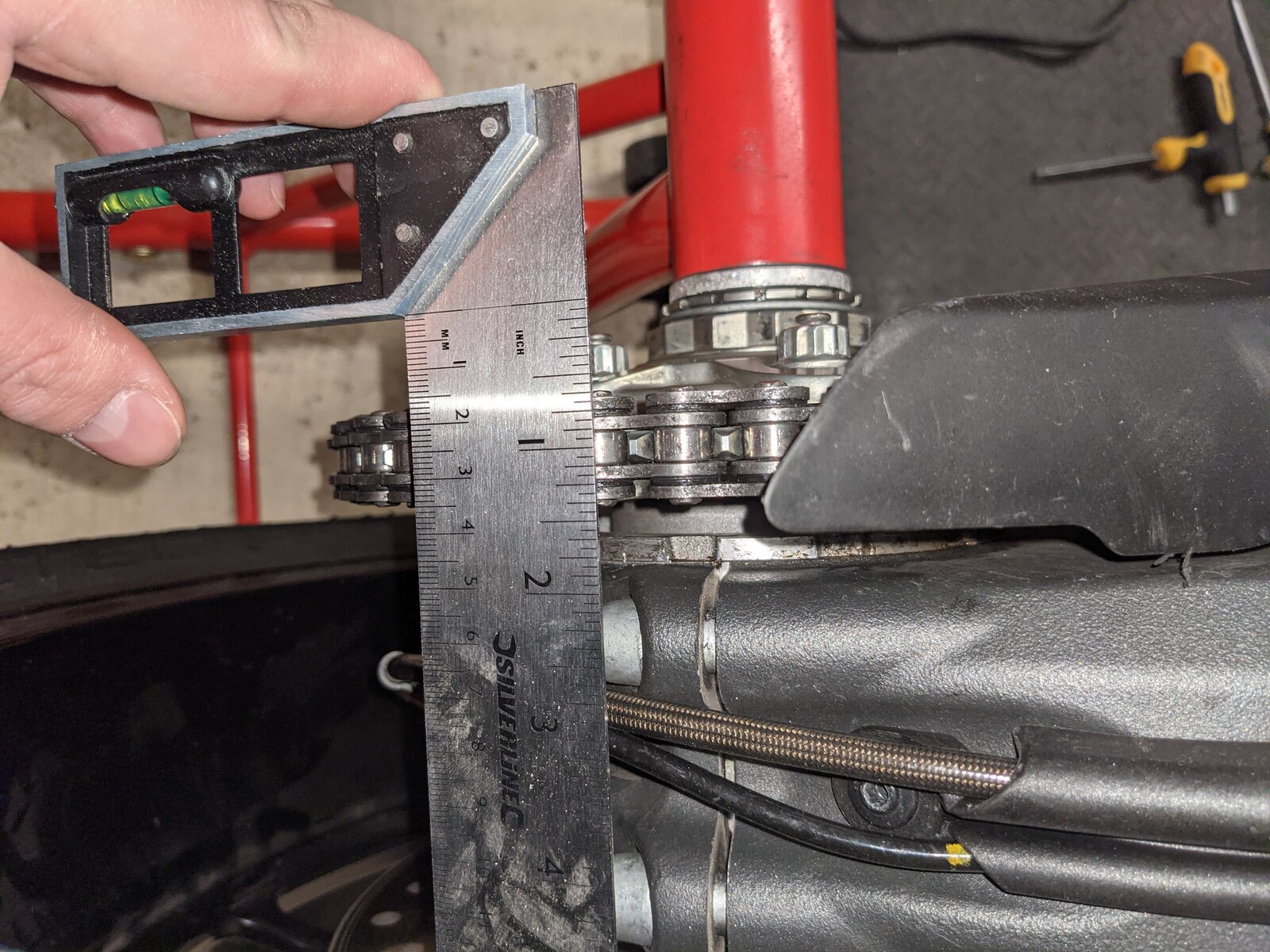

  7. I'll be careful how I answer that :joy:! Sort of yes, I sent him measurements of the sprocket carrier and sprocket to show the height from the base of the carrier. Andy suggests I need a 183 carrier. I spoke to the supplier of it today and sent them some pics too. They have had to send to Renthal as they suggest 182 and think that Renthal 'may have dropped a bollock' on it. Lets see what comes back though and I'll update.
  8. Heard back today. After much investigating, also with Renthal themselves (they listed 182 on their site for the V2) by the supplier of the kit, talking to a couple of Tri Options chaps etc, it appears as @andyb suggested that I need a 183 carrier so they are sending one out to me. Once I've had chance to fit it, I'll update again as this might be useful to someone else in the future.

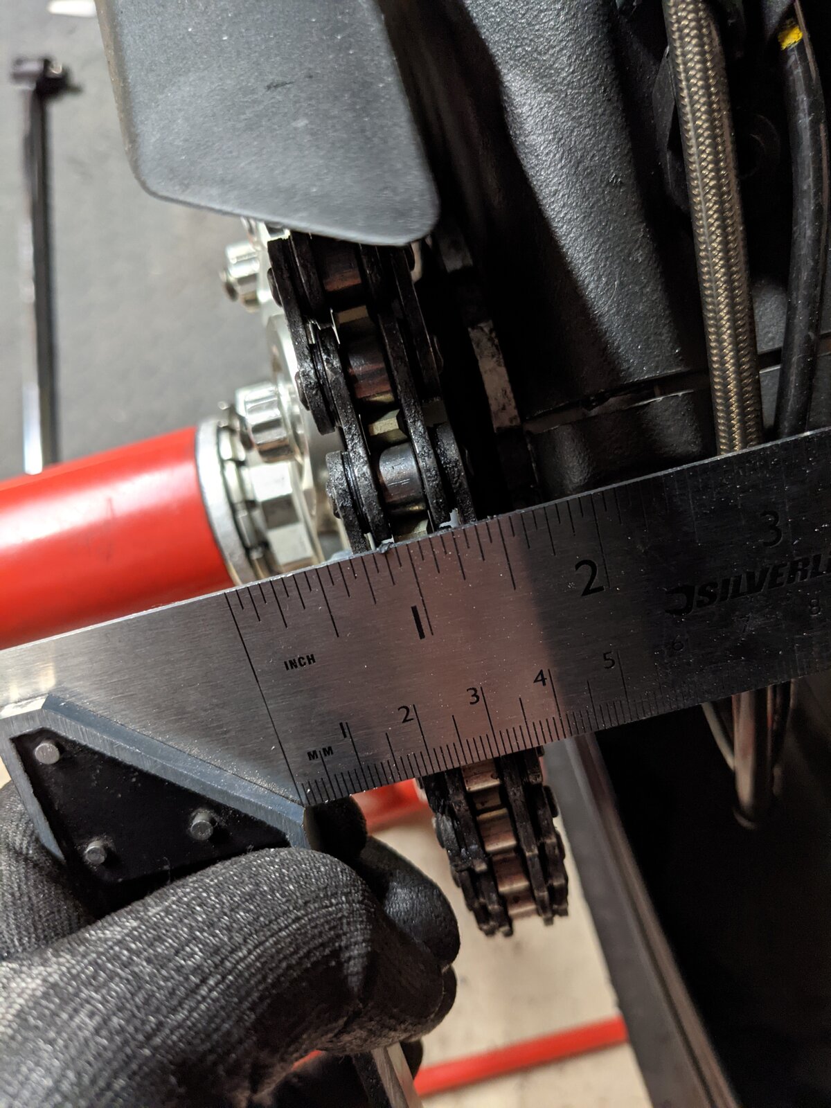

  9. Quick update. New carrier arrived (183) and fits much much better. Very slightly off, but I'm getting the chain and front sprocket changed Tuesday and from what @Dave dunlop said, that might fully align it anyway. If not, I'll prob put the washers behind the sprocket to add the extra mm or 2.
    New 183
    Original for reference
  10. Looking better now:upyeah: think mine was around 1mm out, front sprocket seemed to sort out any slight indifference in tolerance. Must be some kind of plus or minus figures that are acceptable when fitting this aftermarket stuffo_O certainly know it still has some wiggle room. Just so long as it’s running inline and nice and true up against the plastic chain guide on the swinging arm :upyeah:

  12. Now all good. Blitzed round track and fine. Renthal now changed their product mapping too. I shall send them an invoice :laughing: hope all this helps someone in future :upyeah:
