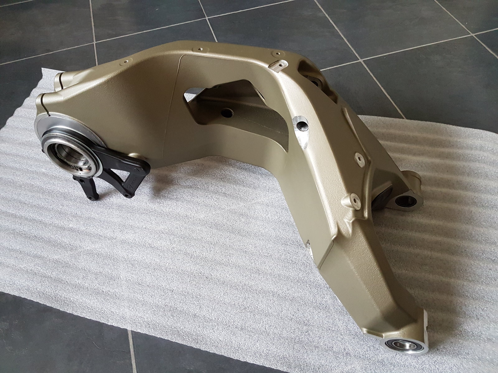

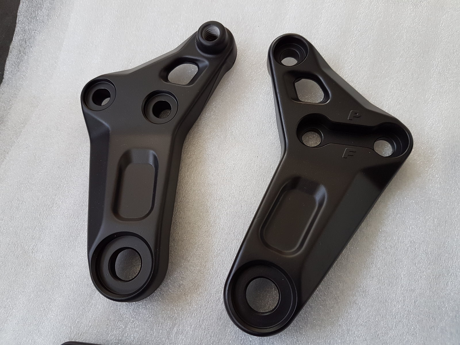

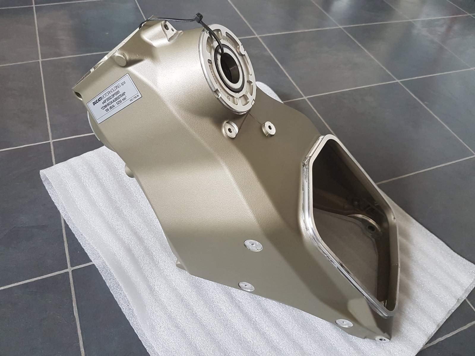

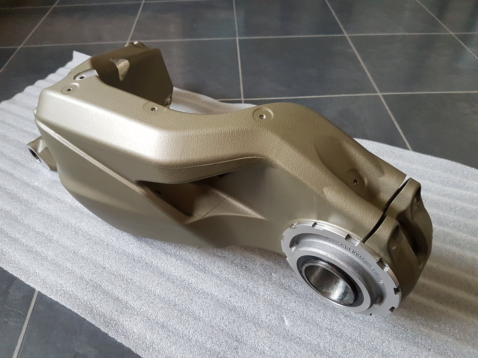

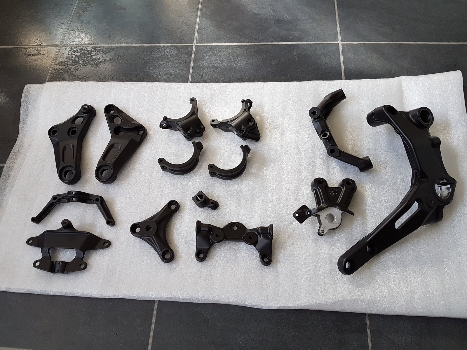

  9. Here are some pics of the parts they did. The fact that it is so thin, also means it won't have any impact on threads or affect fitting tolerances on machined surfaces, though critical areas were still masked off. Hi-Spec coating are based in deepest darkest Sussex, but there are others offering this service elsewhere. It is a very specialized coating and as such few places are approved to apply it.
