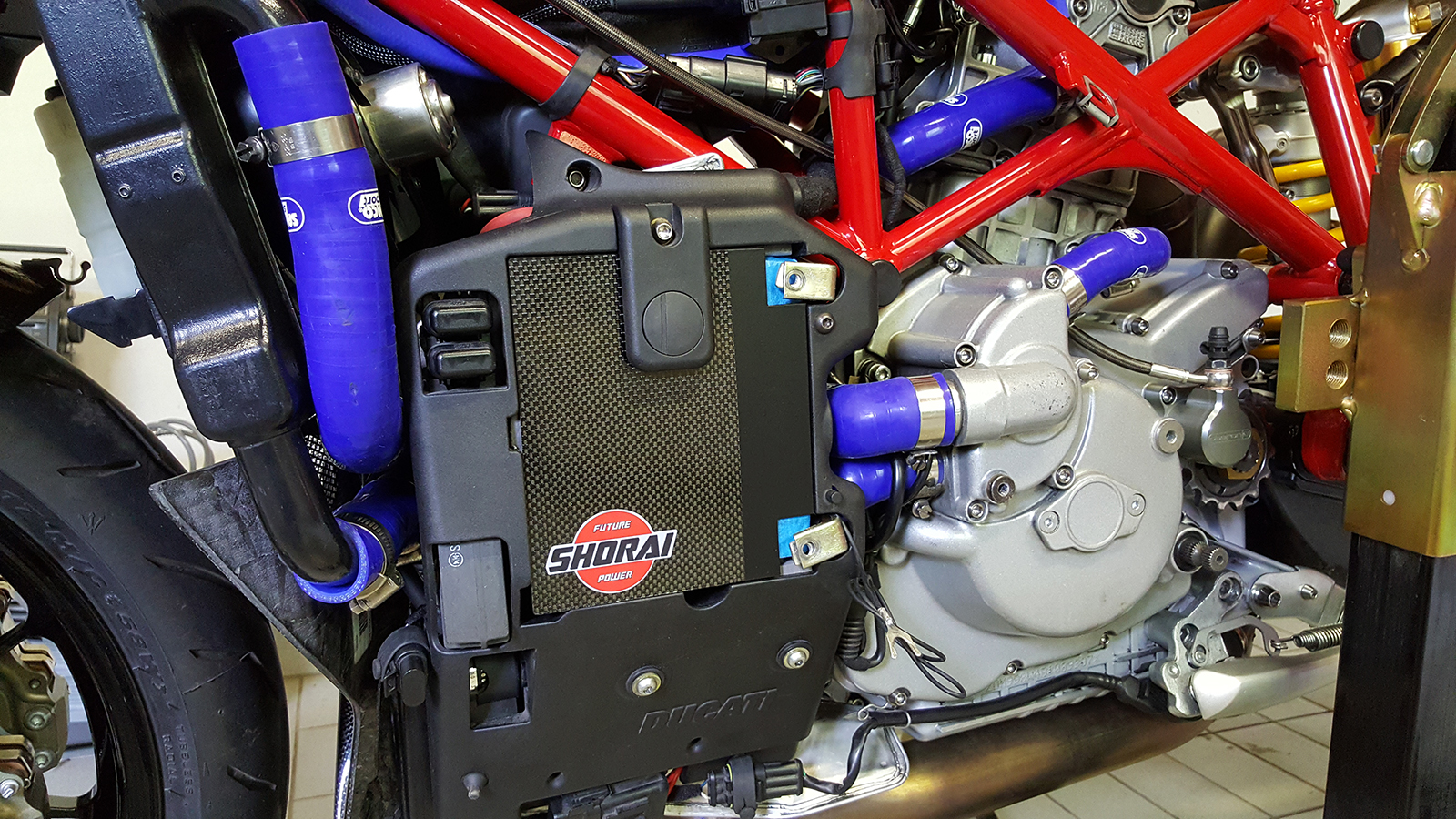

    I was hoping to fit a 14 AH one but they all seem to be too big for the battery holder!.

  2. Standard fitment Yuasa is where i would be heading - Halford's with discount if you have the trade card :):upyeah:
  3. ^^^that^^^
    just make sure when you add the fluids and tap the top down it's in properly or it can leak on it's side.

    I'd go for a nice lightweight Lithium battery if I were you and screw what anyone else thinks

  5. ..which will mean you'll need a lithium battery charger also..
    • Face Palm Face Palm x 2
  6. You can use a non-lithium if it’s of the correct voltage
  7. Shorai LiFePo all the way :)

  11. MBTX12U MOTOBATT Quadflex AGM Bike Battery 12V 14Ah.
    On the Bay at £50.
    14ah and should fit.
    Mark.
  12. However you don't charge them up with a circuit designed for a specific sized Lead Acid battery.:rolleyes:
    That circuit may be placed very close to a hot exhaust and be working close to design limits.:bucktooth:
    It is actual going to take someone loosing a bike before my advice is heeded..... :mad::broken_heart::motorcycleduc:
    There are already members on here you have suffered damaged to their motorcycles due to the installation of Lithium batteries on motorcycles not designed to take them.

  13. I would still go Yuasa standard fitment - similar price from Argos with the discount :thinkingface: better warranty as well...

  14. Here’s the thing. It will work and you should be lucky. But if you get a charging circuit fault you might not be lucky and it won’t be funny if it goes wrong. Is it possible to buy a lithium battery with additional protective electronics as part of the design so it can be guaranteed as OK to fit on lead acid charging circuitry even if that produces over voltage or current?
  15. Not that I’m aware of but the Shorai batteries are Li-Fe not Li-po, or Li-Ion. So less to worry about as they will not burst into flames in the same spectacular ways as others on the market.
    As with everything, it’s a personal choice and depends on what’s your most important buying motive. There is however too much scaremongering in relation to these batteries rather than offering a balanced view IMO
  16. I’ve seen a picture of a Paul Smart burnt to a crisp by a Shori... :bomb:
  17. I didn’t say it couldn’t happen. I’ve seen the mess first hand that a led acid battery makes when it goes wrong too.
    The fact is neither are 100% guaranteed
