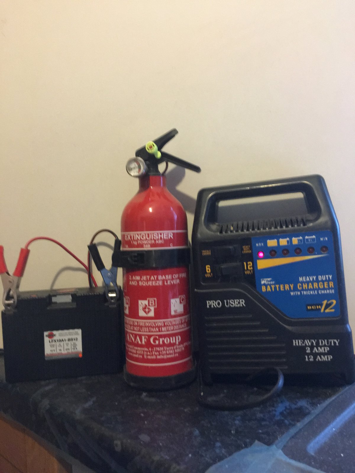

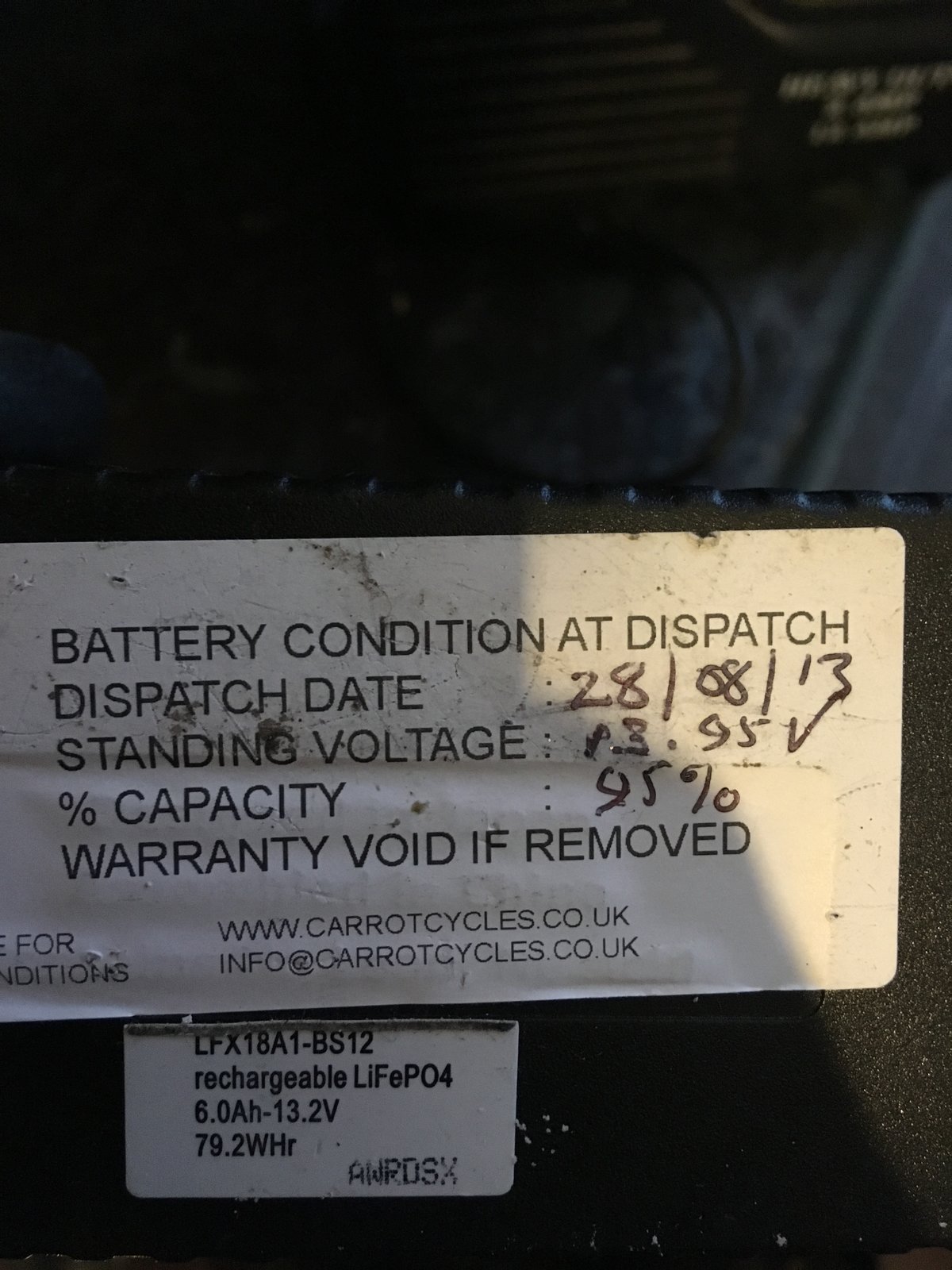

  9. Nothing more than i’ve followed Shorai’s instructions for the last 5 years. It can be charged by a regular charger ( not earlier optimate types). Or their own dedicated charger which plugs into a port on the battery.
    Extinguisher for comedy effect.
    I’ve never said other brands of lithium battery can be treated this way.
    Imagine the torrent of posts if it ever goes up in flames. o_O
