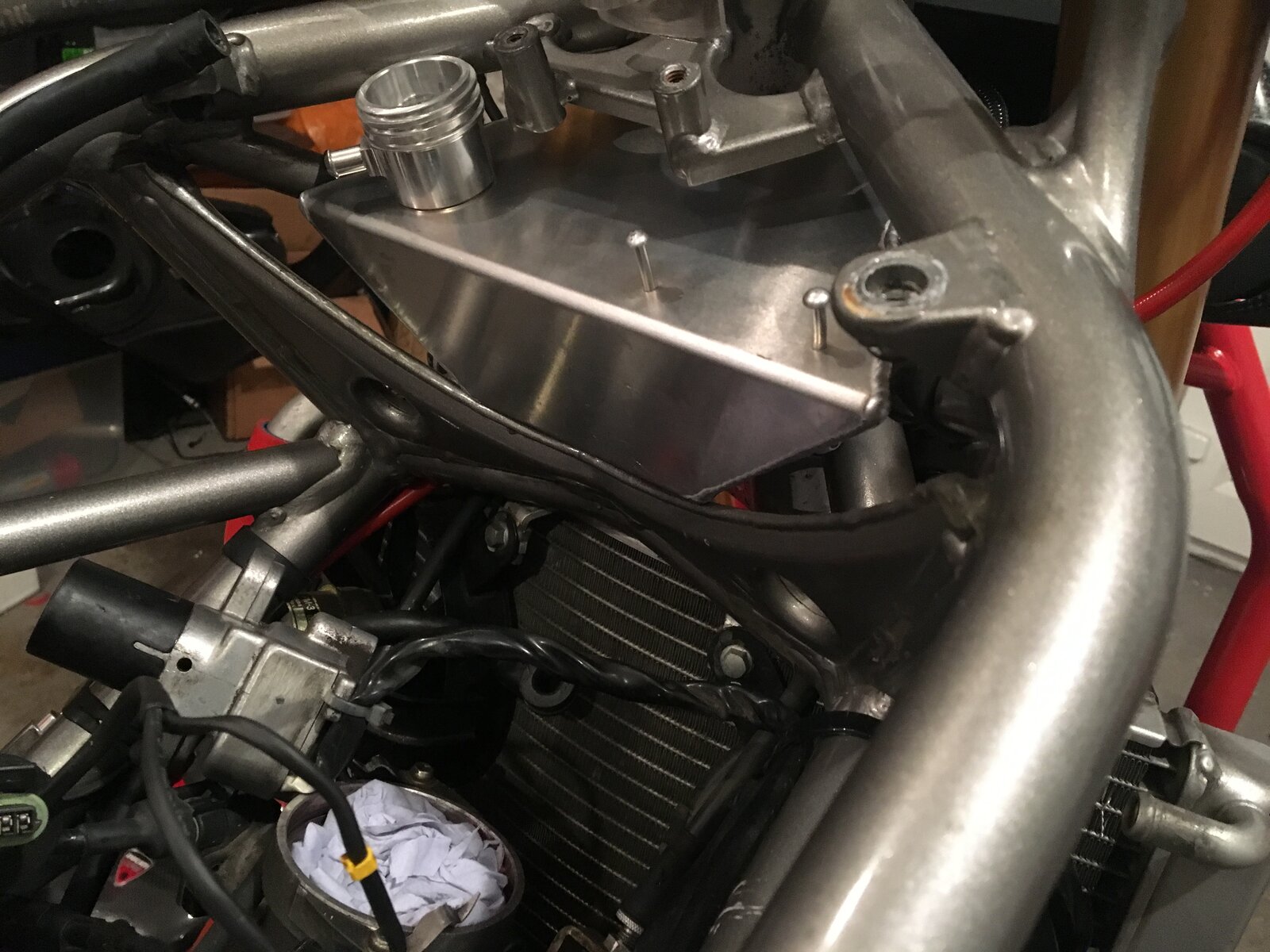

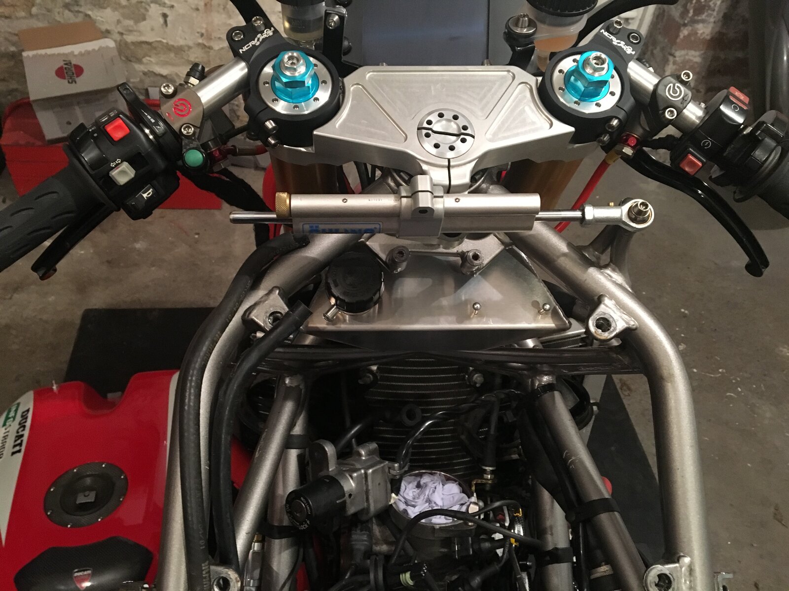

  3. Can’t go wrong with the alloy one. Not sure I understand the ugly bit as you can hardly see it when fitted.
    If it’s for the colour, they look ok powder coated black.
    9522E3B0-00A3-47AD-8A0C-A81DFBE5AE31.jpeg ACEA3B2D-6357-4B4A-AA54-E0B27BA193F2.jpeg 3E7B7C22-5620-4D21-96F7-8B7C5C5A2E69.png

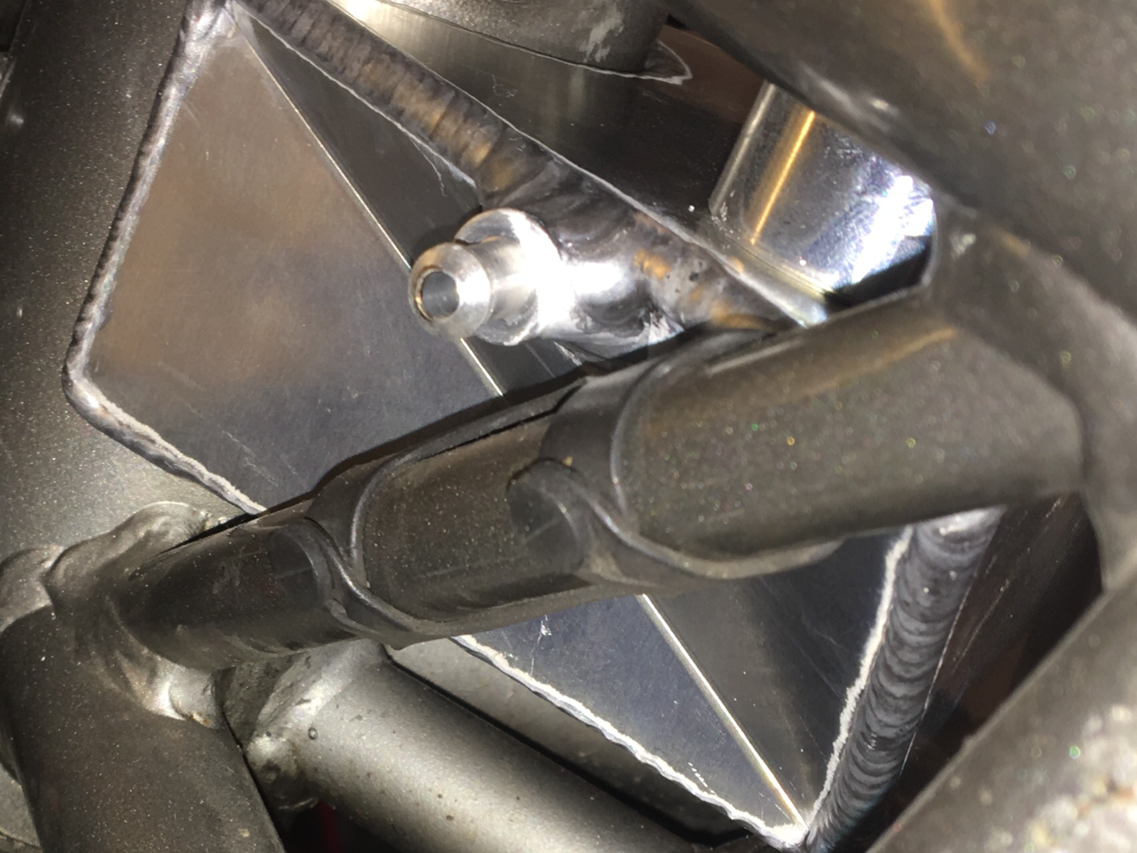

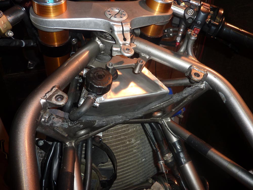

    I fitted an ally tank, not the Motowheels but one made by a chap from a US forum (no longer does them) and have had no bother since.
    I wouldn't bother with the Ducati part again as they're crap and you'll get no warranty. The EVR/Kevlar look good (can you really see it?) but are you sure it'll never leak? Due to it's construction I know my ally tank will never leak but even if it did it could be repaired.
    The only downside is you can't see the coolant level as it's not transparent but that also applies to the EVR and I've never needed to top-up anyway. On the plus side the ally tank acts as a heatsink so might help cooling, as for looks, I think it looks fine but you can hardly see it anyway...

  15. Hi guys. I have just gone down the route of fitting one of the Motowheels tanks. i'll echo was has been said uptheread about them. They look a tidy job.
    I must admit, knowing what a faff it is, I paid a guy at a local (not Ducati specialist) garage to fit it. He told me he had to file away a bit of the pins to get the sensor to fit. It is then orientated 180 degrees rotation from the stock position. However, that doesn't seem to matter, and sensor and its lead are clear of the tank and airbox when everything is refitted.
