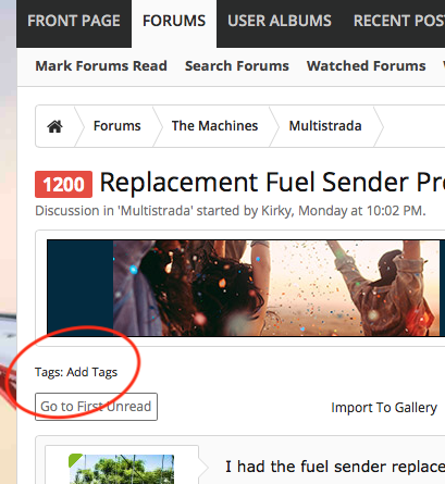

    What we ALL need is the ability to add TAGS to posts, at the moment only the OP can do that and with all due respect they are unlikely to know how to do it.
    MULTISTRADA, KM/H, FUEL SENDER, FUEL GAUGE, ERROR, PROBLEM, 2010, MTS1200, FIRMWARE, SOFTWARE, ECU, UPDATE, RECALL, KNOWN PROBLEM, COMMON PROBLEM
    @Rob any news on this useful suggestion for others to be able to TAG threads?
  14. Done. Users can now add tags to threads:
  15. Thanks Rob, I put a couple on to try out as Aircon suggested.
