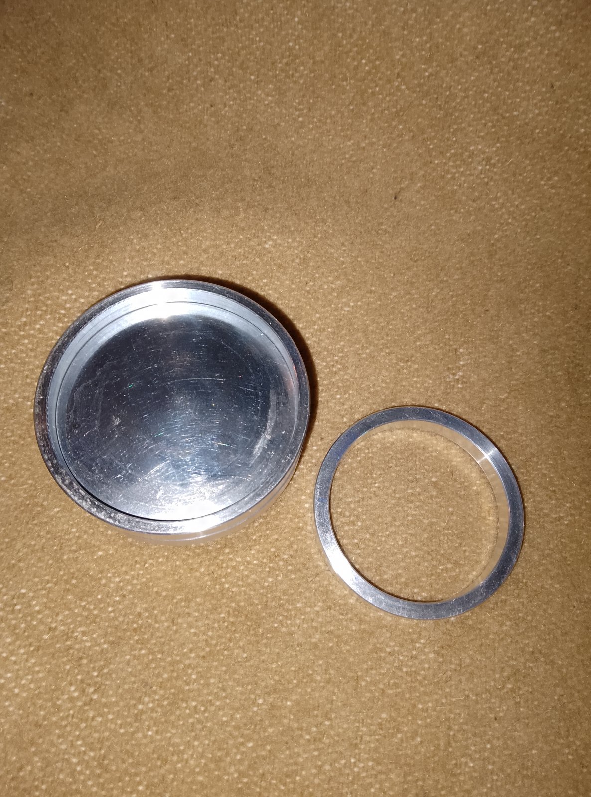

  9. I'm half-way through busy replacing the lense on the oil temperature guage on my 996, so have read all the threads on the subject. If you find a flat lense it is fairly simple to make it into a domed one in the oven.

  12. Good idea, I guess you'd have to put in on an upturned plate or similar, so that it takes that shape as it warns up?
  13. No, I think let it sag into the glass, that way it will be even. (Hypotheses)
  14. I've been down that road. There's a very fine line between poly carbonate softening enough to be shaped and it being too hot and your lens being a total mess with bubbles or thinning out, having fingerprints, tool marks etc. Certainly my kitchen oven isn't keeping the temperature reliably in the range so I found that I had to throw 2 lenses away for every one that turned out satisfactory. The theory of the material just sagging into some kind of mould didn't come true for me either. I made some tooling to be able to shape the lens. It's a positive mould rather than a negative which is how these things usually are shaped. At least my discussions with people who are or were in this kind of business indicates that's the way to do it. If I really wanted to make one for myself, sure I can do it but it's not as easy as it seems.
    I've given up trying to make them in numbers as nobody in their right mind would pay what I would need to charge to make it worth my time.
    You may find a watch glass for the temp gauge but the larger ones are a lot more difficult to find of the shelf. I looked but I could not find anything suitable.
