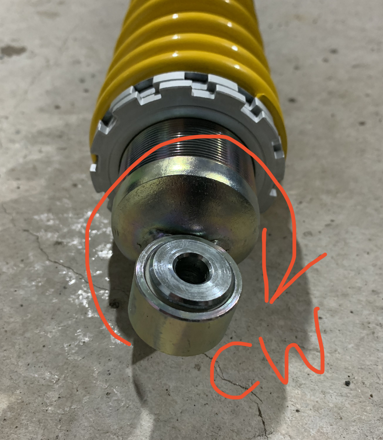

    just looking for some advice on replacing the corroded monoshock on my 821 Stripe.
    - what are the main steps involved? I couldn’t find any guides online?
    - I’m a beginner mechanic so I can’t tell how big a job this is

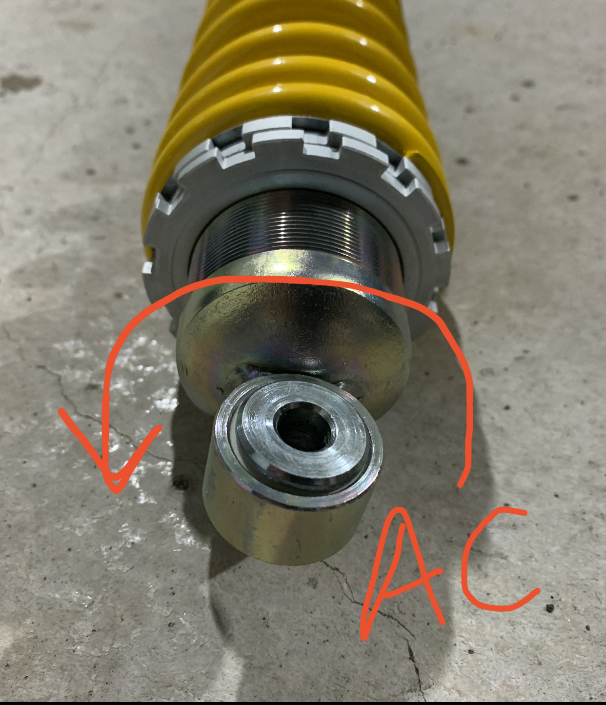

    - I had a go at adjusting the front and rear suspension to the recommended settings in the manual and managed to do everything apart from adjust the ‘collars’ on the monoshock. I couldn’t get either of them to budge. The pics below are of the new one (I couldn’t get them to budge either).
    - do they turn clockwise or anti-clockwise to compress the spring?
    B0F3EB9C-BA03-4F61-97F2-B4BCA07AE13B.jpeg 627ED30F-0295-4B58-837C-BDE532707434.jpeg FFB2CC79-D8A1-424F-9817-77EDBC249BB1.jpeg

  4. The rings turn clockwise to compress the spring. They act as a pair of locknuts. You will have to loosen the lower one first to separate them.

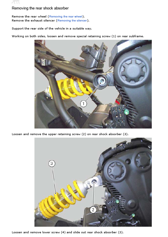

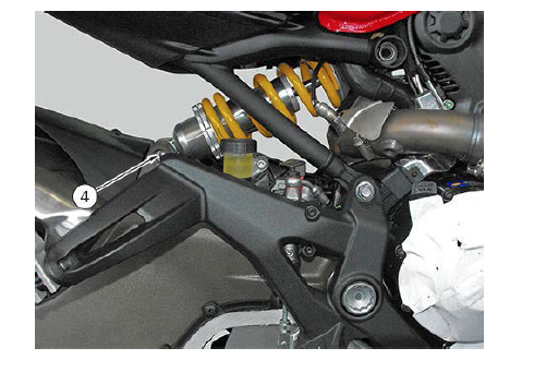

    To change the shock you will need to support the bike with the rear wheel off the ground and suspension unloaded using an Abba stand or similar.
    Procedure for shock removal here:
    Screen Shot 2020-04-21 at 10.08.58.png Screen Shot 2020-04-21 at 10.09.10.png
    Refitting is the reverse. Grease the top and bottom bolts and torque to 42Nm.
