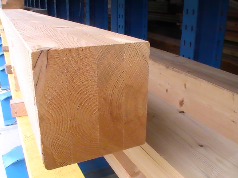

  15. There's more to laminating timbers than just screwing 2 pieces of timber in uncontrolled conditions
    This is the desired end result, good luck achieving it at home!
  17. Im fully aware of that, that's why I said it's debatable, having made and used laminated beams to span barns 30m wide i know there capabilities and strength.
    Steve
