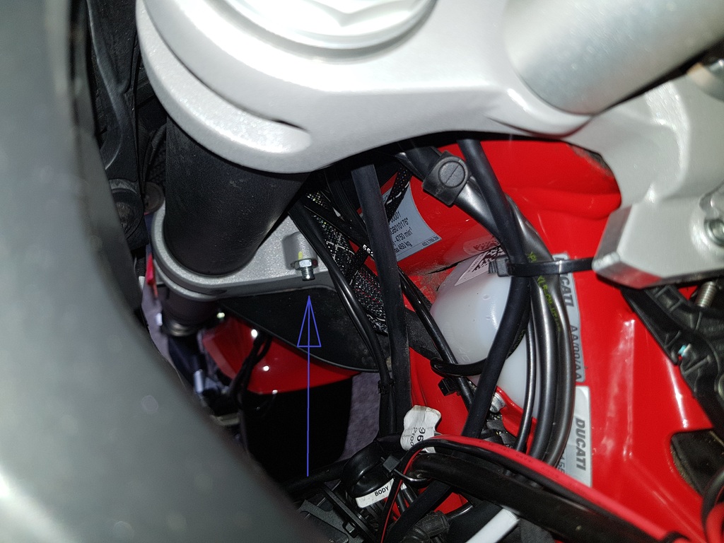

  1. So last night after reading about all the steering lock issues people seem to be having with their Multeys I thought it might be prudent to test mine.
    Went through the process to engage lock and it starts making noises and then goes click and then a louder click and then nothing. Thought "that's not locked to me" and sure enough I can move the handlebars. Tried a few more times in both directions but nutta. So now I'm thinking "crap" I need to take the bike to the dealer to get it sorted under warranty.
    Went out to the garage this afternoon and after a bit of investigation I realised there was no way it was going to work as the steering doesn't go far enough left or right to allow the lock pin to extend out. That's when I noticed that you can actually adjust the steering lock stop, never seen this before on a bike but a quick adjustment and hey presto it all works now. Phew :)

  2. Hey Wiseric, would you mind posting instructions on how to adjust it please. My steering lock works but I think my handlebars go too far. They go all the way to the tank which seems like it's the only thing stopping them from going even further. Thanks

  4. Not much to it really, I've taken a picture from the top on the left hand side as the right hand side is not visible from the top. Both sides can be easily accessed from the bottom and you just need a No.13 socket and alan key. Loosen off the nut and use the alan key to adjust (in your case Anthony outwards) in the desired direction. [​IMG][/URL][/IMG] [​IMG][/URL][/IMG] [​IMG]

  6. Awesome thank you very much for the info and pic. I'll check mine out tonight.
