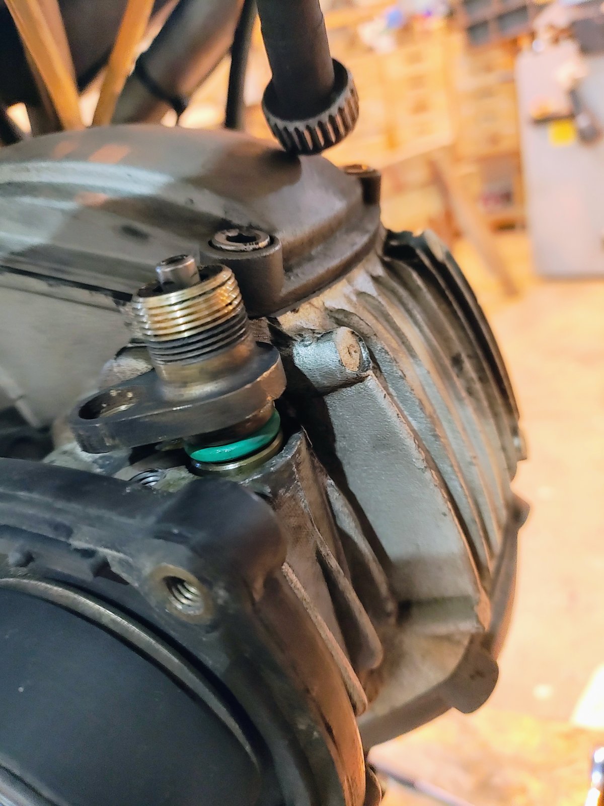

  1. My rev counter works intermittently and I think I've narrowed the fault down to the drive from the cylinder head. To get the shaft out to look at the helical gear I need to pull this brass fitting away
    from the head but it's in there pretty tight.
    Screenshot 2026-07-17 at 20-43-37 066092150_k.jpg (JPEG Image 210 × 159 pixels).jpg
    Has anyone got any tips on getting it out?
    TIA
  2. Think you have to press the shaft out by using pressure on it from the unthreaded end.
