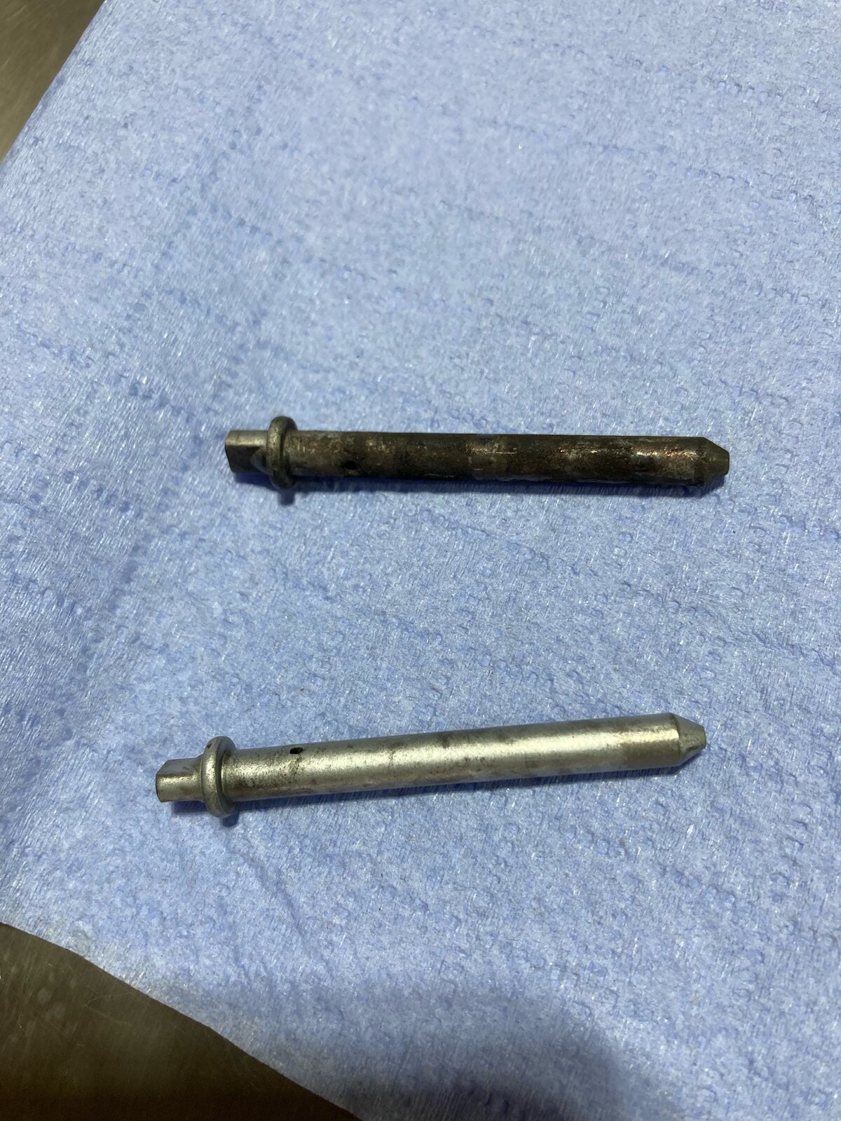

  1. Is the top flat?like a rivet.
    Then it looks like the rivets that hold the plaques in place on the top yoke.
    So the numbered plaques like on a SP or SPS,R,...
    Henk!!!

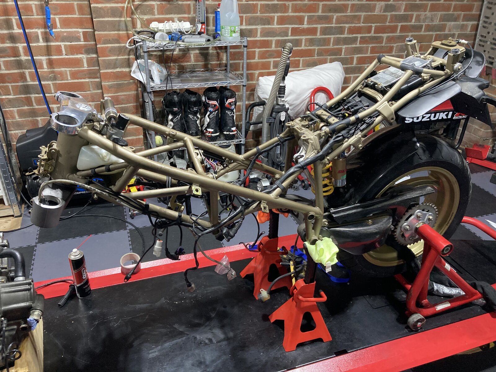

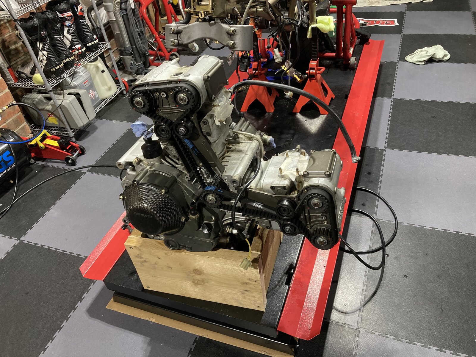

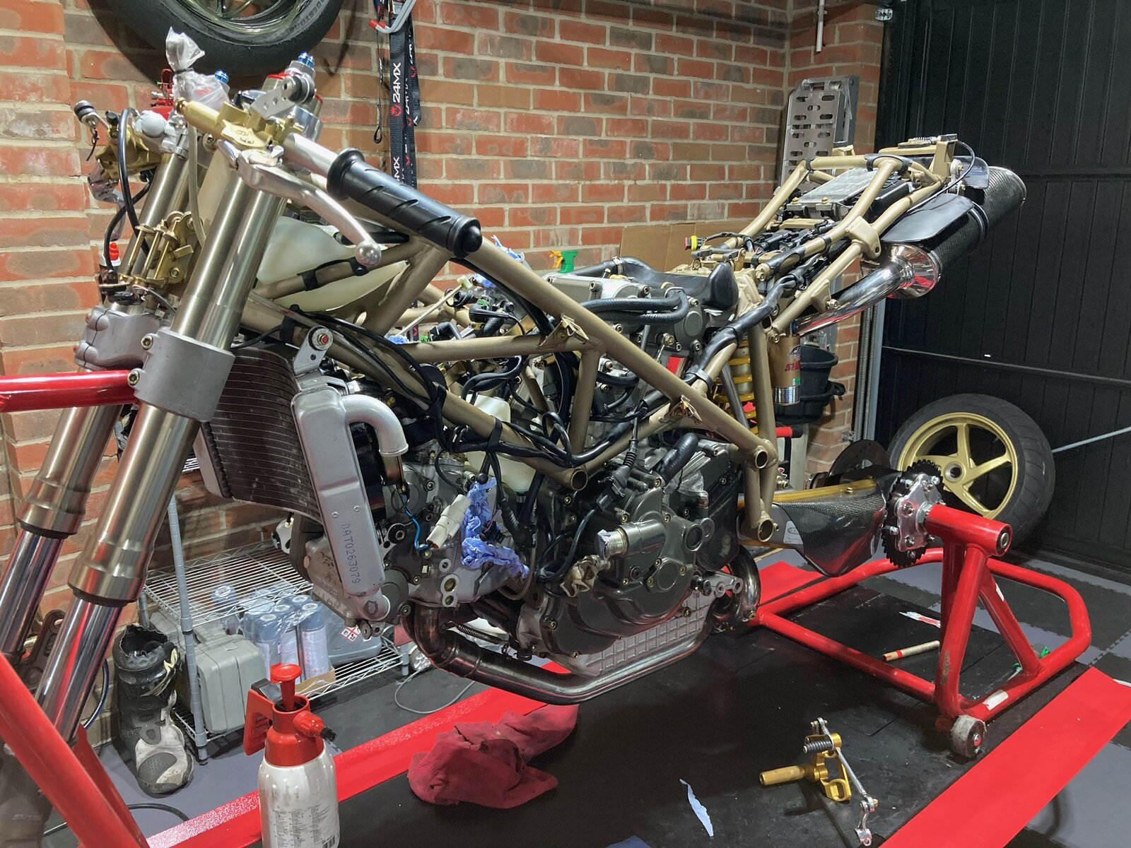

    slight change of plan as I have now dropped the engine out….forks out.
    only the rear wheel and shock are connected. The great news is that the swingarm bolt came out no bother whatsoever.
    made an engine stand from some scrap wood too…
  3. Thanks Smithy….
    That sounds spot on to me. It matches colour and fits in the hole
  4. if it’s a one part I can’t say but all race bikes need lock wire to hold whatever in place for safety or sometimes just so the homo’s justify the job they do!!!
    .....”homos”.....the guys that set the rules and check the bikes!!!!! Just to clarify!!!
  5. “Ome”
  6. Oh! And it also makes sense that they use a rivet to protect the wire, those parts would make short work of lock wire with direct vibration from moving parts!

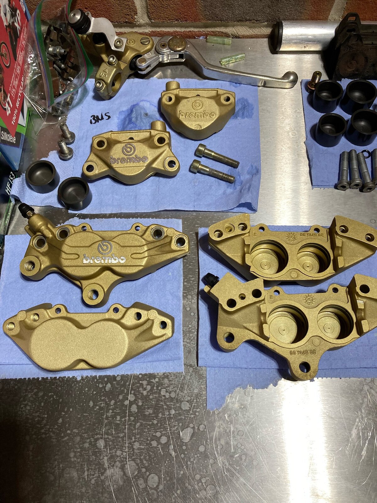

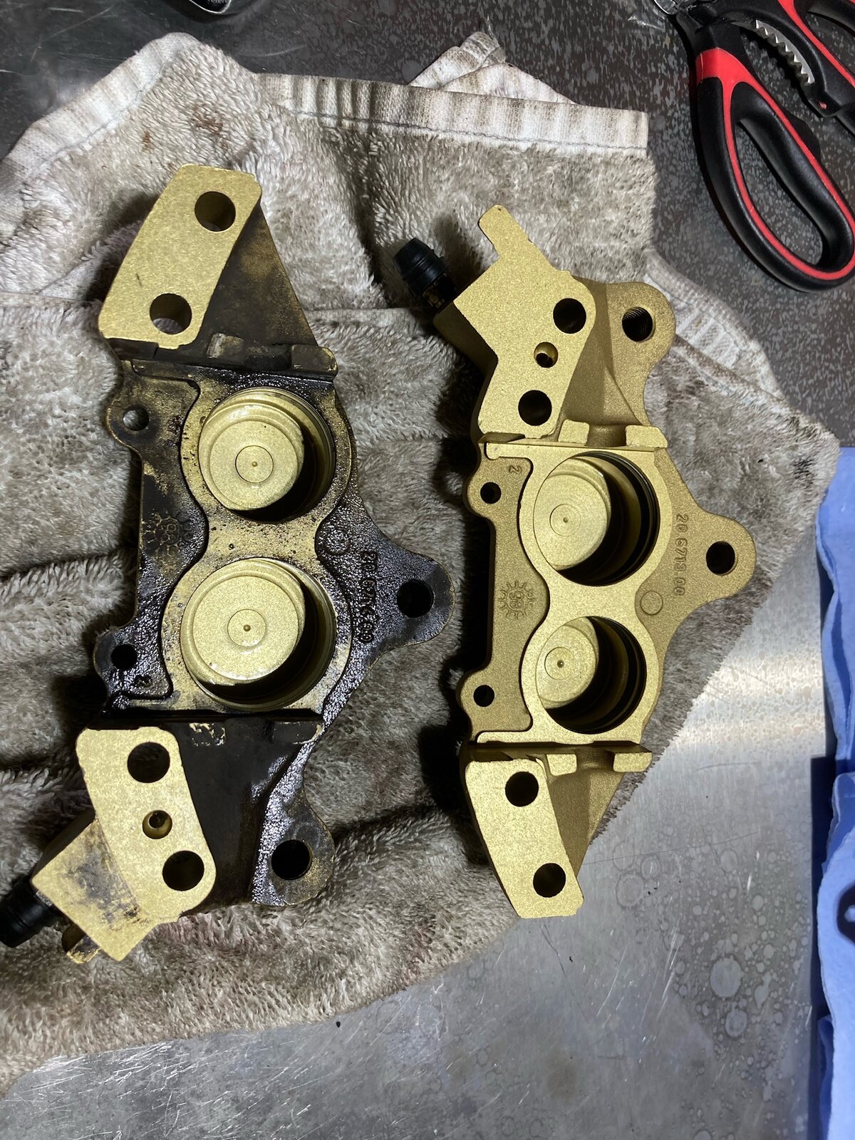

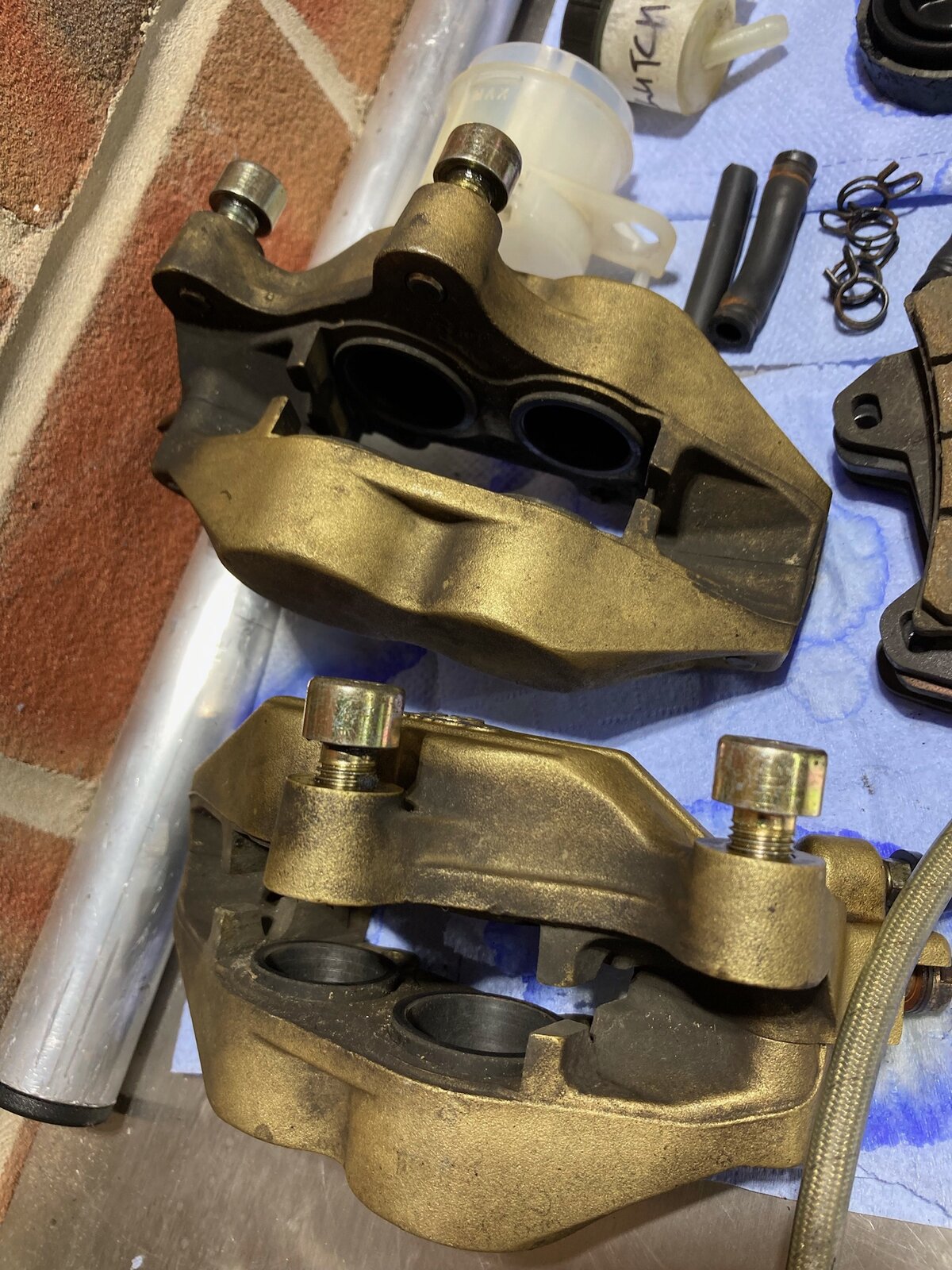

  7. DBDF973E-C3E9-48AF-B491-304732AC55C5.jpeg 85D17431-9E4B-4A66-A5C9-A2B8C12E3753.jpeg A4AC337A-0D03-4479-B6CD-E484F4BF0AA8.jpeg 0BF55F4C-356D-4104-AFFD-B68B050C4067.jpeg
    Some caliper cleaning and stripping….just waiting on new seals to arrive. Pistons were nice and clean

  8. Slow progress really with holidays and some personal stuff….
    Lots of cleaning plus, suspension at FTR for a service, bodywork painting started, headstock stripped, calipers back together.
    waiting for a few bits and then it will be putting it all back together

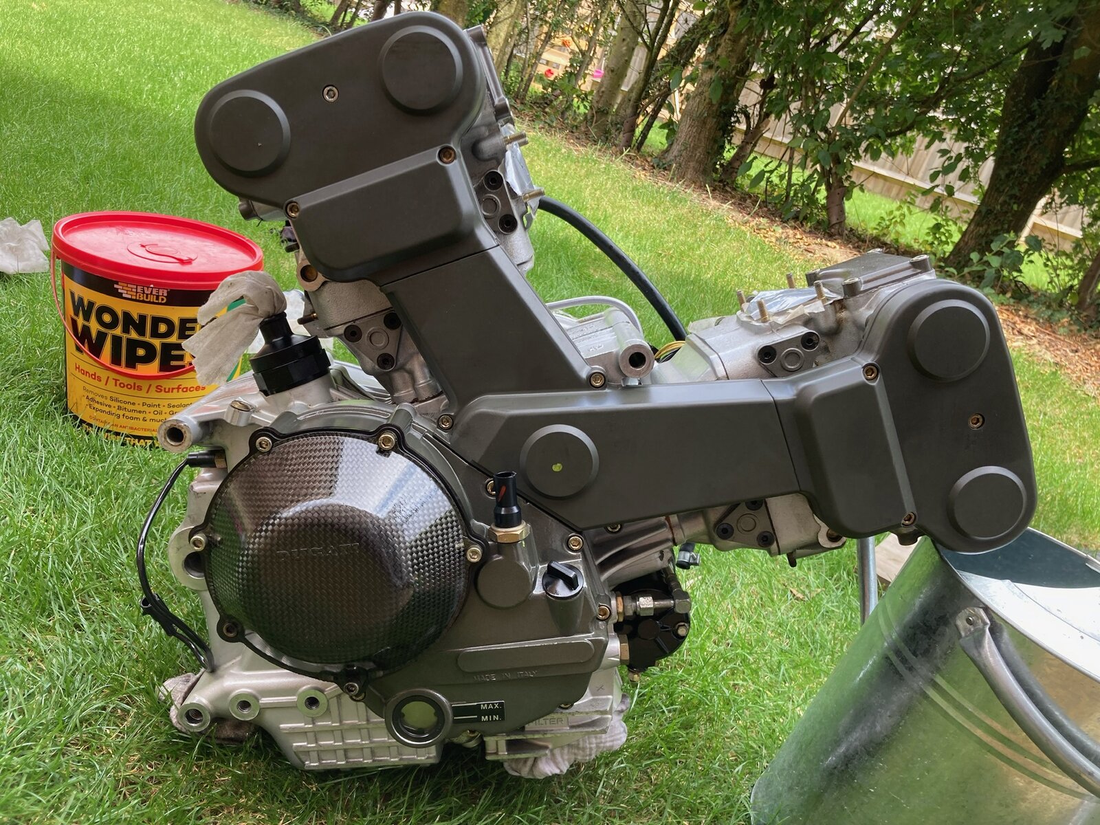

  11. 1263221C-D773-4DAF-8079-FFAFE9514DB5.jpeg CC851877-B748-4799-97AF-6A1D2359CEFA.jpeg
    Valve clearances all done, clutch seal done, belts done….engine cleaned and ready to go back into frame

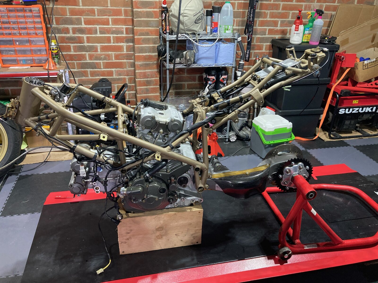

    Engine loose fitted with swingarm…
    Headstock bearings tomorrow and then steering stem in before new plugs, oil filter and oil…..

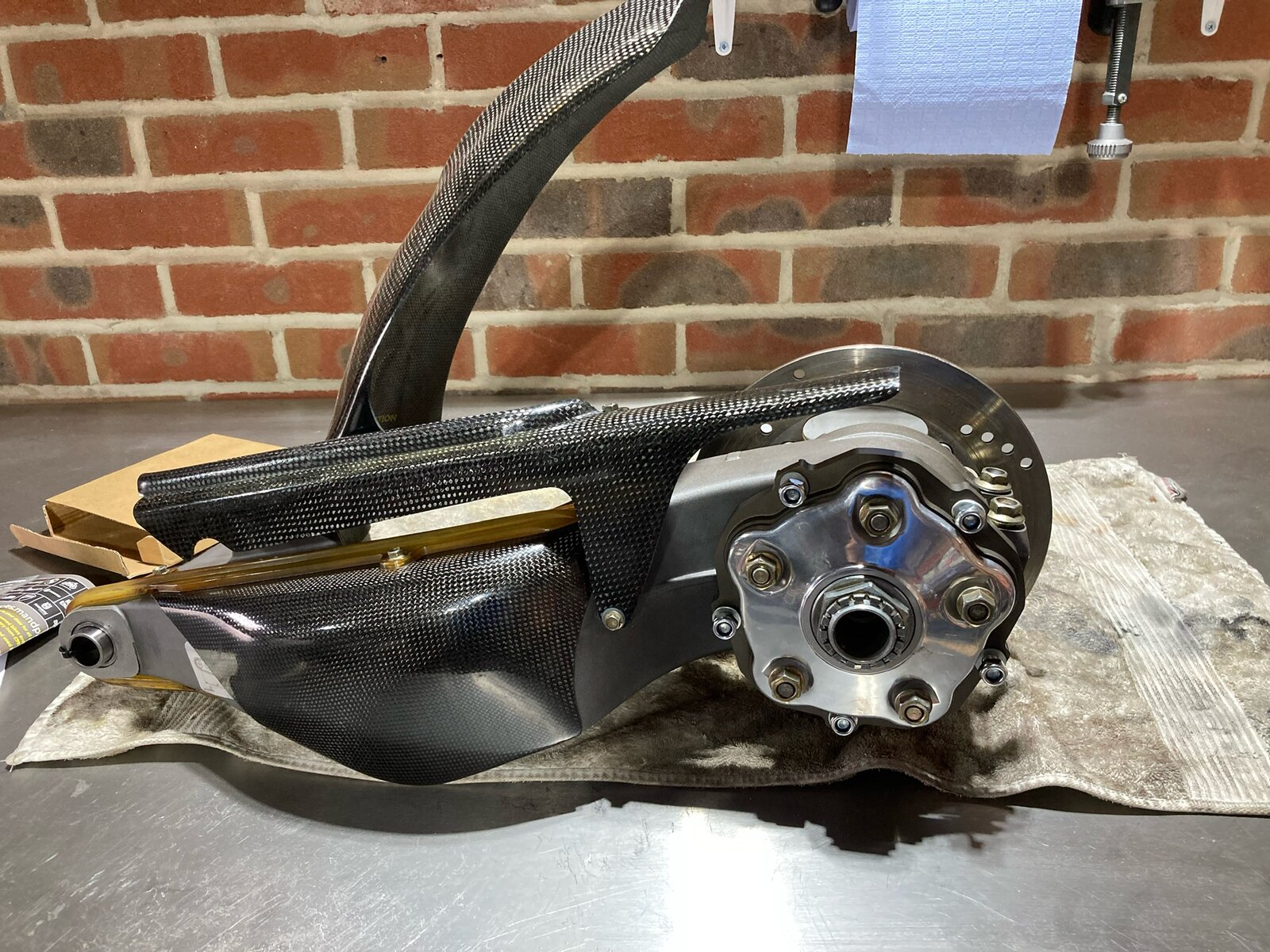

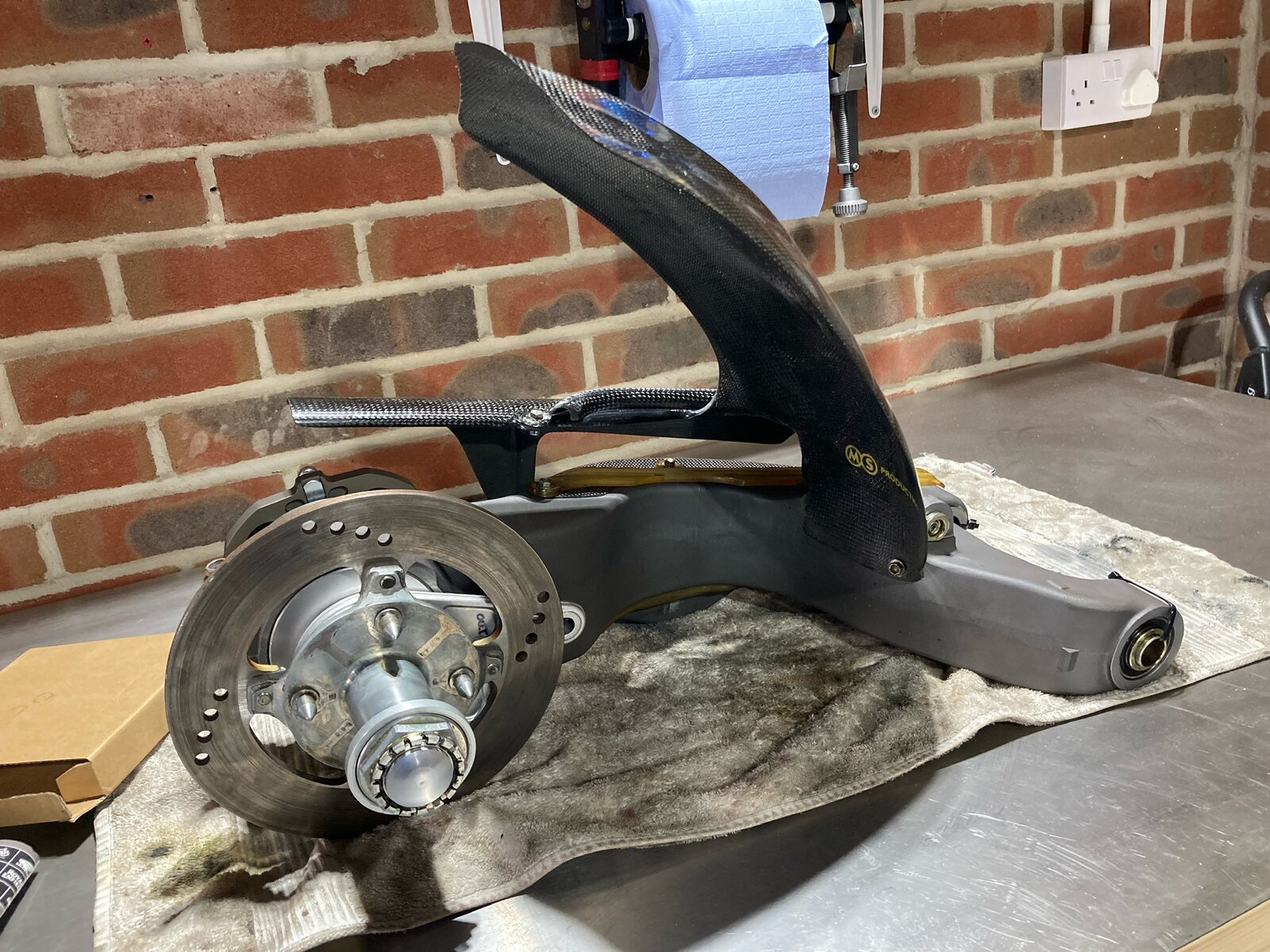

  13. Swingarm sorted…cleaned and regressed.
    JT carrier, few titanium nuts and bolts….loving that I am putting stuff back together
    big shout to Glen at Moto V near Colchester. Got him to look over the engine just in case and all good

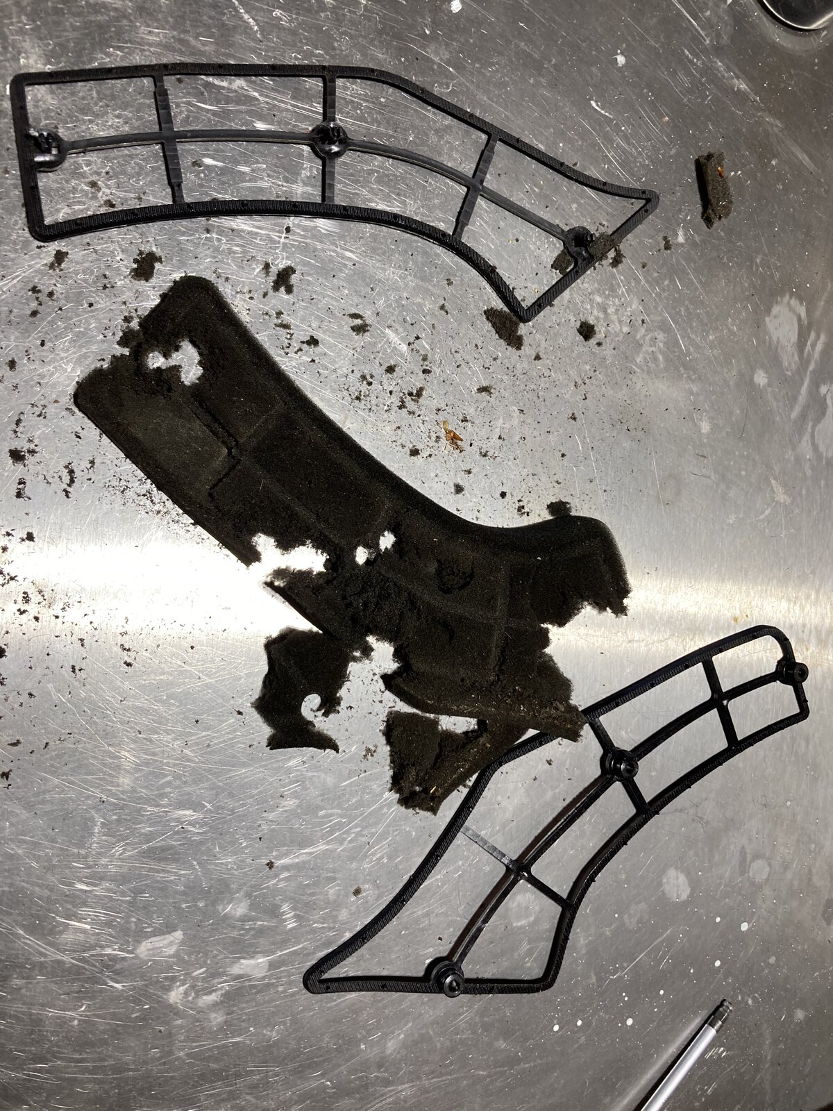

  18. I think the air filters are just about ready for changing
  19. still good for a couple of hundred miles i reckon?
