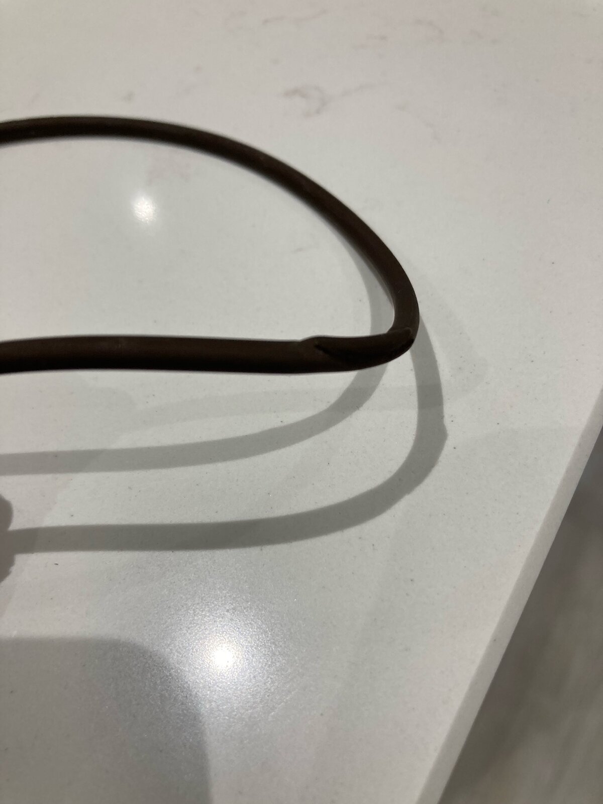

  4. Got a bloody fuel leak….I reckon it must be from the main seal that I changed….
    Ball ache but nothing major really….most important thing is to get it to be a rolling chassis so it can be moved.
  5. Yep, pinched the seal….new one should be here tomorrow.

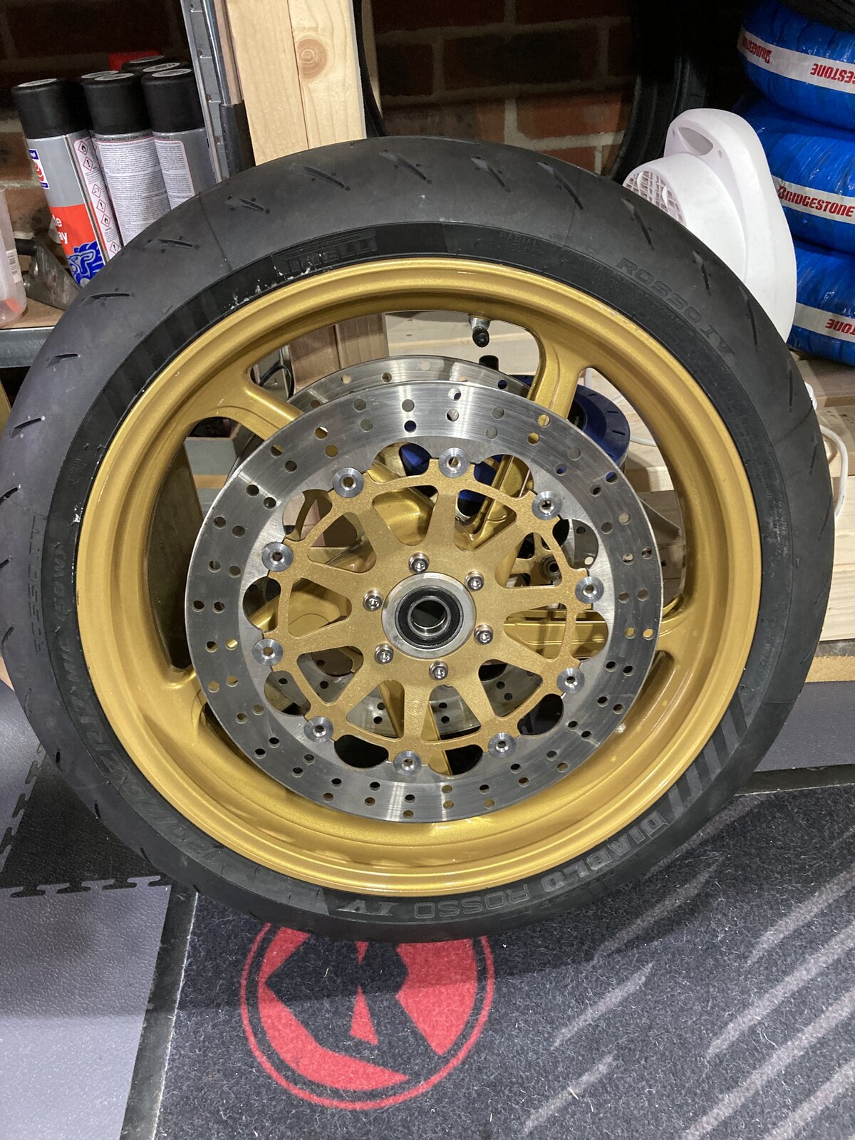

    had a cock up on the front wheel….must have been some blast media in the thread and it locked a bolt solid and snapped and I made a hash of using the easy out. Grrrrrrrr.
    Wheel is at FD motorcycles to get sorted. Andy there can sort most stuff.

  6. There's a knack to those seals, it's been a long time since I've done one but I recall putting a sliver of grease on the seal then the 3 bolts you slowly try and wind them down to keep the pump level, there's usually a bit of pushing on the seal to get it to seat properly.
  7. Should be fine next time….thank for the tip
    Well I bloody hope so anyway

  10. Fuel leak fixed
    Wheel fixed - Big Shout to FD motorcycles. They do amazing stuff

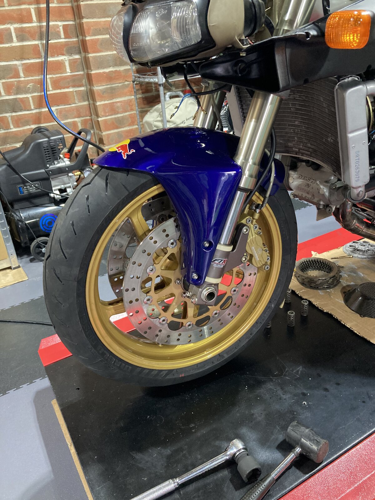

  11. 0D44EC63-3080-4155-A620-A5040429C454.jpeg 0D44EC63-3080-4155-A620-A5040429C454.jpeg W
  12. No!!!! I'm perfectly happy with my grey standard ones. Really, I am...........
    (That looks great.)
  13. As an aside my nearest and dearest dragged/took me to the Royal Academy Summer show in London yesterday. I spent more time looking at the workmanship/craftsmanship on that wheel than on most of the 'art' on display yesterday.
  14. Glad to be of service
  15. Blue? Blue??
    Ducati are Red.
    Possibly yellow, possibly black.
    But blue?
  16. Yes blue……A Marcol Moto official Reve Racing Red Bull replica.
    one of 20 and (I believe) the only 748, the rest being 996’s. Got the cert of authenticity and even the t-shirt that came with it.
