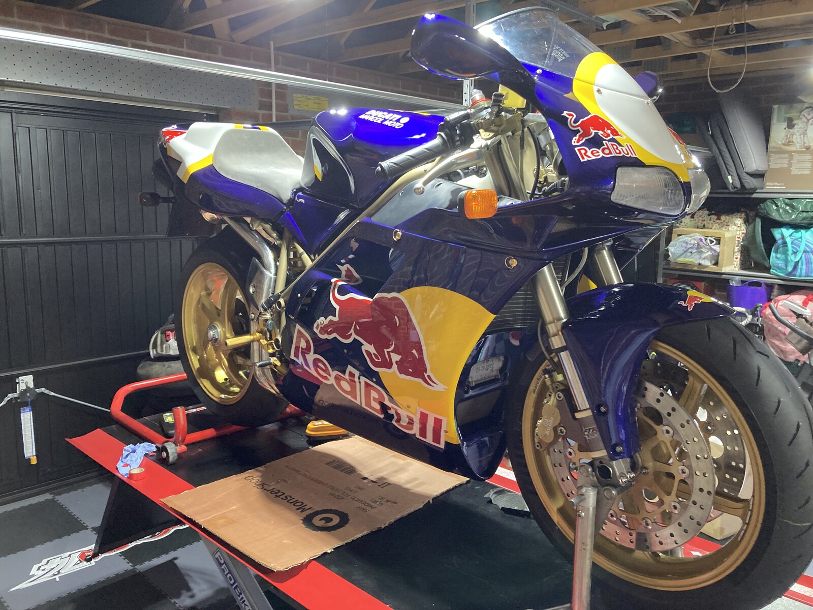

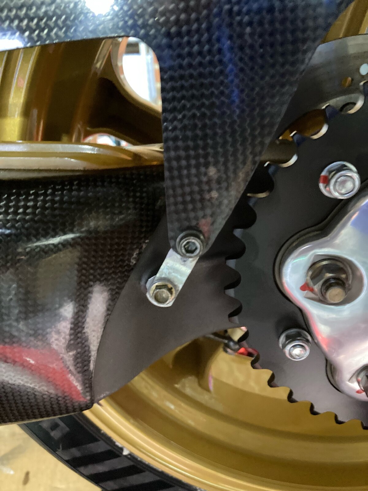

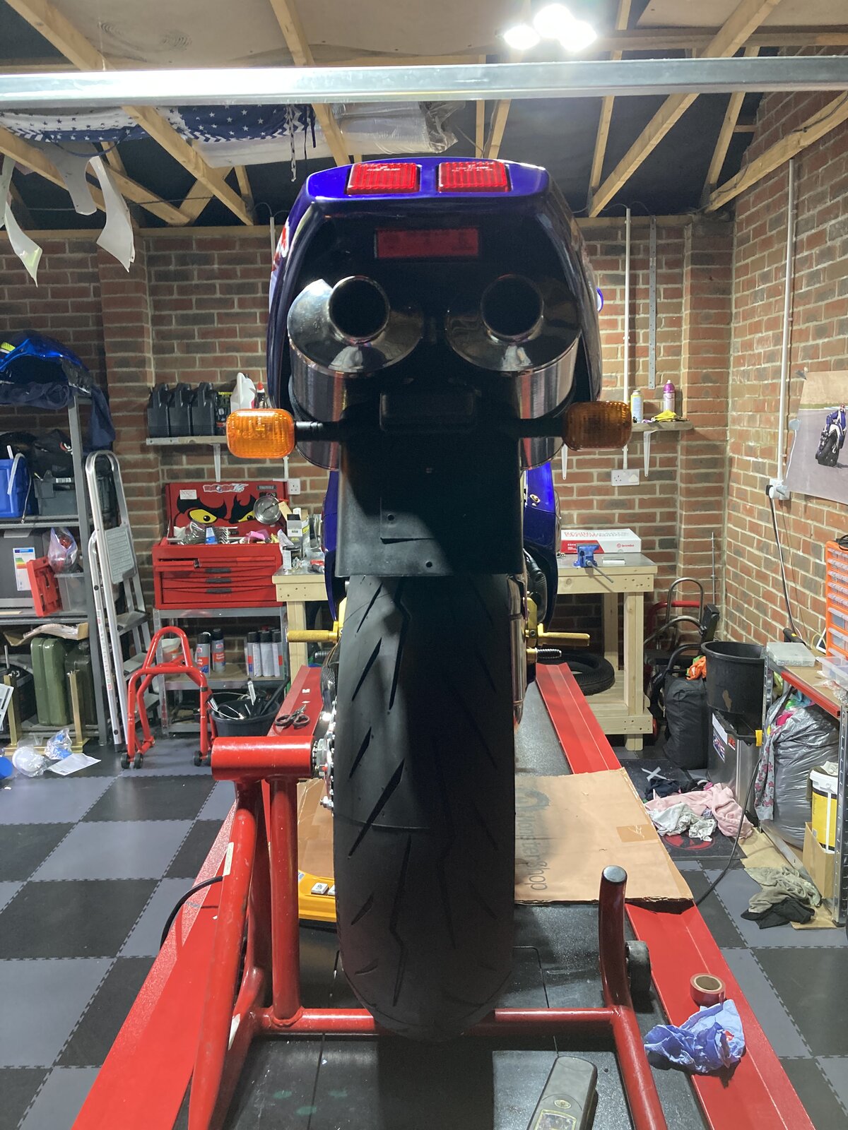

    Flumuxed by the rear hugger……rubbed to buggery so I made a little bracket. Looks pants but does the job…anyone got any tips on why?
    Also cleaned up the clutch basket and bleed it up…all works fine and dandy if a touch heavy.
    Just the brake bleeding, fit chain, connect front and rear indicators then the body work.
    Then it will be going away for the winter before a spring MOT.

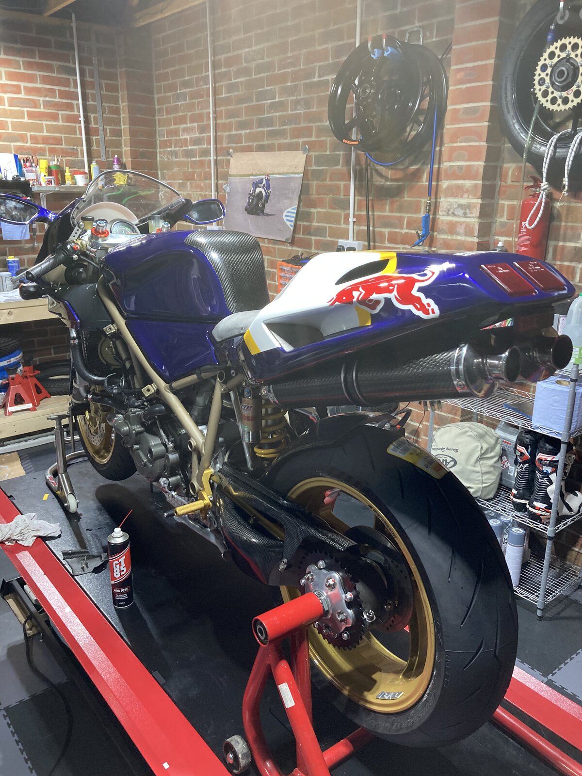

  2. 54B39727-5BA9-45CA-B406-D0C71F416FCB.jpeg 2EBAA65F-C3F6-4A0C-9C8D-230CEFF8F2FC.jpeg 08D645C4-DD8B-4E2B-8CD9-BE0F9BBB4F80.jpeg

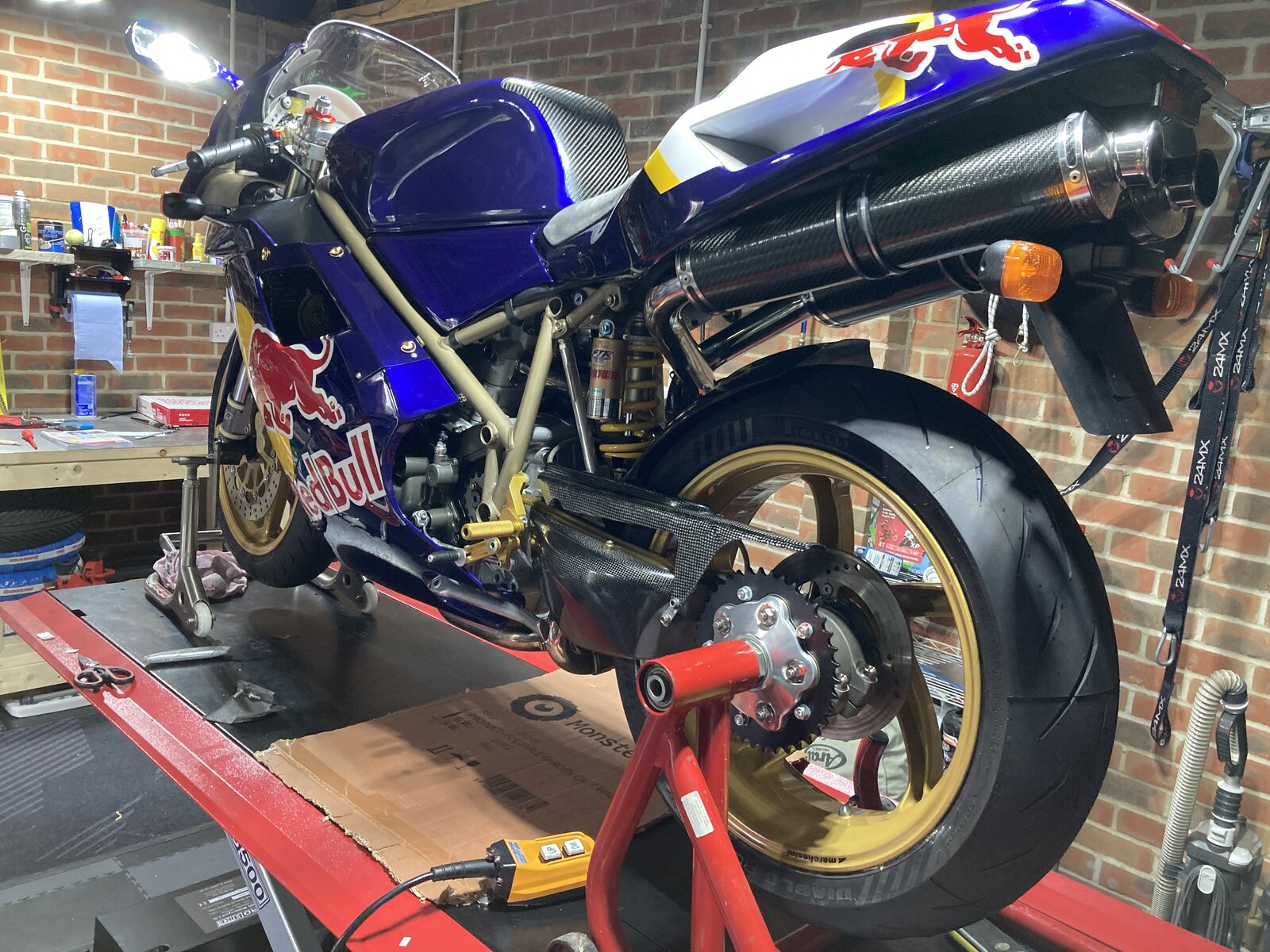

  3. Bled the brakes…..the rear was a total ball ache. ‍♂️
    fitted the top fairing and indicators. Switch was a bit sticky so a bit of GT85 sorted that.
    Just the lower fairings, rear numberplate and lights and chain to go

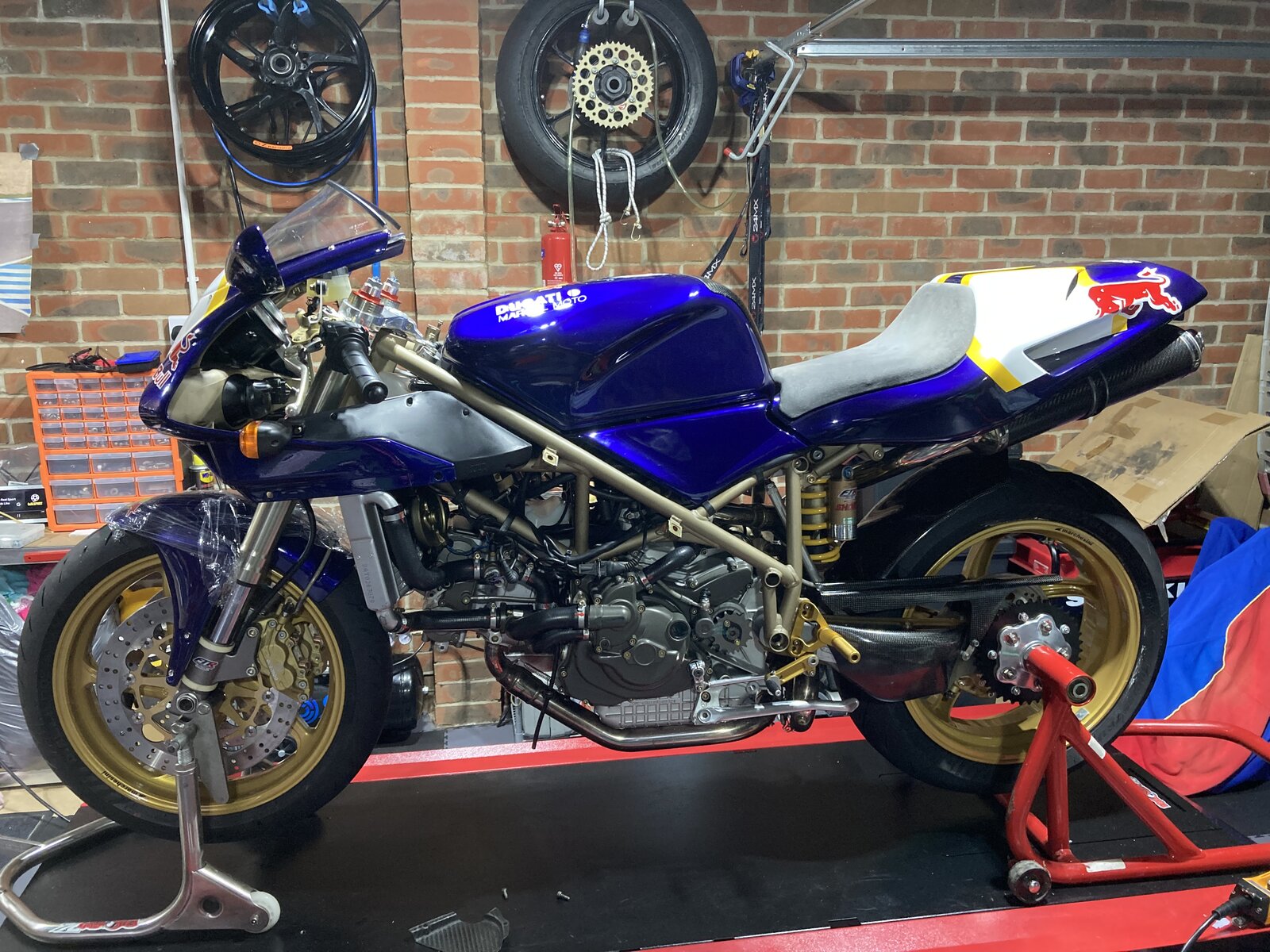

  4. Near as damn it finished

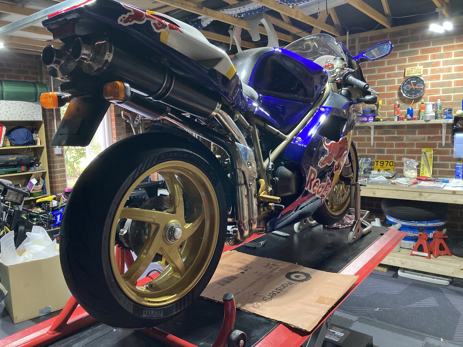

  8. Rode it up and down the street today….
    It worked….suspension needs to be set up, sort the rubbing hugger, MOT, tax and insurance…
    bought a key barrel guard thingy for it in lovely carbon fibre too….small problem in that it covers part of the Red Bull logo on the tank ‍♂️
  9. Had a fettle with the rear hugger after one internet searching…
    Despite me putting the eccentric adjuster back exactly where I took it out I must have adjusted the chain wrong….few spanners later and it is much better but not perfect.
    I think I will have a proper look over the winter and sort it now I know what the problem is (I hope)
