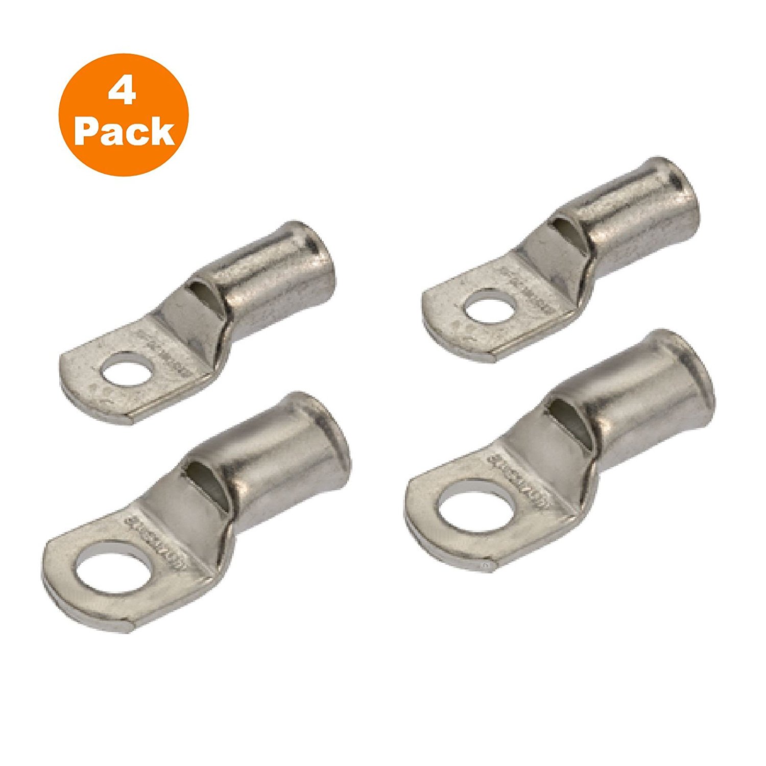

  2. yeah I, I have enough room to fit a new one, was just hoping to find something the same shape as the orignal as the exact-start cables are designated to fit inside it, I guess i'll have to go with something like this...
  3. The exact start cables will now be taking the main load. Both the exact start and oem connectors need to be hefty because of the current draw through them. There is nood at all for these small wires to have anything more than the ring connectors pictured here.
    The exact start connector is designed to go under the oem connector precisely because of the other small wires crimped into it, making it simplest to just piggyback to it.
    Now your oem connector is buggered and you need to connect the small wires separately anyway, the desirability of piggybacking has disappeared and using a ring connector on top of the exact start is now the best option

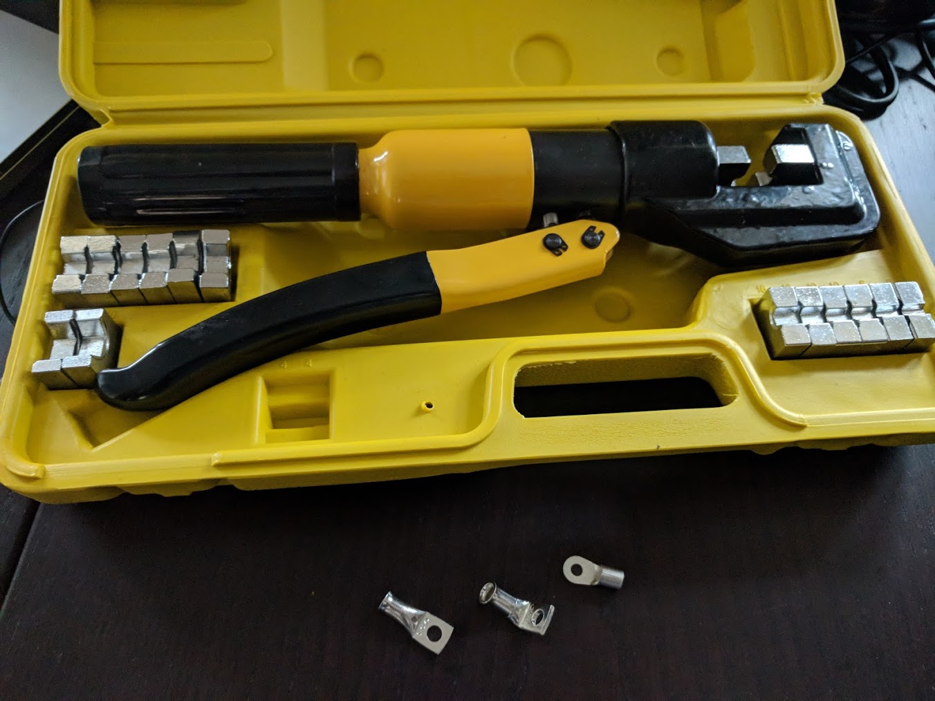

  4. Well the connectors I ordered from www.cablecraft.co.uk (thanks for the pointer) and crimp tool have arrived so i'm going over to the bike to try and fit, will report back...
