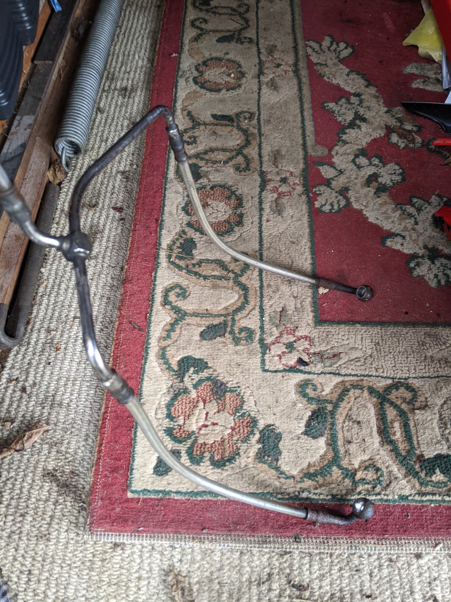

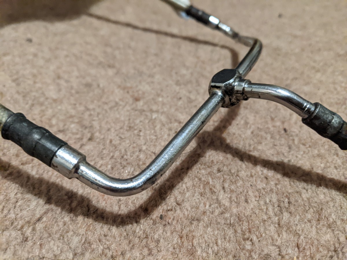

  1. The photo below shows the front brake lines off the Raptor. There is a single flexible from the master cylinder joined to a rigid large 'T piece' that has each end P clipped to the rear of the bottom yoke with a flexible to their respective calipers.

    I was trying to replicate the original solution's routing using flexibles but the shortest length they do is 10 cm plus there would be too many connectors for my liking. So does anyone know who might be able replicate the original set up using both rigid & flexible lines.
  2. try goodrich or earls, goodrich will probably do a hard line solution bespoke.
    Failing that you could try Pirtek if there's one local to you, or alternatively a fabricator.
    Are the flex lines swaged directly to the hardline or do they screw in?
    Pirtek and earls will happily make new flex lines and re-swage onto the existing hardpoints.
    that hardline just needs a good go with a dremel or some scotchbrite and then get it re-zinced if it's not stainless steel.
  3. They're certainly not screw in so must assume they are swaged/crimped - my confusion because the caliper & master cylinder line connections look different.

  9. Andy, hel will do a custom line to your specs, but personally I would refresh what you have.
    that hardline is a nice thing and I’d just replace the flex lines, or at the most have some threaded portions brazed on there so you can replace them easily in future.
    I didn’t ask, why do you want to replace the lines?
    is it just the surface finish on the metalwork?

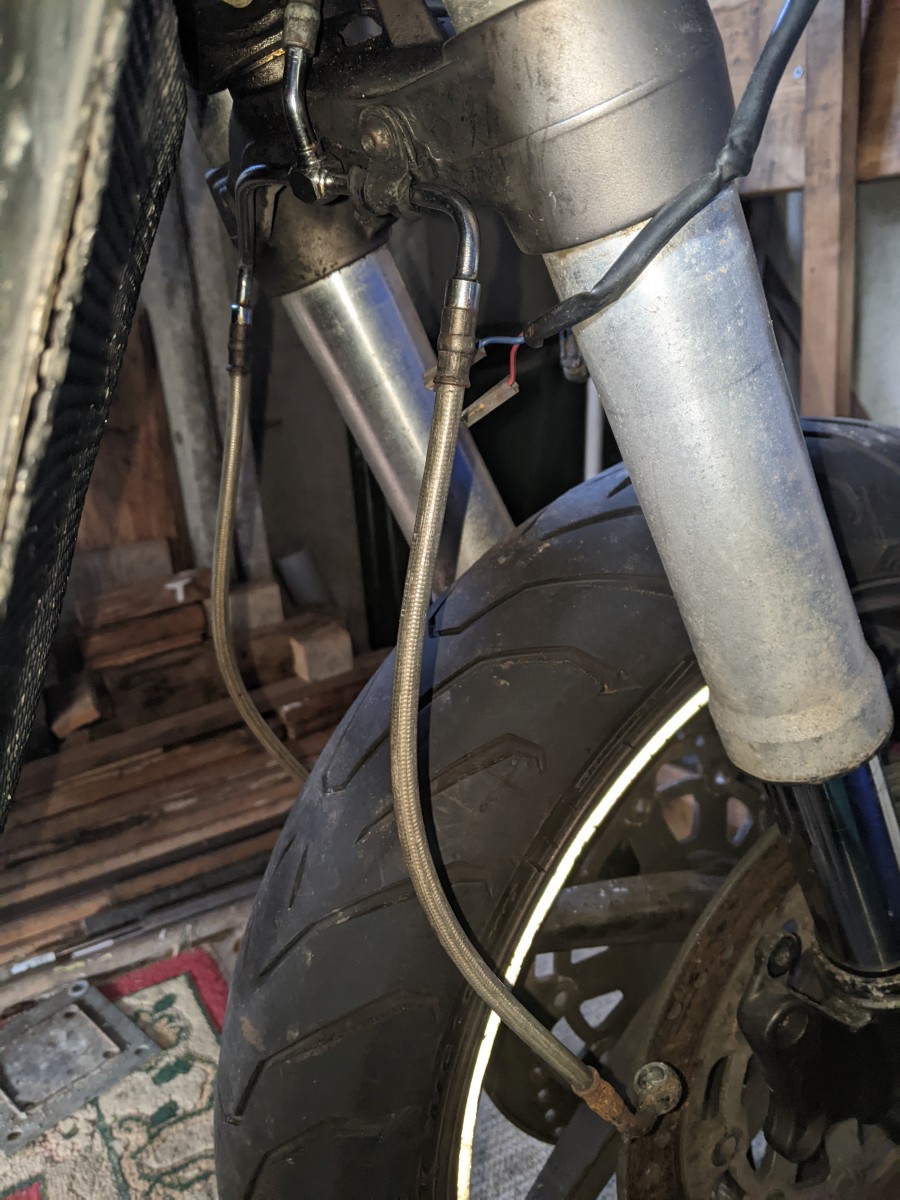

  10. As can be seen in the last photo the banjos/crimps on the caliper end (plus the master cylinder end) are quite badly rusted and as it is the lines themselves could do with a little extra length say 10/15 mm.
    I'm quite happy with the hardline finish and as you say it's a neat tidy fitment. I like the idea of brazing.

  12. Andy, any decent hydraulics place will be able to re swage new lines on to your existing fitting and to your specification, so you have plenty of options. :)
  13. That's good news... I'm in no great rush so can take me time sourcing a local firm.
