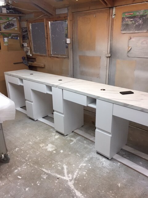

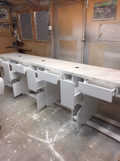

  3. River table is on hold until he gets a bit of time between jobs, but you can get your nails done, there must be more nail bar shops then pubs.
