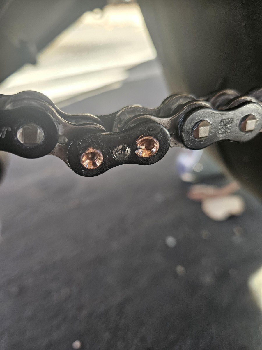

    I'm well aware of the correct method of assembling chain links but as the photo below, and Sev alluded to above, shows some may not. An instance which may not be in anyway safer.
    • WTF WTF x 1
  7. I haven't ever had a problem with either method of joining a chain, either can be bad if the installation is badly executed.
    Sometimes I believe magazines are just looking to fill column inches with guff.
  8. That's a 'Soft Link', they should be banned!
  9. I don’t mind a soft link if done properly but that one pictured has been mullered. I use split links on low powered bikes but rivet links on everything else. As others have said if either hasn’t been done properly then it’s not going to end well.
  10. Some people (the ones that use easy outs after they already fucked up) should not be allowed anywhere near mechanical things and if they are they should be forced to wear boxing gloves...
  11. Spending a bit extra on a reputable splitter/rivetting tool pays dividends ultimately. Saying that, the operator is always the "weakest link" (no pun intended). Used properly they will ensure the chain is safe and secure and most manuafacturers even provide a table so you can check the dimensions of the flared pins, to verify you have done the job properly. Obviously if it's been buggered it up (as in the earlier photo), whoever deemed that acceptable, needs to step away from the bike and let someone competent do the job instead.

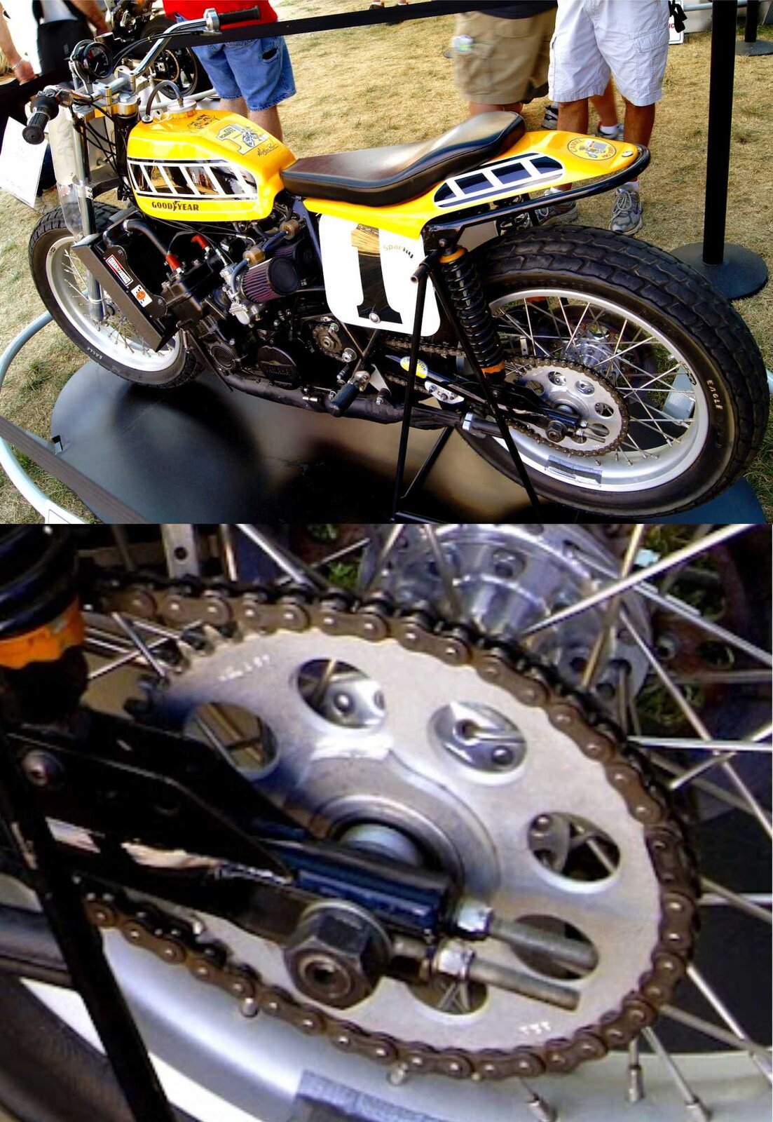

  17. Whilst cruising around other rivet/split link threads on 't web I came across this:
  18. I guess like that to facilate easy chain sprocket changes. Didn’t Robert’s say they couldn’t pay him enough money to race that. Bike was banned in the end wasn’t as it was kicking HD ass.
  19. Yeah, I gathered from some of the other threads quite a few motocrossers use split links as a matter of course because, exactly as you say, it makes sprocket/wheel changes so much easier.
    I believe so - this may have been posted here before but hey ho it's worth a second look. Action & predictable whooping & hollering starts at around 3:30.
  20. Period correct, when we raced TZ Yams and RG Suzukis they all had split links. My mates TZ750 was producing around 120 bhp and was probably the pinnacle of 2 stroke race engines. It always ran a split link as did my other mates RG500 and my TZ350, none of us ever had problems and back in those days of shoestring budgets a chain would easily go for a couple of seasons or more.
