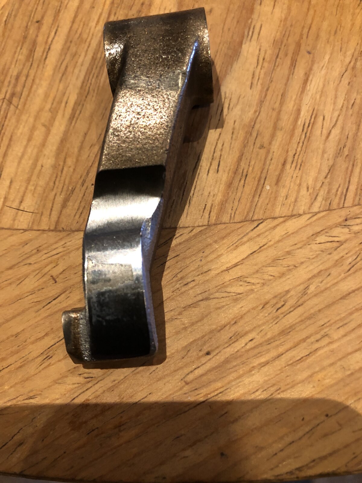

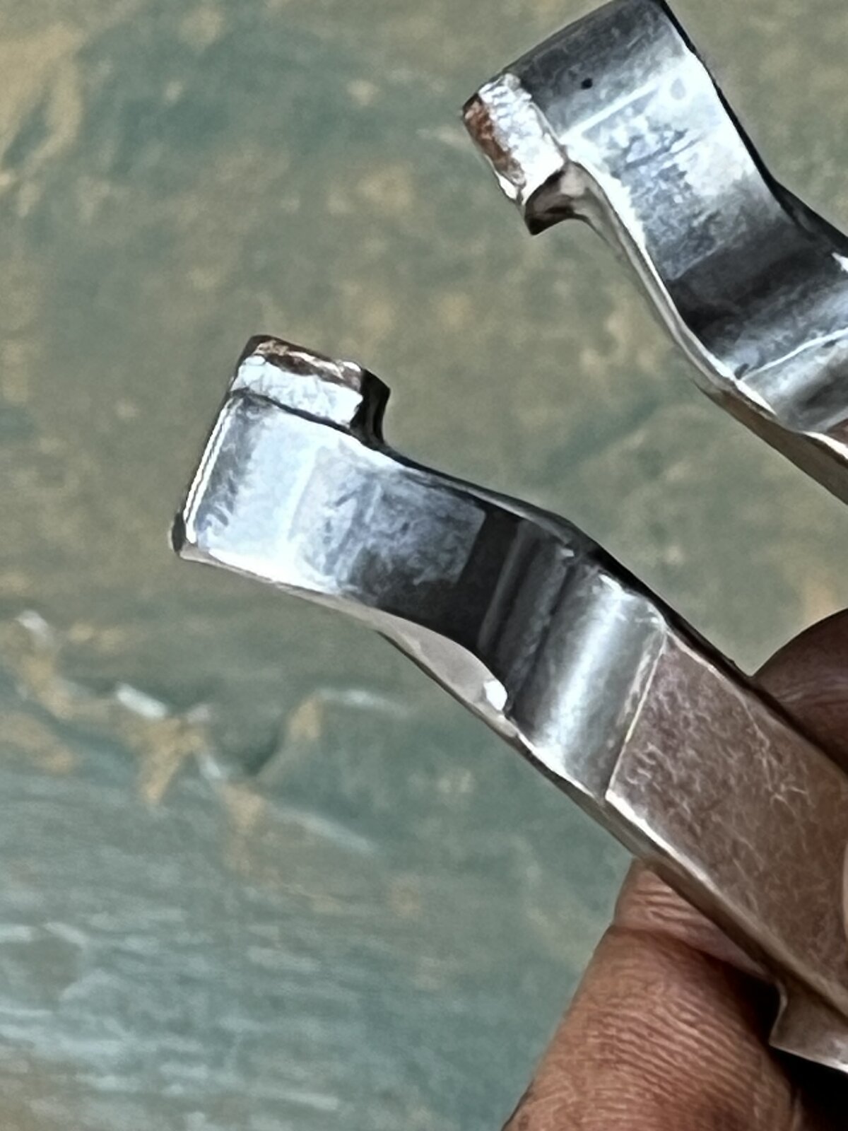

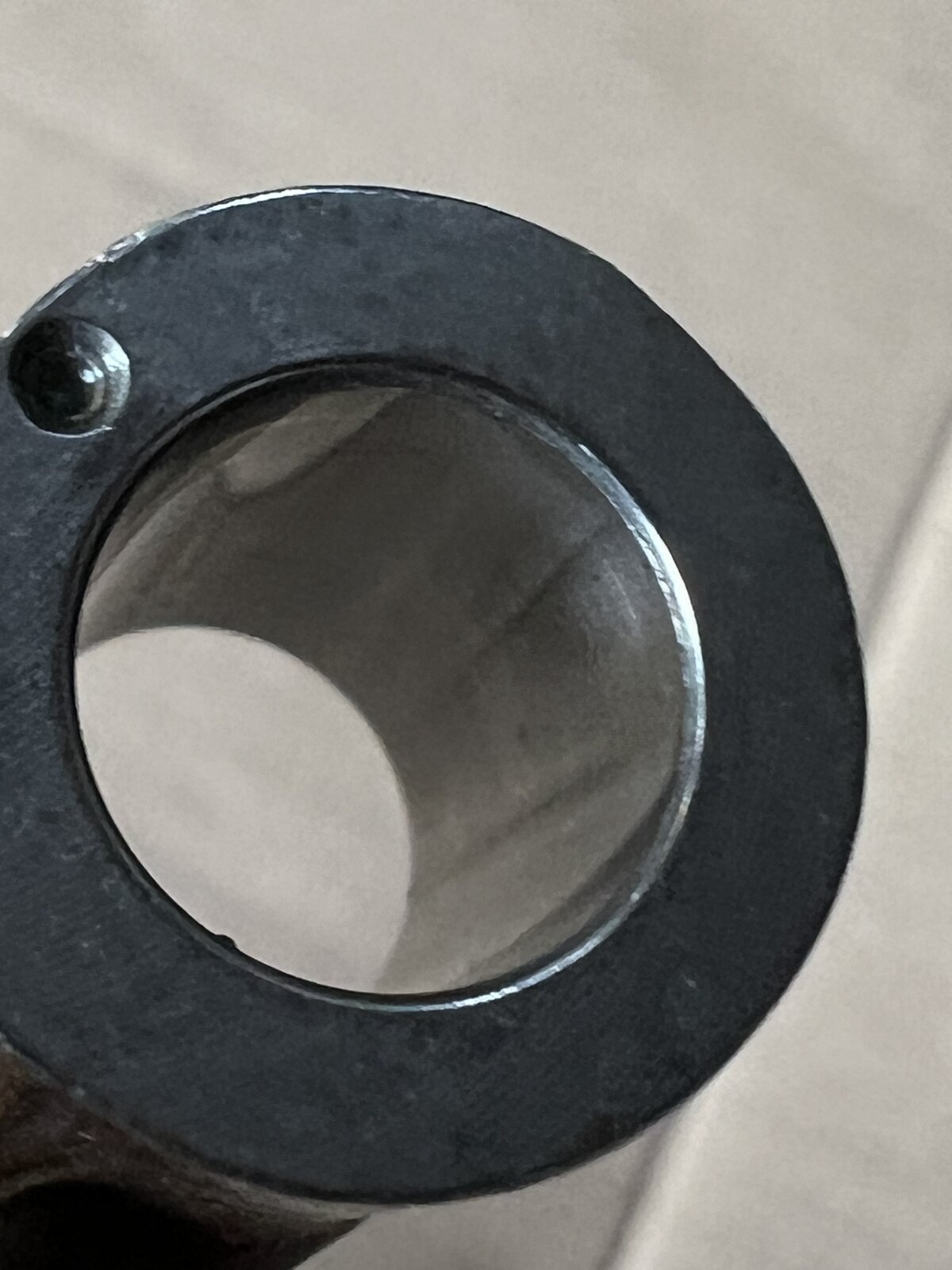

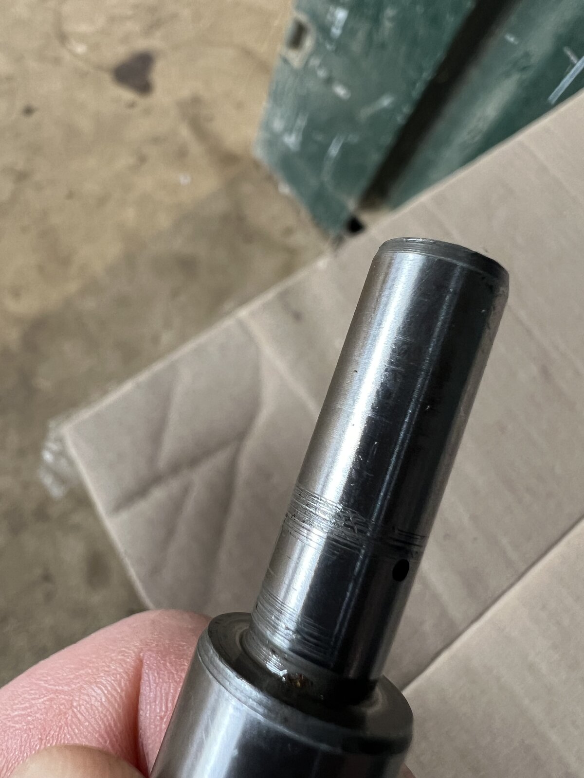

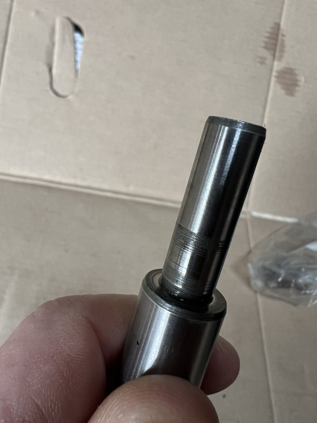

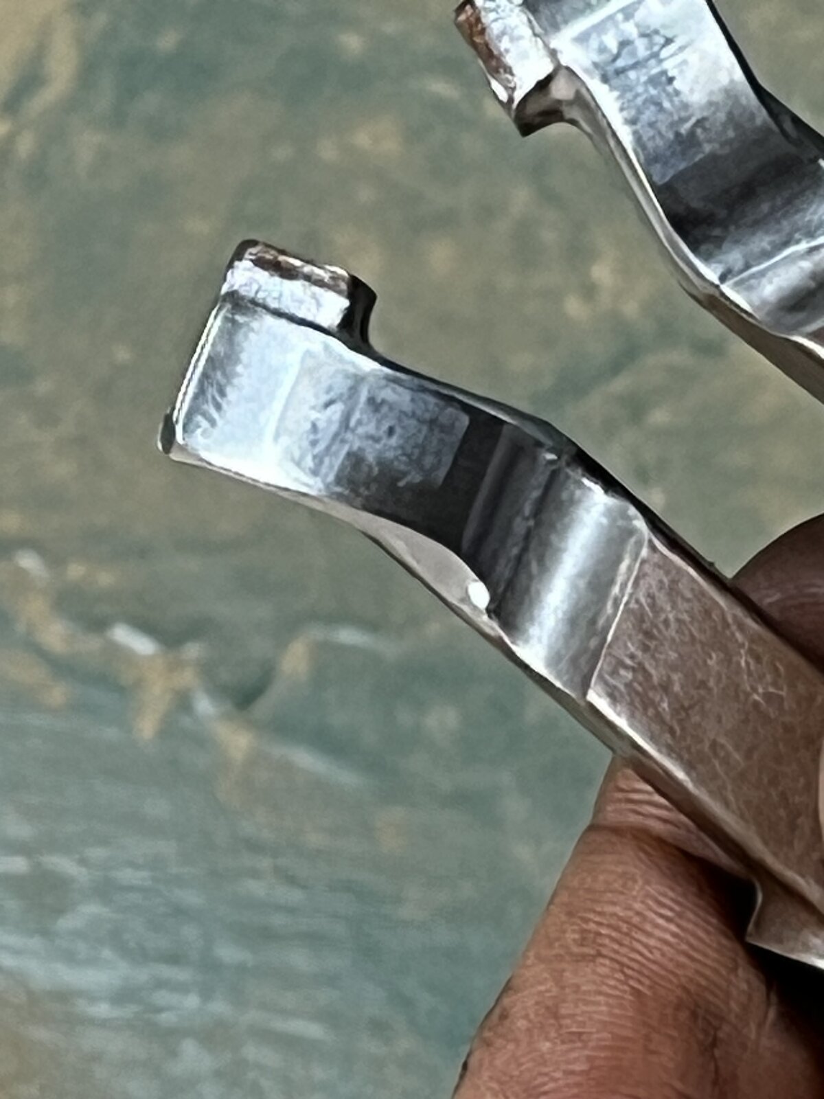

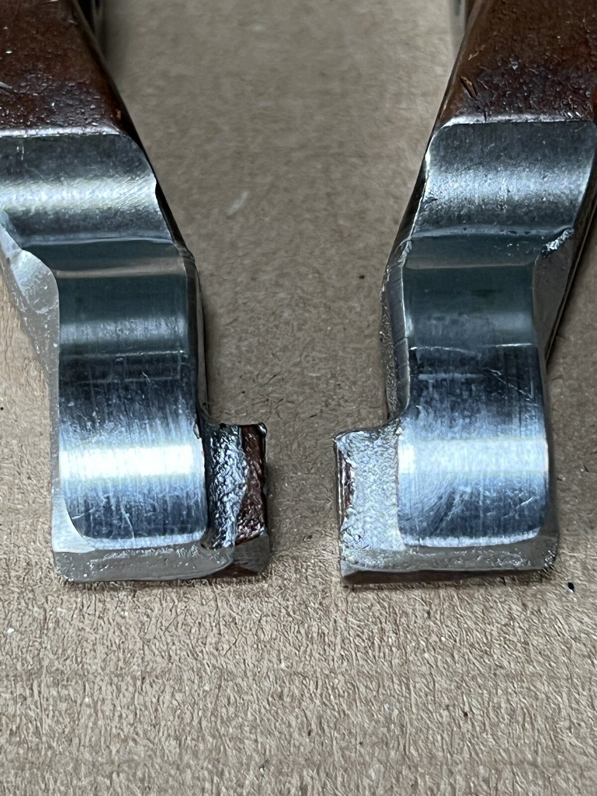

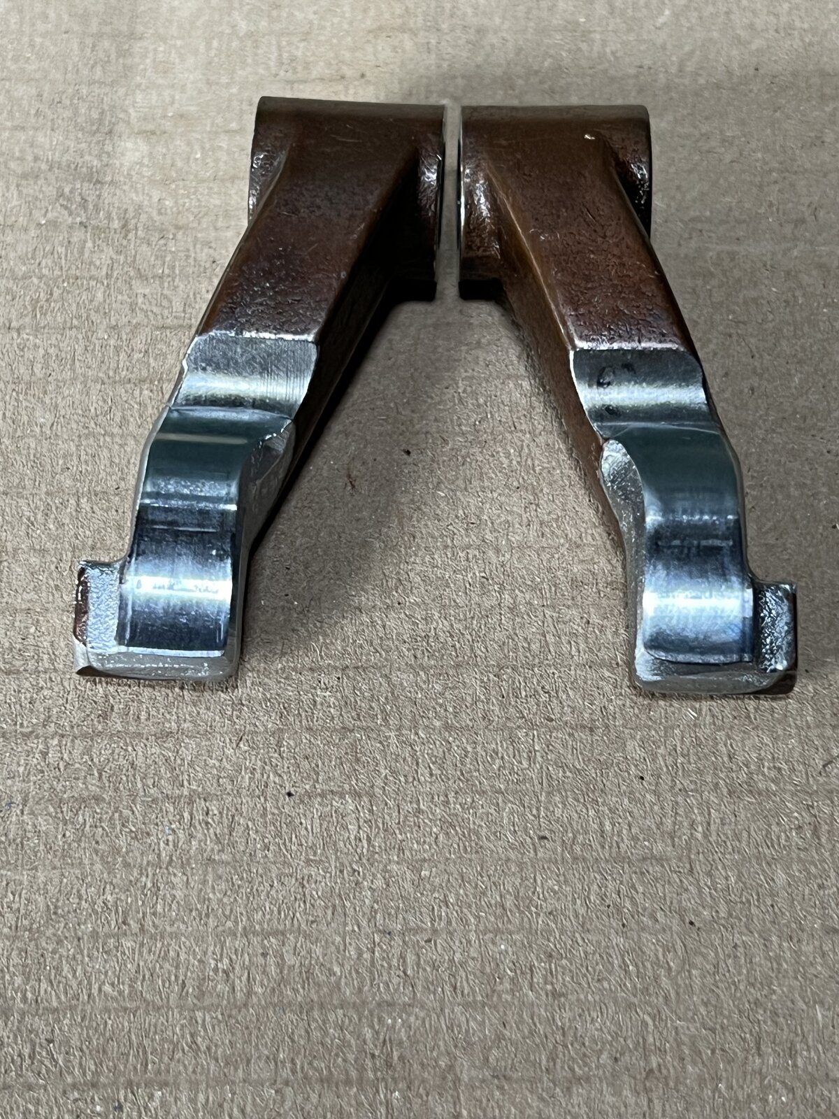

  1. It's not mine, but a chap I know has started a bit of a restoration on a 748 that hasn't run for several years. He's taken the rocker arms out to see if they are flaking. They look in pretty good condition to us, no actual flaking, but not really sure what a knackered one would like. one of the shafts has got some scoring, is it excessive?
    Pictures of some of them below
    Thanks in advance.

  2. This is what my flaking follower looked like
  3. Would say a couple of them are looking a bit suspect. Or maybe the engine has been revved before the oil has got to the top end. Bit difficult to say how bad they are from photos
  4. To me the rockers in the first 3 pictures look ok. The other 2 look knackered. The rocker shafts looks definitely knackered.

  7. People get themselves in such a tizzy sometimes .
    Do they look like brand new parts ? ...... No , they do not ( of course they don't ! )

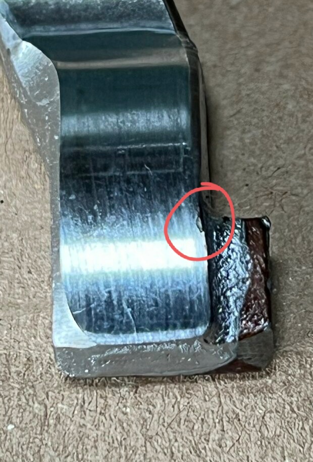

  9. Could just be the light, but there appears to be start of a flake on the first rocker. I always thought that if your fingernail could catch on a chip when you run it over the chrome, it's time to get it sorted.
  10. Hadn't noticed that :upyeah:
  11. Does that part of the surface, right at the edge actually run on the cam though?
  12. Oh yeah, so it is
  13. Some kind of myth we all believed in at some point. For me, personally, this video made a world of difference.
  14. The 4 valve 748 certainly had wear issues on the cam follower. These ones look mild compared to ones I've seen with the cam profile actually worn into the follower. Dodgy chrome if I remember.
