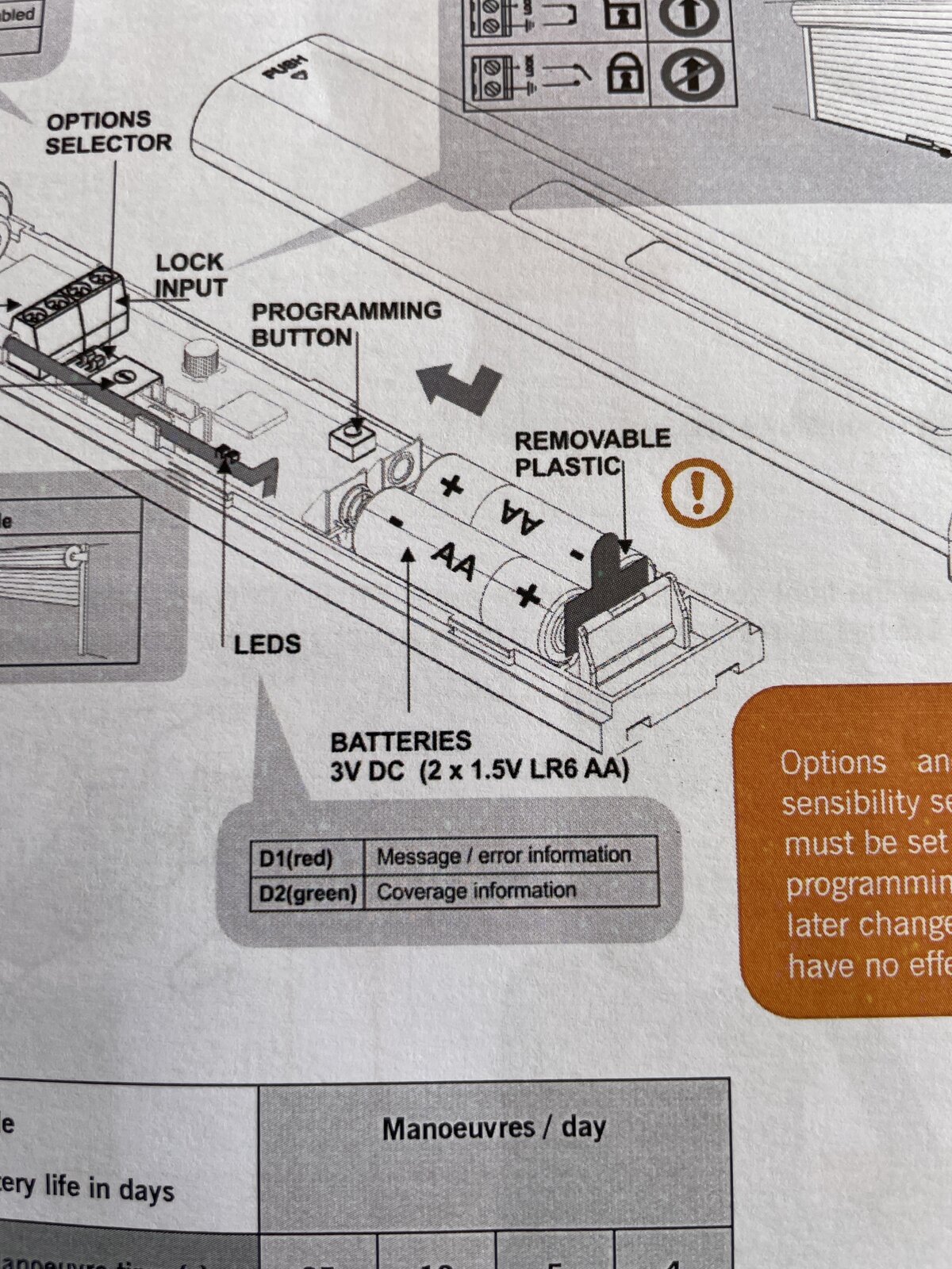

  9. The batteries look like AA - but are not they are higher voltage (At Least in mine) Somfey Control

  11. OK - but the correct battery?
