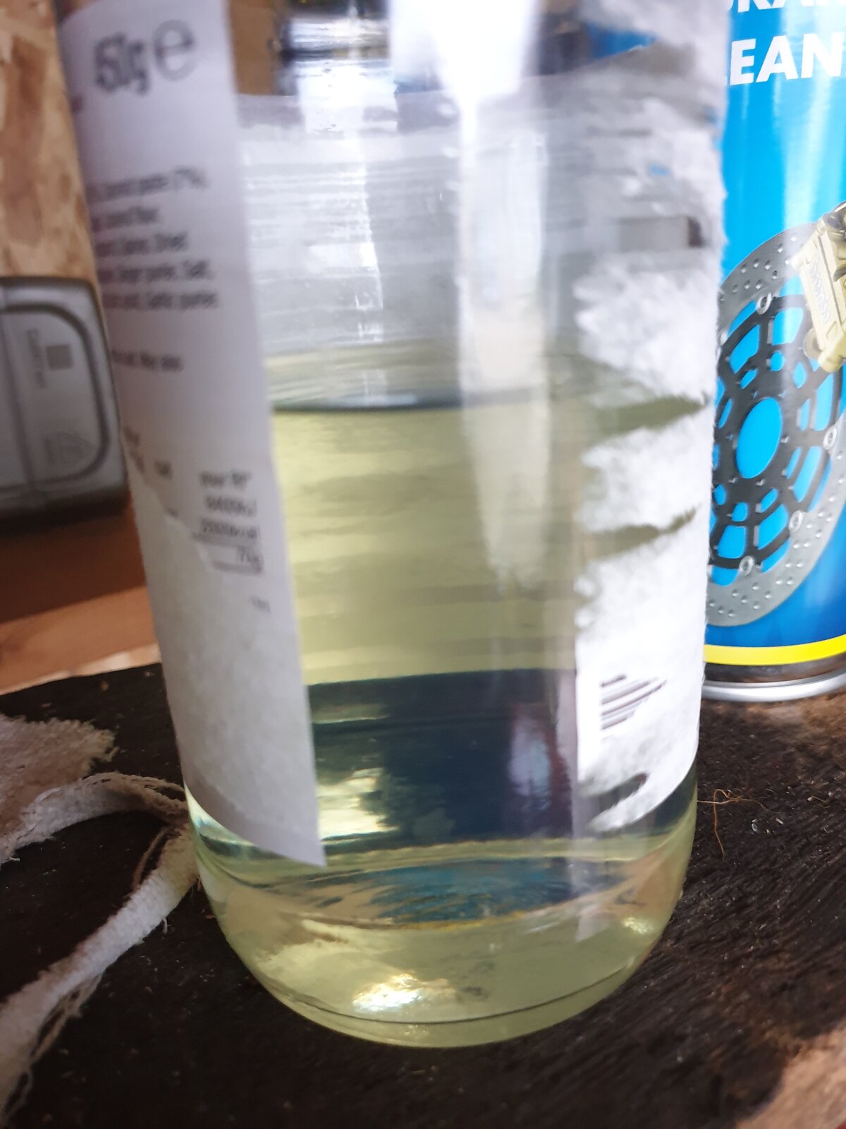

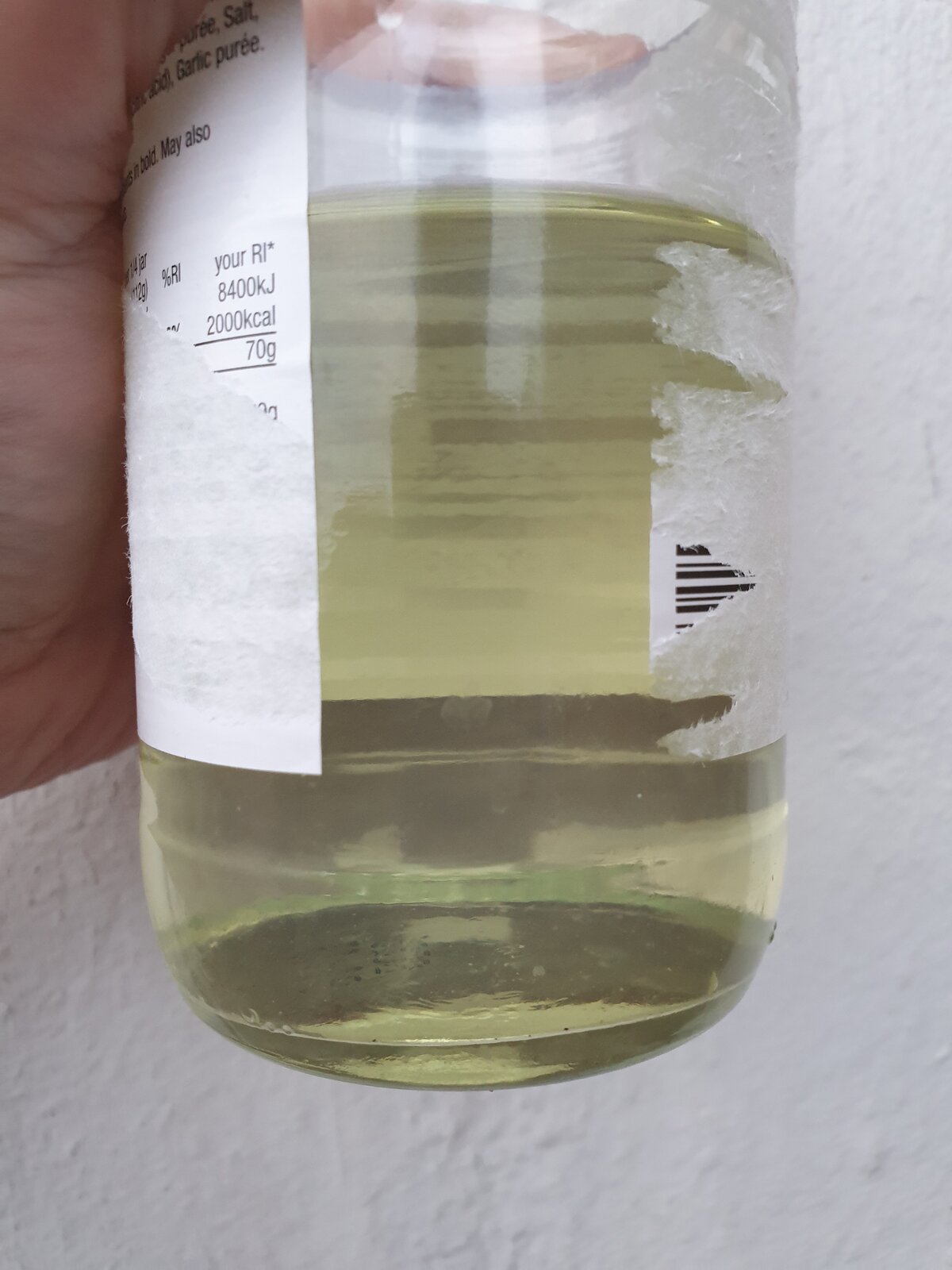

  14. So, siphoned some fuel off to check it, this is what I'm seeing. Can anyone see anything wrong with that fuel?
  15. That looks OK actually ...
  16. Hmm, that's a relief. I'm wondering if it's because I've switched back from BP Ultimate (97 Octane) to Shell normal unleaded (95 Octane), that might be the cause of it..
  17. That would not cause an issue in itself. Leave that bottle to sit for a couple of hours to make sure nothing separates out. It looks OK tho
  18. Looks OK. :eyes: Drink it to see if it's water or petrol. :thinkingface:
  19. I got a mouthful as I was siphoning it off. Definetely petrol. Can still taste it now! :sob::laughing:
