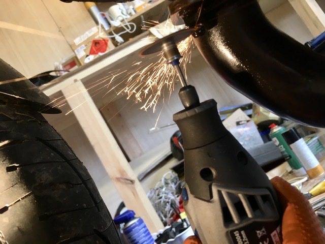

  1. It might help if you cut the rusty threads off level with the nut heads.

    plenty good advice there btw. having a dremil is always good too. cutting flush with the nut is often a wise thing to do to save you having to run a nut up a rotten thread if you haven't got heat. there will be plenty stud left once you have removed the exhaust to enable you to remove it.

    If SWMBO won’t let me and I have to resort to other tactics I will follow yours, and others, advice and apply a blow torch to my nuts:eek:
  11. It will save having to turn the nut over all that rust and the nut will still go back on the threads left.
  12. Thats why I would use a nut splitter, then a wire brush and a die to clean up the threads.

  16. Well, after giving my nuts a good soaking each day for several days, after cutting my stud down, after applying a blow torch to my nuts I can tell you it’s extremely painful :eek:. Still it passes the time in lockdown:confused:.
    Anyway, eventually they both came out. The nut is firmly seized to the stud on each one and both studs eventually came out of the head.
    So, what to replace them with? The same or can I get s/steel ones in order to prevent it reoccurring?
