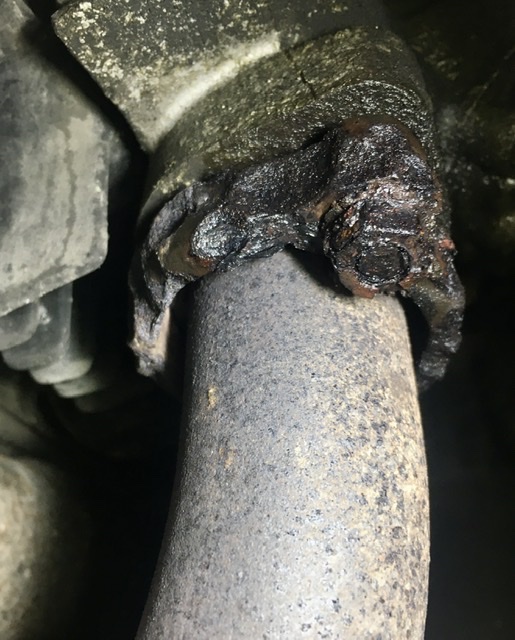

  1. If you plan on keeping it or want to be kind to the next owner, use a stud. If you don’t care, use a bolt.
  2. As the others said - there’s a reason they use the, steel stud, copper nut combination.
    Stick with it and use plenty of anti seize on the studs when you fit them.

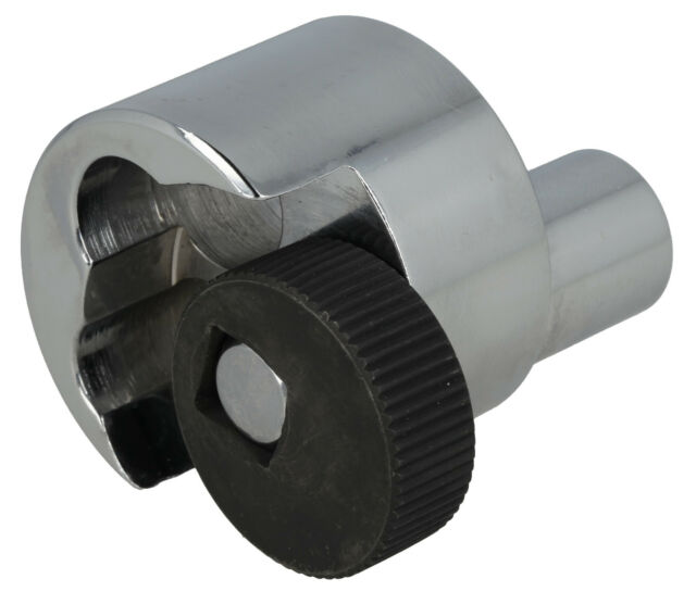

  3. These are around £10 from eBay. I have a Draper one I bought years ago and they do actually work

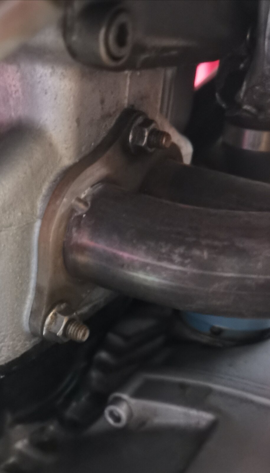

  8. Stainless studs and brass nuts? They will never seize nor rust.

  10. Brass exhaust nuts, now you'd showing your age Derek, they were always brass when I was an apprentice - many moons ago.
  11. Showing my age? Is it that long since I last saw brass manifold nuts? Probably!
    Yes, they were always brass because they don't seize onto the stud. I notice that Ducati use copper plated ones now. Not really the same though.
  12. Same here.....on every Mini I worked on and some Fords; plus several motorcycles of the vintage era.
  13. However, I wouldn't use stainless steel studs in the heads....to start off with it is better to use molybdenum grease on stainless when in cast aluminium but it will melt and burn hard.
    I don't use copper grease on stainless bolts when in cast aluminium because it can cause a chemical reaction and threads can get damaged.....I use moly grease instead.
    IMO, steel studs in the heads for the exhaust flanges are best and copper grease is the correct thing to use.

  16. To summarise then, if I may, the new studs should be regular steel, not s/steel and the nuts should be brass and the stud should have some copper grease applied before going into the head and before putting on the nut.
