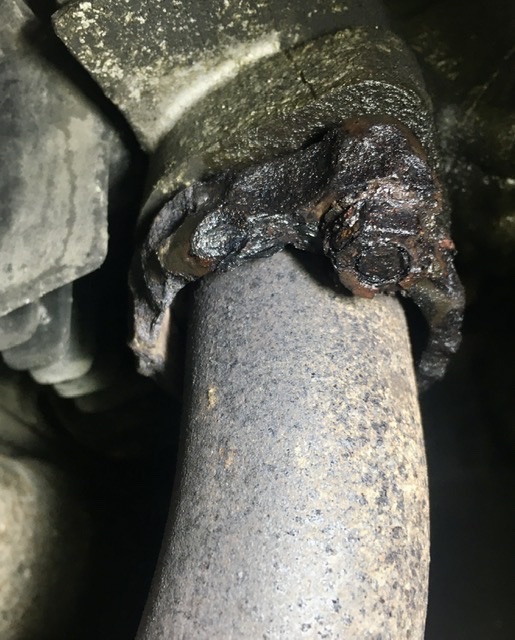

  1. Looks like you’ve your hands full with that one:astonished: that a crack I see??
  2. Looks fine, just get the fairing back on - nothing to worry about :D
  3. No, phew, I too thought that when I saw the photo but on closer inspection no.

  13. What:astonished:. I hate that too Steve. I know I posted somewhere about it being sorted as I remember uploading the photos of the heat on the stud, I could have sworn that was in this thread:thinkingface:.
    Anyway, end result after heat treatment was the studs came out of the head rather than the nut come off the stud.
    New studs complete with copper nuts were ordered and delivered, copper greased and inserted into head. All good now.
