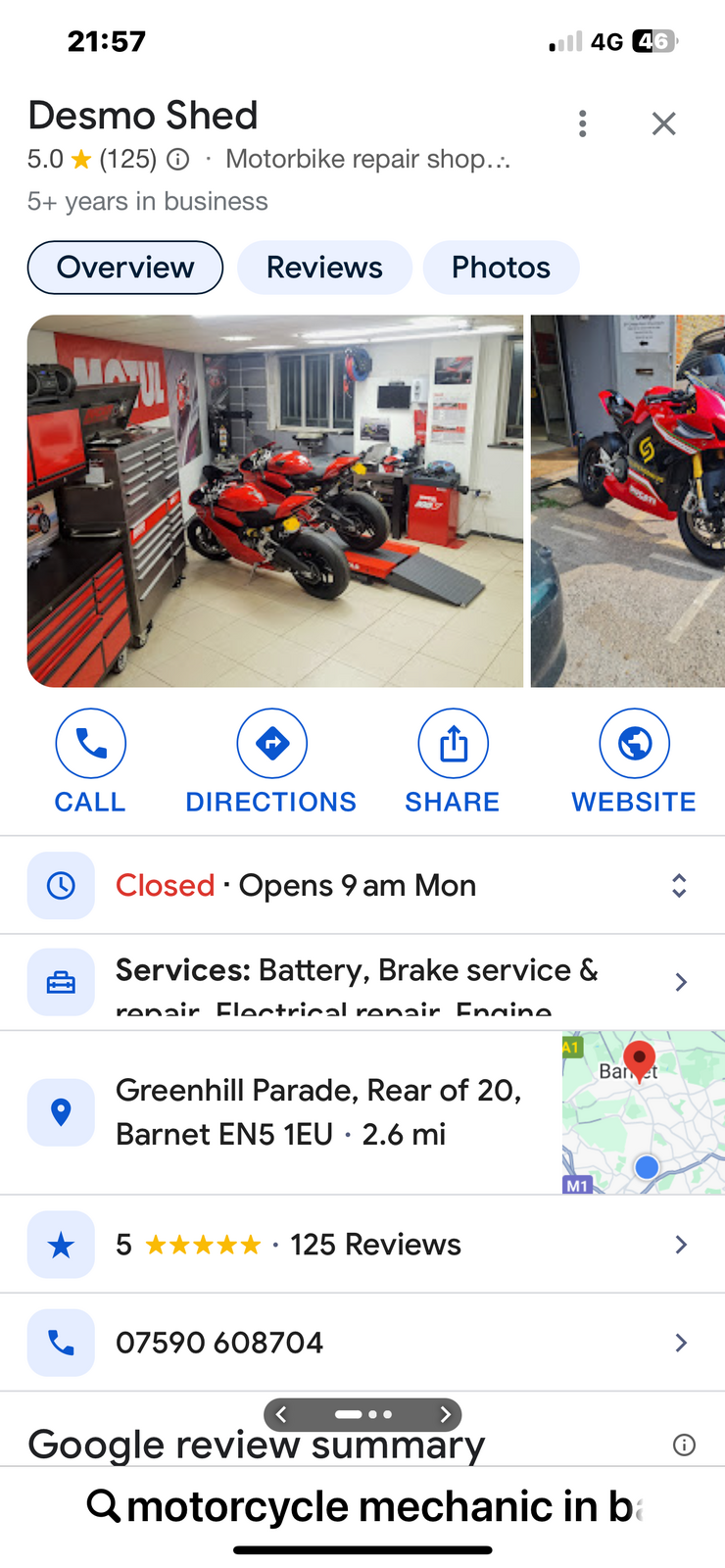

  19. I have used this chap for a few bits and pieces, you can eat your dinner off the floor in the workshop.
