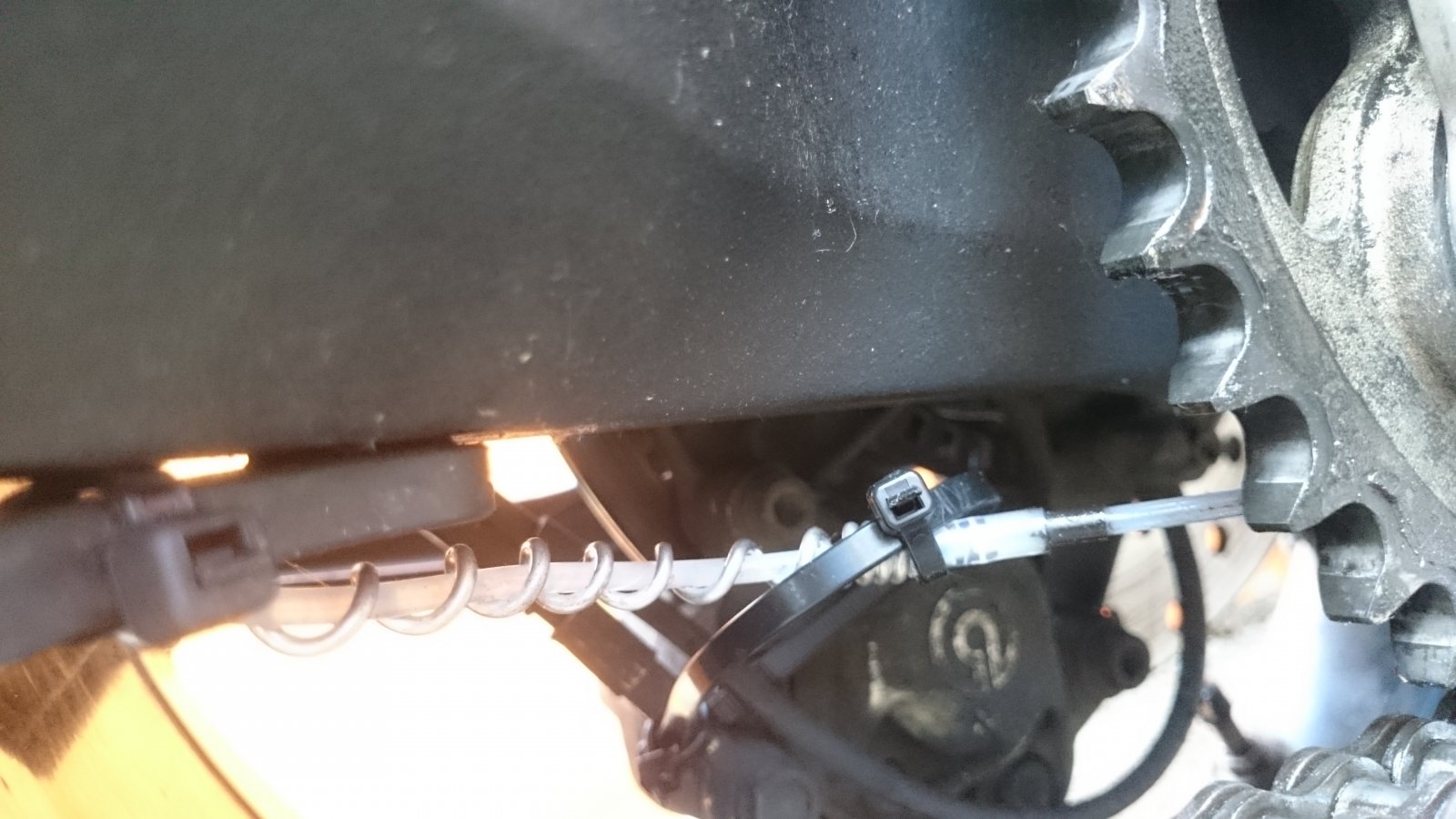

  3. I struggled to get a non-excessive flow with the Tutoro but the helix delivery tube is really useful and I use it for all my kits now. It's worth having a look at the PDOiler which is an electric pump with adjustments and the mini system compact enough to fit behind the seats side panels.
