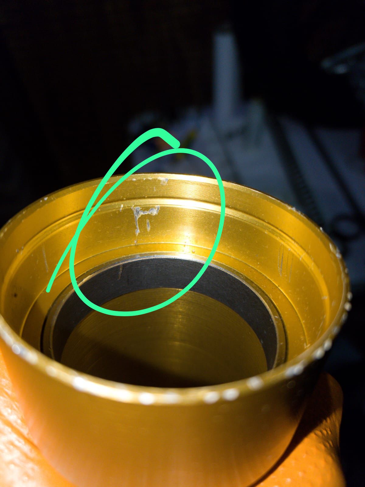

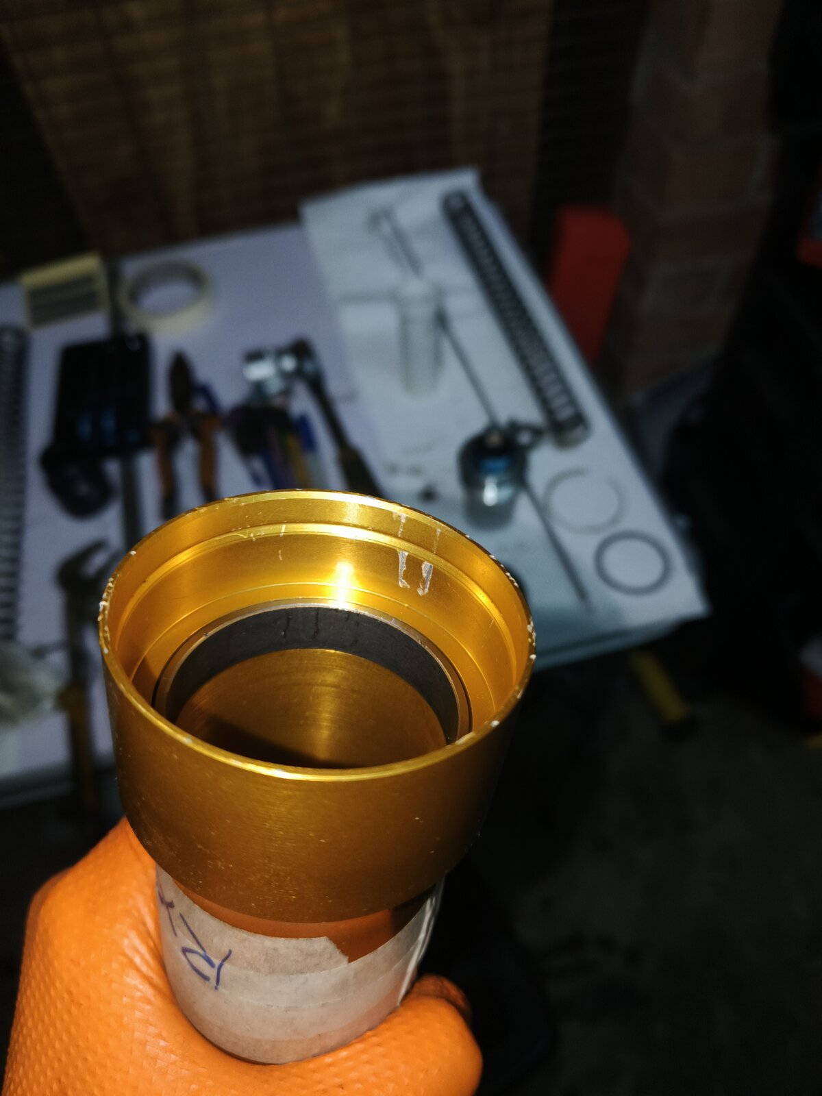

  1. Hello everyone. I've removed the oil seals on my bike to find some deep scratches behind where the seals pushes against outer fork tube.
    Would it be a good idea to use some liquid gasket or sealant to fill it up?
    Here's some pictures.
    #1 Mike 999, Feb 22, 2025
  2. Someone got heavy handed with a screwdriver by the looks of it. It’s the back of the seal so as long as it’s not got any raised, sharp bits it will be fine.
    • Agree Agree x 5

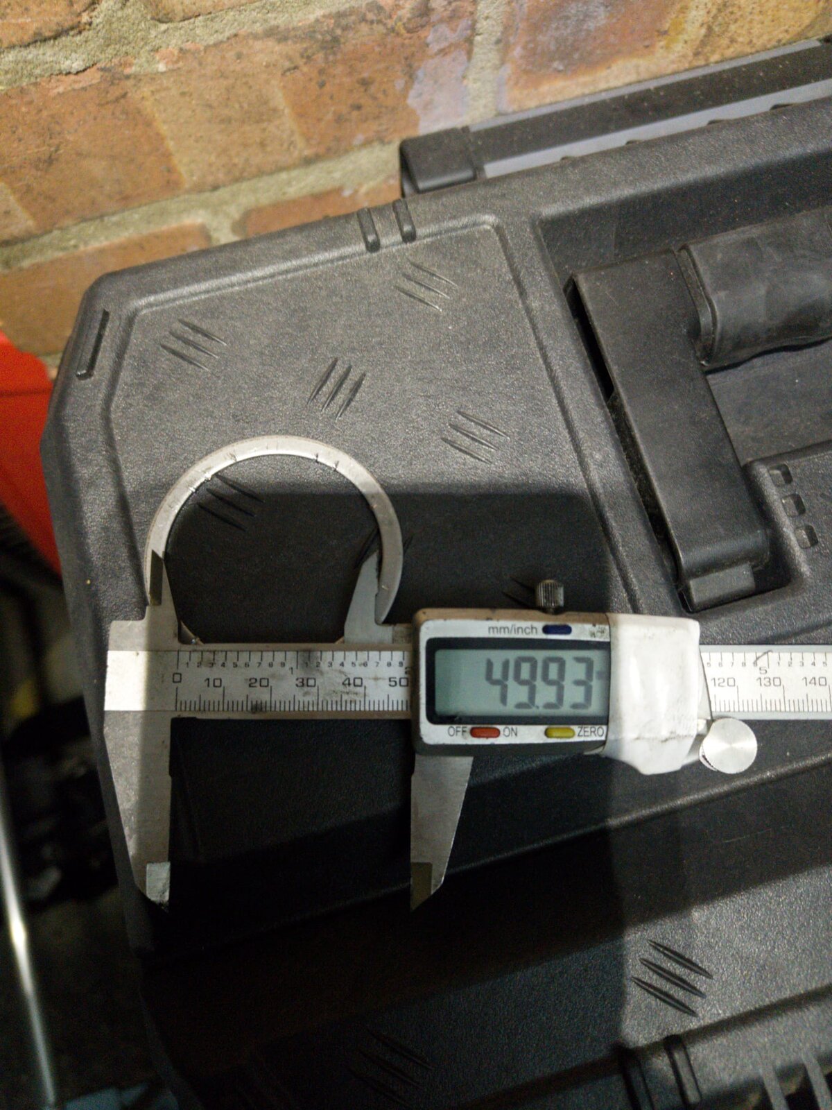

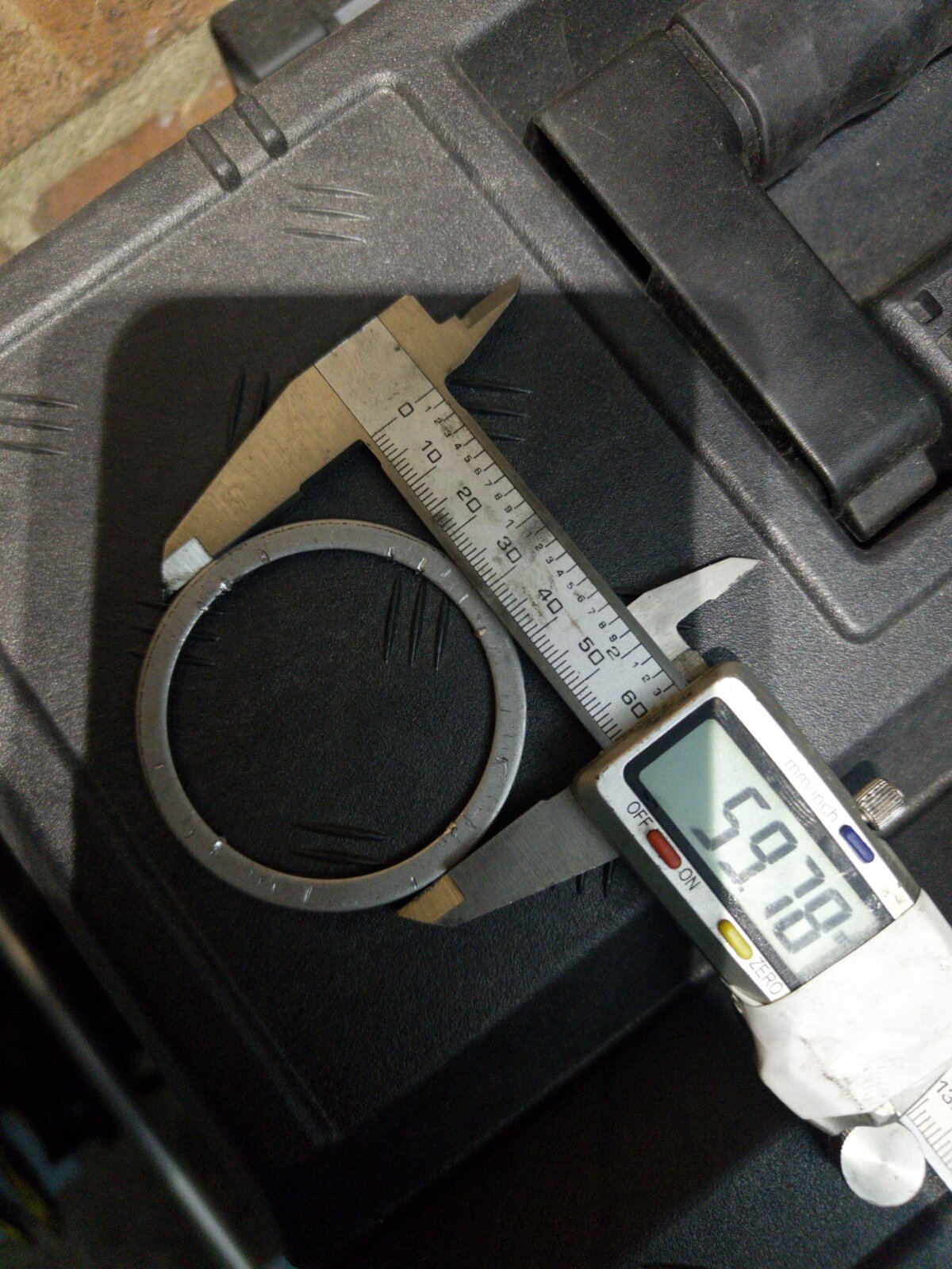

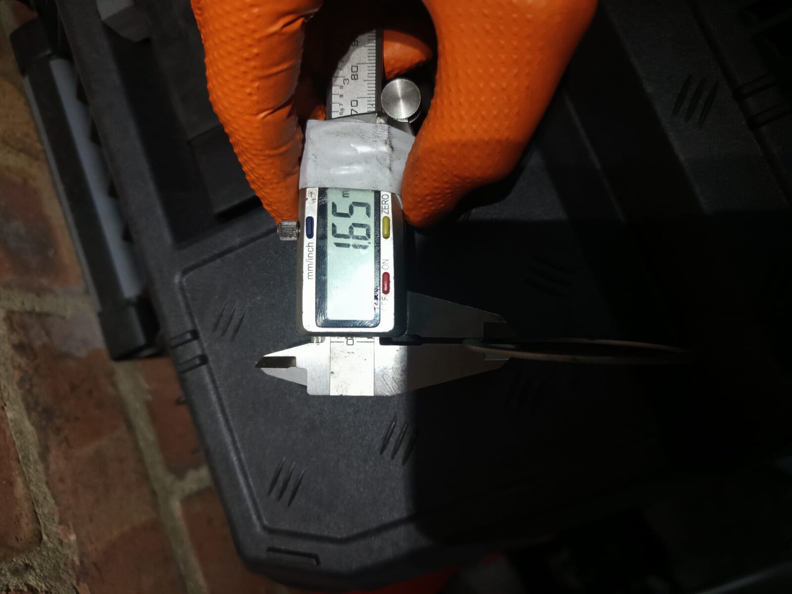

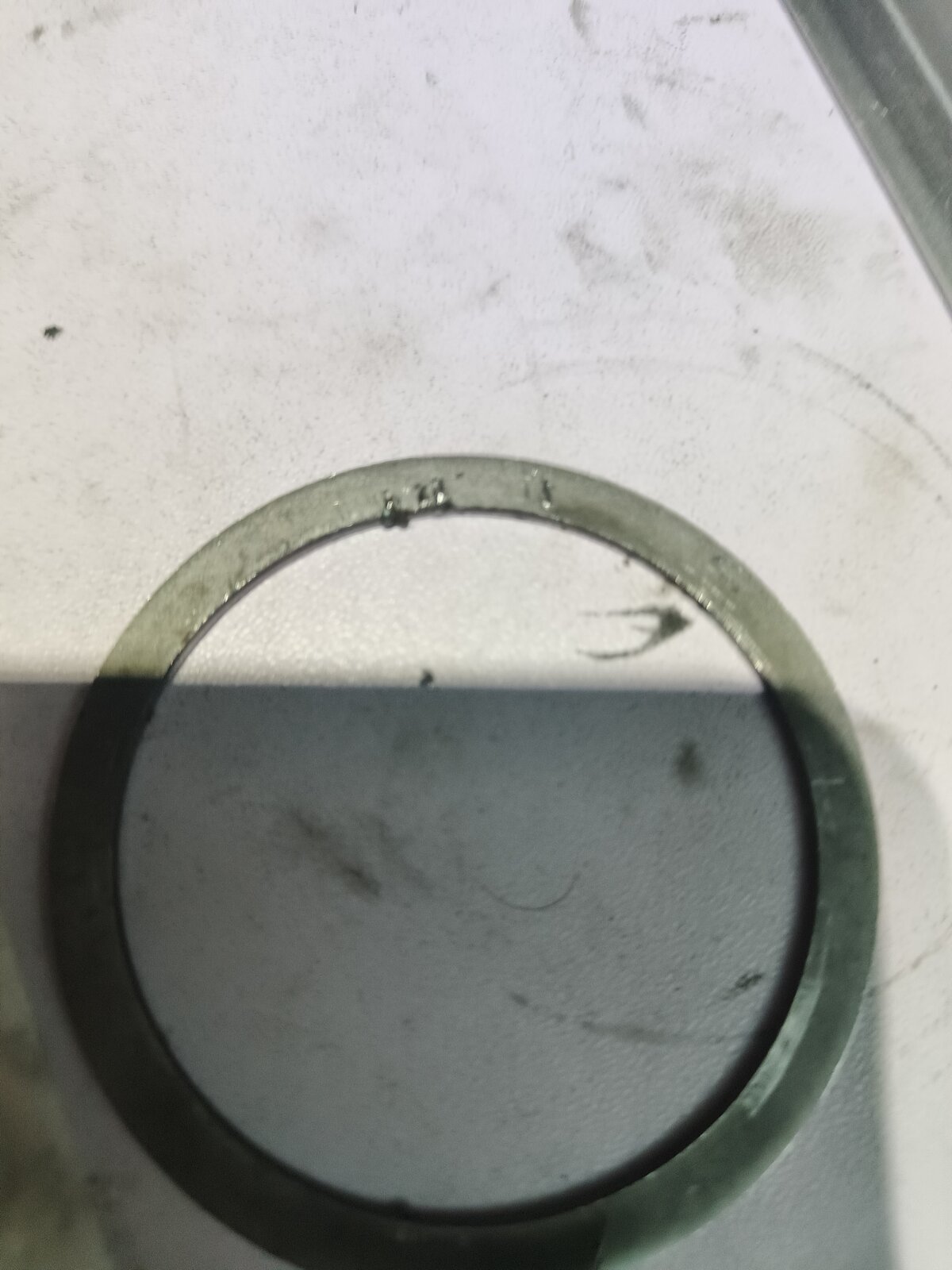

  3. What about the spacers behind the seal? They are pretty dented. Could they cause any problems to the seal?
    I'm planning to replace them if I can find them but I'm try to find why my forks leaked so often.
  4. Looks like the damage to the spacer might be pushing at the seal lip. If you can't find spares, try flatting them with fine emery paper on a flat surface using fingertip pressure.
  5. i've heard of folks using super glue and fine wet and dry for that king of thing. the pic doesn't suggest it's too bad. maybe just a dollop of LM grease when inserted and a cloth could sort that
  6. Measure the ID and OD.
    Think I've got several about and am happy to post you a couple.
  7. thanks. those are the measures.

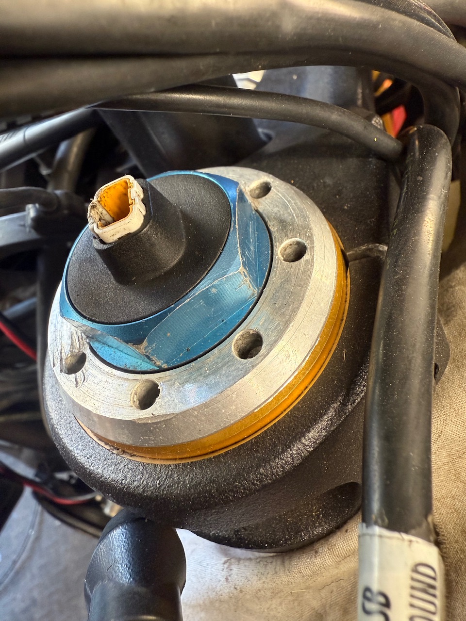

  9. When you opened the forks I was supposed to slacken all the preload. But when I tried the nut didn't move at all. When I removed the top cup, there was no pressure from the spring... Meaning there was no preload at all. Could that be also the reason for the seals failing prematurely?

  14. That spacer is there so you can drive the bush in without damaging it. The seal rests against it, but it won’t affect the integrity of the seal lip. just file away the roughness and it will be good to use.

    Do those forks have any preload that you need to adjust from the blue nuts on the top, or are they completely electronic?
    That nut on the top of mine doesn't move at all. Either ways.

  19. Preload is set on each fork leg by adjusting the big blue nuts, clockwise screws it in and increases preload, CCW decreases preload. It’s not electronically adjusted.
    The damping valves within the forks are adjusted electronically by the DSS system. RH side is rebound, LH is compression.
    This 2010 MultiStrada which is with me at present has 15 turns none to full preload, this customer has it set at 6 turns in from fully out.
