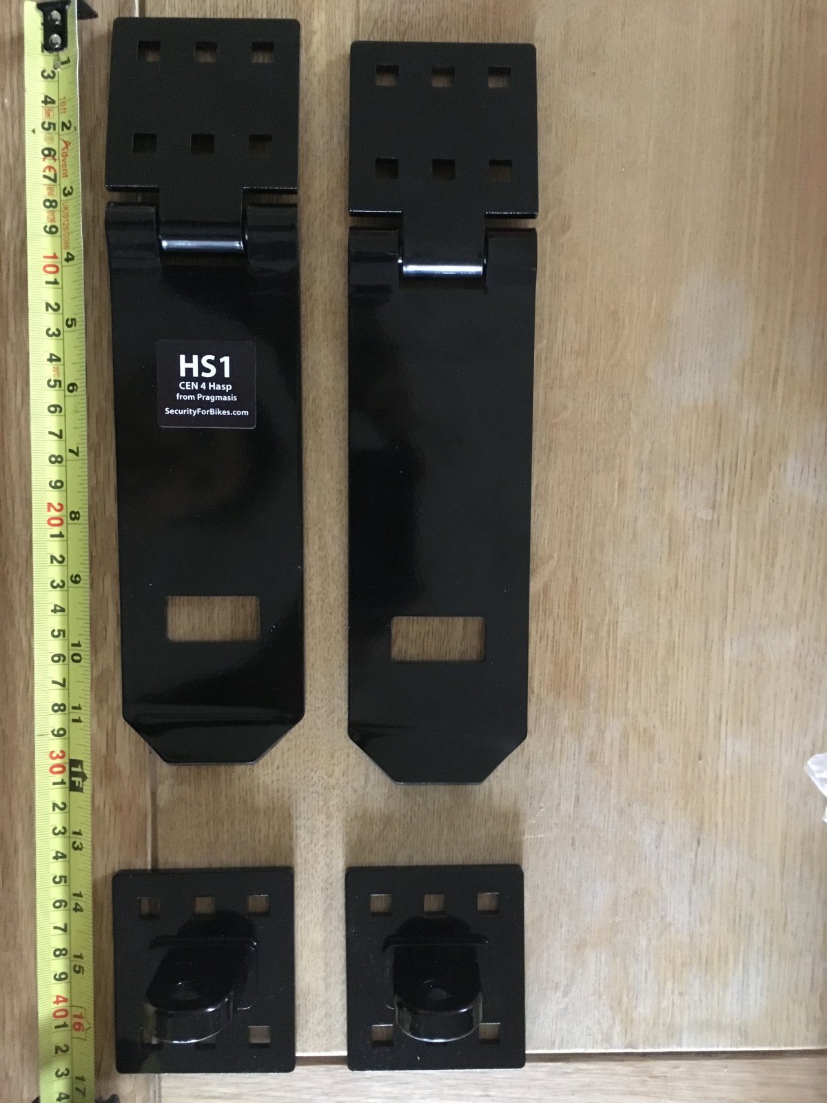

  12. @Cream_Revenge and not just buy pragmasis 19 or 22 mm chains and ground anchors, make sure they can't get in, pragmasis sells these wonderful over sized goodies too IMG_1397.JPG
  13. fitted with 8 supplied coach bolts!
