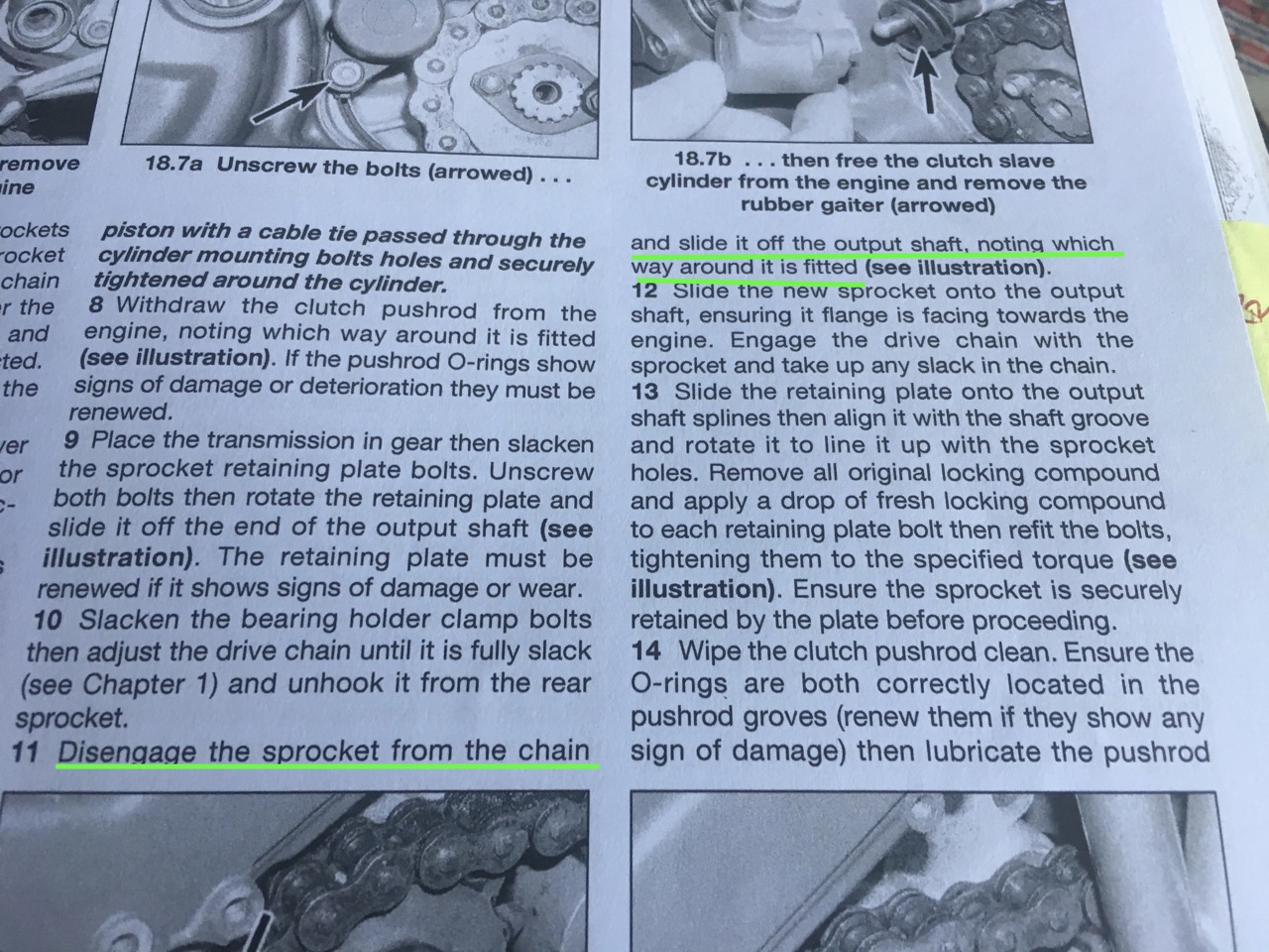

    It's very fecking simple. It says so in my Haynes manual. Take the chain off the sprocket and slide it off the output shaft. It's not fecking difficult. Why some moron had to cut the bucking thing in half I'll never understand:confused:

  2. Did you note which way round it was fitted :eyes: if not follow my link to a video :yum

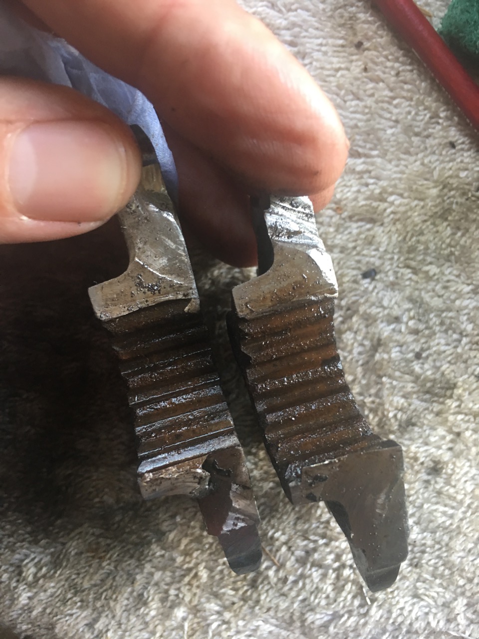

    For everyone's information a grinder and a dremel WILL NOT have it off in no time. I left the two of them together on the garage floor all night and sweet FA happened:(. There was zero attraction. Zilcho copulation.
    Additionally, when I used them on Sprocket the angle grinder is too big and the dremel won't fit in to cut all the way through. The last bit has to be done by hand with a hacksaw, unless you don't care what happens to the output shaft:worried:. That is one f**king mother**ker of a piece of hardened steel to have to cut througho_O

  4. Cheesus bucking H Christ:mad:. I never thought of taking a photo. Bollicks!:mad:
    I'm flummoxed now when I come to put the new one on (having cleaned all the corrosion off my shaft and greased it).
    Which way round should it go?
  5. Not sure :thinkingface: maybe start a thread and ask :eyes:

  7. A thread? Does it screw on? Oh FFS no wonder I couldn’t get it off. I thought it slid off not screwed off. Fecking Haynes Manual’s full of fake news :mad:
