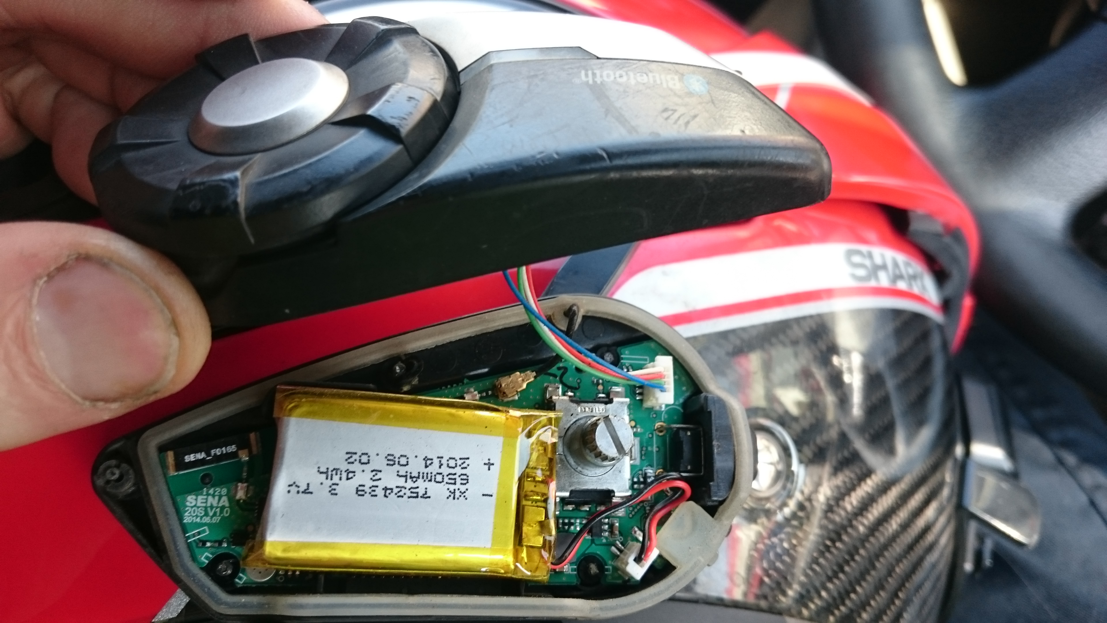

  9. I've took my Sena 20u apart just to take a gander. They look like the battery can be replaced most certainly.

    Whilst the battery shouldnt be replaceable it is if you can remove the battery compartment lid, which is more than possible. However I've trawled the web looking for a replacement, including contacting companies who supply them. I cannot find a new one any where.
