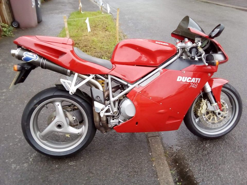

    Its going for less than 5k. Photo below - with bins!! Any glaring no-no's? I'm new to Ducs and don't know what is original etc.....bottom of a big learning curve. 748Mono.jpg
  13. That’s a 748E, base model (nowt wrong with that but just so you know), I’d guess 2002MY judging by the fairings, looks clean enough. It’s probably the light in the photo but the frame & wheels seem very light in colour, have they been resprayed?
    the important thing is the service history, is it full and things been done when they should have been?
    With 8 owners I doubt the original cans are still with it:(
    Edit: duhhh... you said in your opening post it was 2002, I just looked back :confused:.
    FYI there were only 60 2002 E models made, all red; last of the run:upyeah:

  14. Thanks WC Paul, I've not viewed it - yet, if I do I'll probably weaken and buy hence I'm trying to find out about first.... and if its total pile of tosh I'll be trouble with T&S. It's claimed to a 2002 Mono with 'lots of service history' and '8 owners I think' - not my words so, that sort of puts me off.
  15. Well it’s definitely not a mono as it has a biposto seat and pillion foot rests.
  16. Perhaps best steering well clear until I know what I'm buying. Appreciate the support!

  18. If the service history checks out and it’s as clean close up as it looks in the photo and you got it for 5k or less, IMHO that’d be a fair deal.
  19. Thanks for the info Paul, the number of owners, not being original and lack of seller response sort of rings alarms bells to me - too belts'n braces me.....o_O
    Pretty clued up on when to change belts but that's my limit at the mo.
  20. Why’s it not original?
    Apart from the screen, that’s not original.
