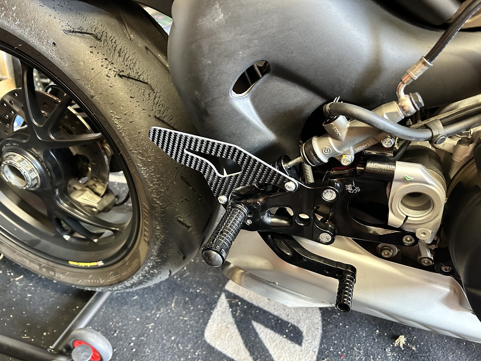

  14. Hi All
    Does anyone know the rear brake Banjo bolt size and thread type please ?
    I've fitted some rearsets, and they don't have the bracket for the brake light switch, so I need to source a banjo bolt pressure switch, but can't work out the correct size

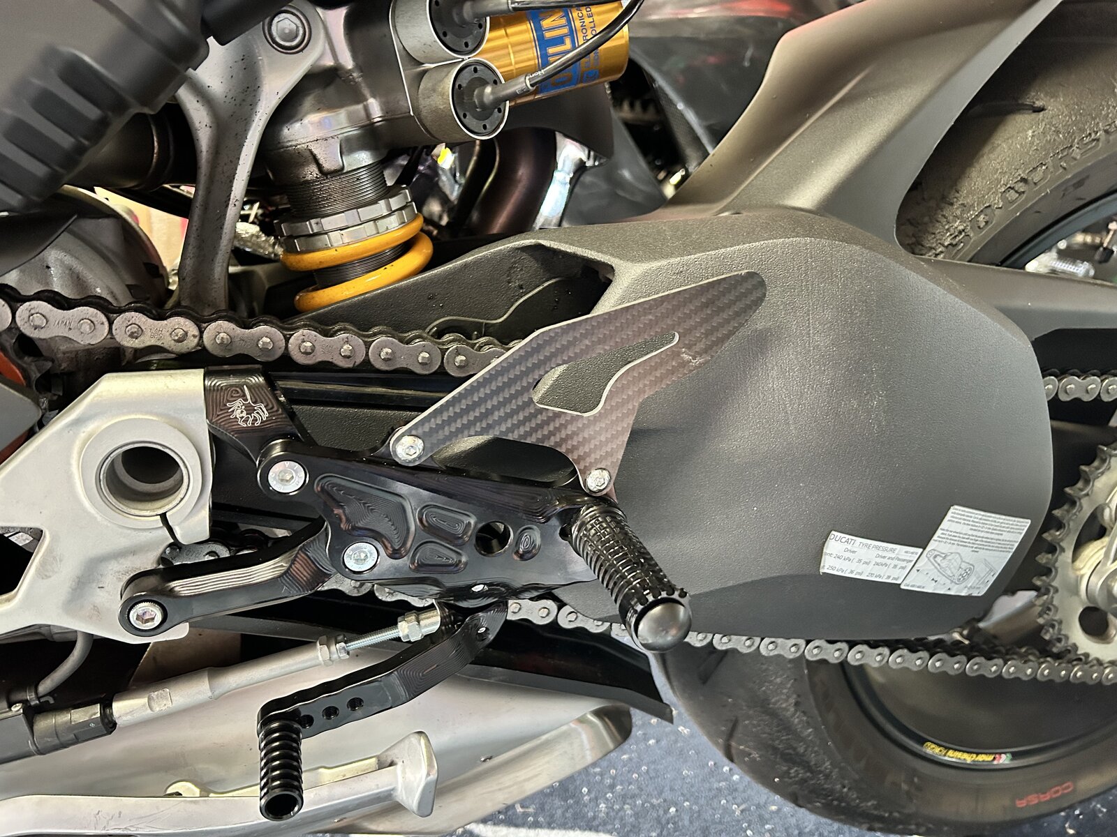

  17. Added some Spider Rearsets
    They’re quite cheap in comparison to most offerings for a Ducati, but they’re good and solid and help raise the foot pegs by about an inch, and bring them back a fair bit, so a much nicer rider position
