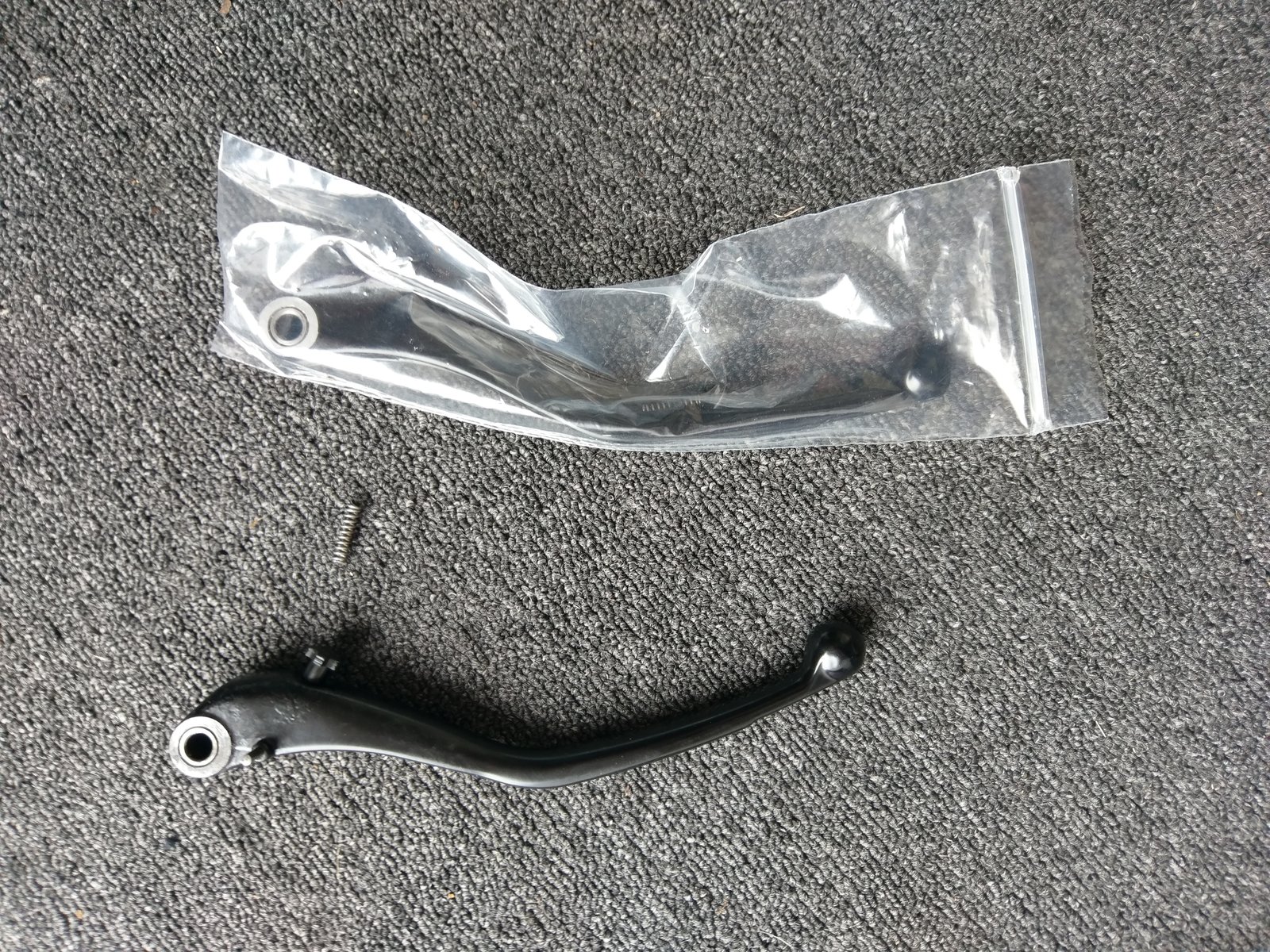

    Out for a quick blast today and noticed my brake lever pulling in a little further than I like, so stopped to alter the span adjuster. On trying to rotate it, the thumb wheel was seized solid. So went home, removed hand guards and both levers,sprayed in WD40, and could not even move with pliers.
    I phoned Andy in service down at MR, and within 1 hour, he had supplied 2 brand new levers which he merely asked for a signature only. No payment was required and he did the warranty claim while I was on route with the duff levers.
    I swapped over the spring and plunger mechanism to the new levers, and they are now fitted and all is fine. All Andy asked, was that when I'm next about, I drop the old levers in.

  6. PS, if anyone ever swaps out the levers, you don't need to buy the press to get the liners out, just tap through with a suitable size socket. :upyeah:
  7. Thought my lever adjustments were seized too , but just pulled lever back towards the hand guard and then adjustment screws worked ok once load was off them . Mine is a 2014 bike. Is it normal for these adjusters to seize up ?
  8. I don't think it's a regular issue, but yes, I did try that, but these would not even move with pliers once levers were off the bike. Strange how both of mine seized though?

  11. Mine have seized (i.e. cannot be adjusted by hand even by the Hulk), from new, both sides. So did the bike before. Just WD and long nose pliers to get them moved.
  12. Yeah, I got the thumb wheels moving bradders but the locating head on the inside of the levers would not rotate so something had bust between the two.
