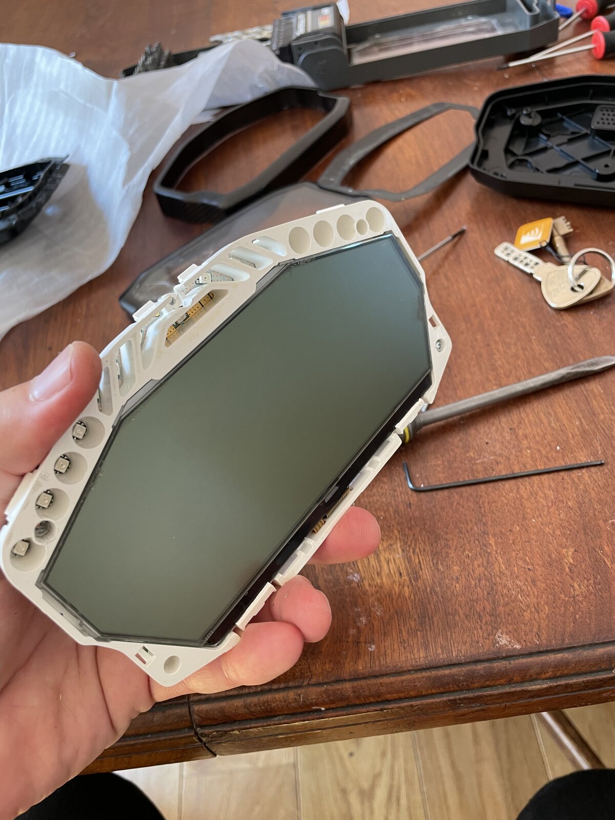

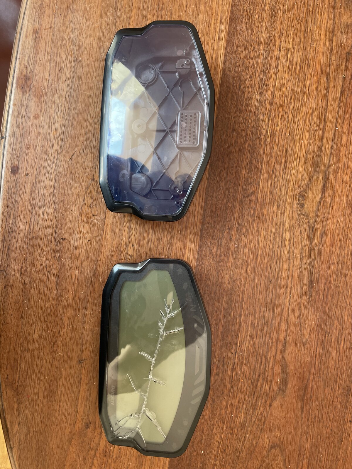

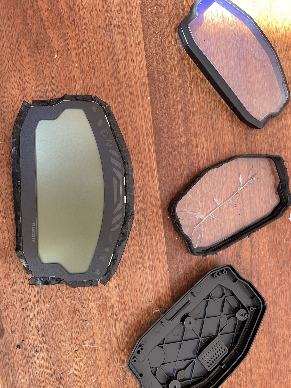

    I got one of those aliexpress dash cases a while back, finally got round to doing it. It looked accurate enough so I stripped the plastics and got to the dash, prising the oem case off isn’t easy as it’s well bonded, main worry was damaging the pcb/lcd inside but it finally popped off, under the sticker is 5 screws holding it to the back case, these appear to be torx T6.5 because the 6 is just too small and rhe 7 too big. A 1.5mm Allen key just about did the job. Screwed it and glued it, seems to be working still. Finally crack free, now to get these bloody plastics back on

  4. Hi, yep those are my genuine photos and handiwork, been fine since I did the swap touch wood. The Google bit was for anyone coming here via a Google search not that any of the info came from Google if you see what I mean.
    The black surround is just stuck on, the LEDs behind light up behind the coloured filters, no wires attaching it. Caveat being mine is an 899 and there’s a minuscule chance an 1199 would be different but I doubt it.
    Those screws are a bastard, no idea what they are. I had to drill one out as the head stripped.

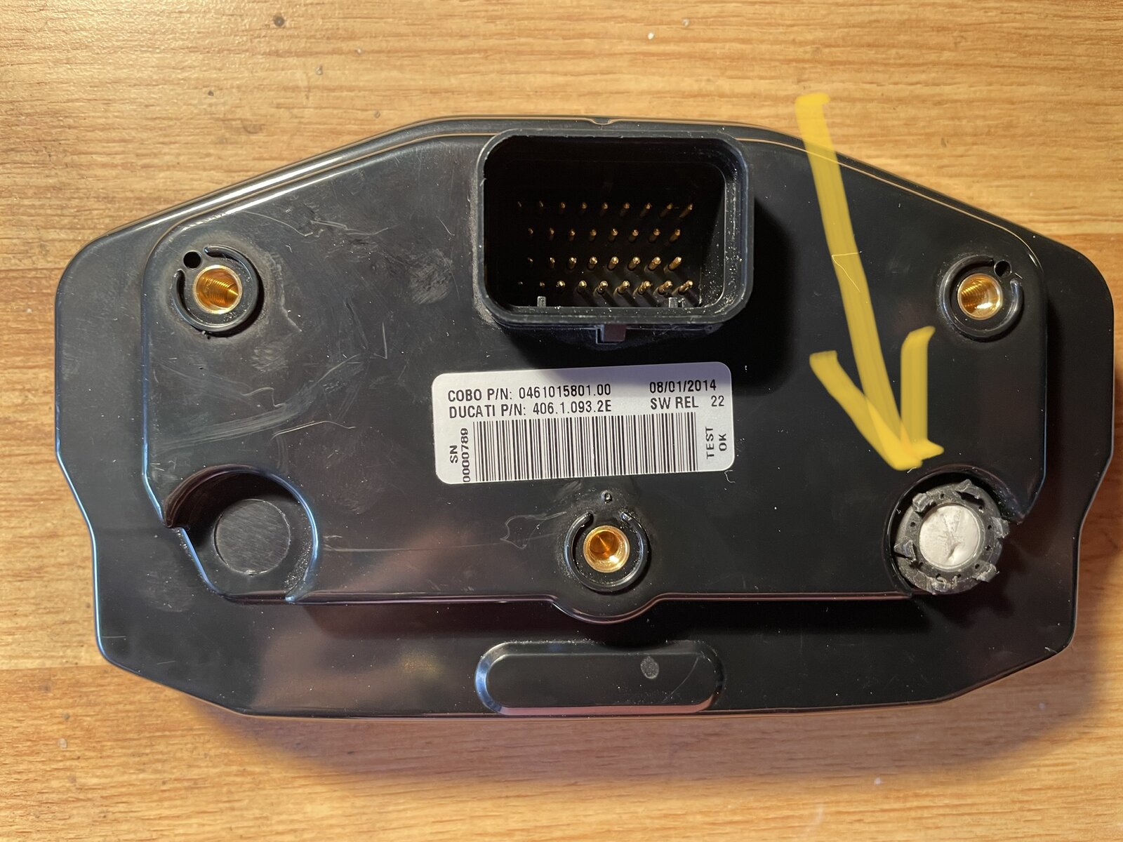

  6. Hi again. I got the sticker off and the 5 screws (T7) out the c/board is still a bit reluctant to come out, feels like there’s resistance here at this big plug/nut thing on the back. Any ideas? Cheers BA1E00CB-4FD3-4808-93AE-B86155038126.jpeg
  7. Looks like an air vent, probably for the barometric pressure sensor.
  8. the bung in the corner doesn’t seem to be for anything in this set up, I guess the plastics were moulded for various fitting options and only the one getting used is used, there’s nothing behind it on the main internal unit that lines up. I ignored it and no issues
  9. Thanks :upyeah:
  10. Thanks again, still seems a lot of resistance to get the whole c/b out. :confused:it’s so frustrating, I’m within touching distance o_O
  11. Trying to think back, can’t remember if there were any of those clips moulded into the plastic to prise apart before it dropped out. Seem to recall it took some finessing to get off the back but can’t remember exactly unfortunately. Perhaps that bung/screw does something on models other than the 899 but it was redundant on mine

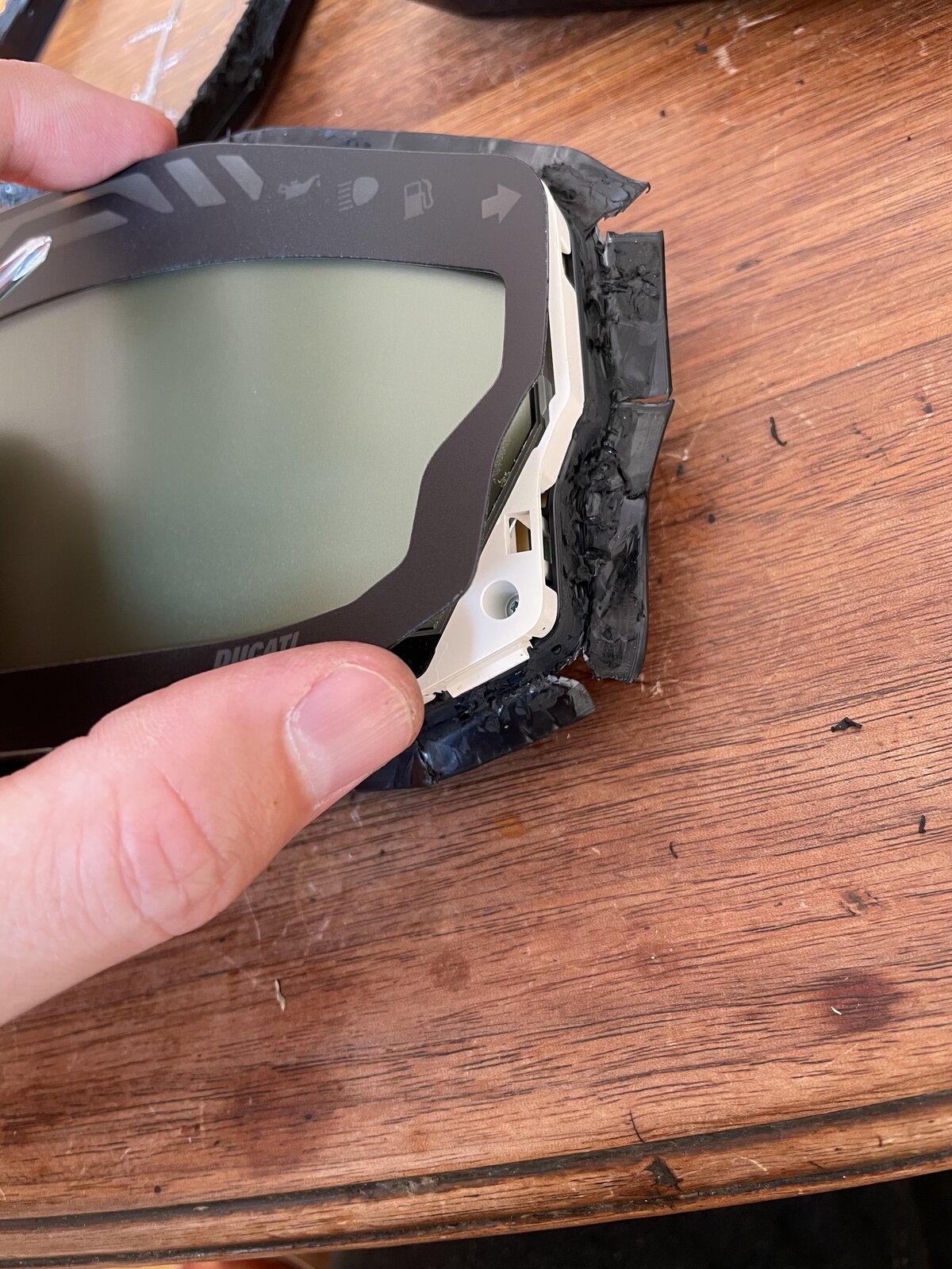

  12. Got it! :upyeah: Was a bit tight on those 4 white pins that locate the white surround and circuit board into the back case. Result :cool:
  13. Nice one, putting it all back is a lot easier. Until you get to those bastard fairings at least

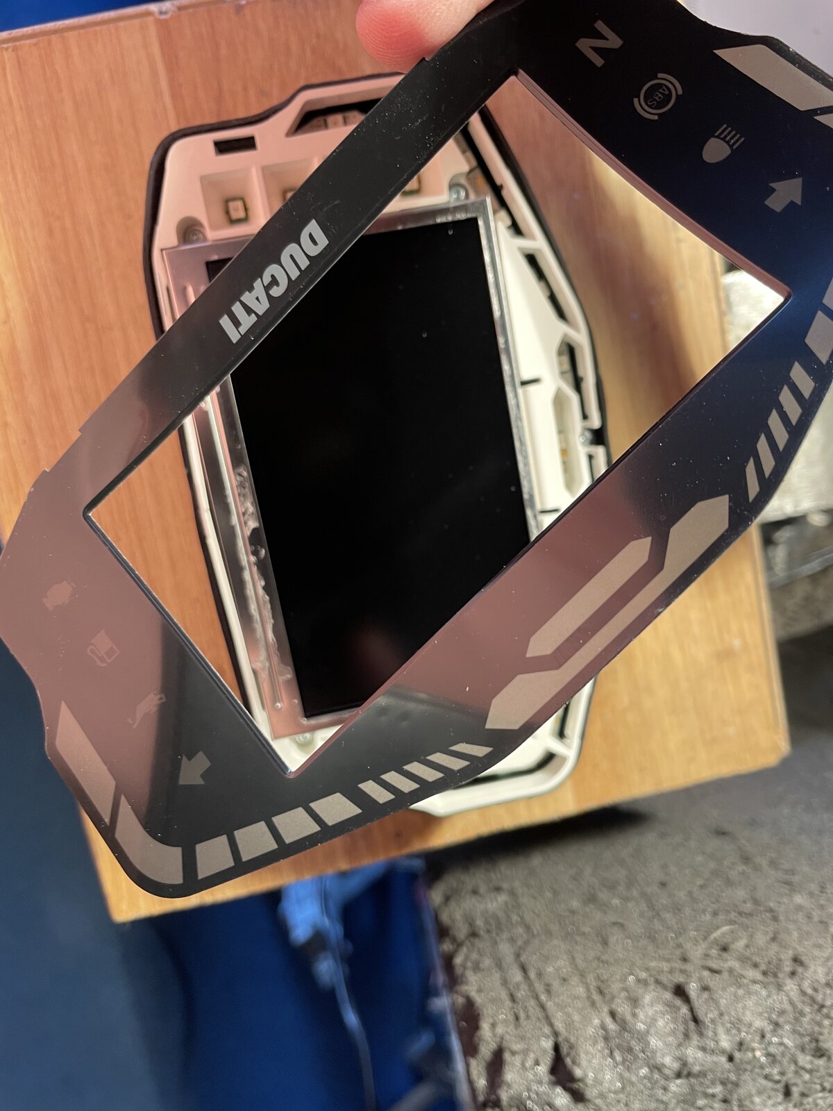

  14. Cheers again for your help and tips, much appreciated! Knowing there were 5 screws under that front sticker was the key, lifting the sticker (with heat/hairdryer and then a bit of ‘jiggery-pokery’ and out it popped :upyeah:. The dash is all back together now, with Sikaflex, top job!

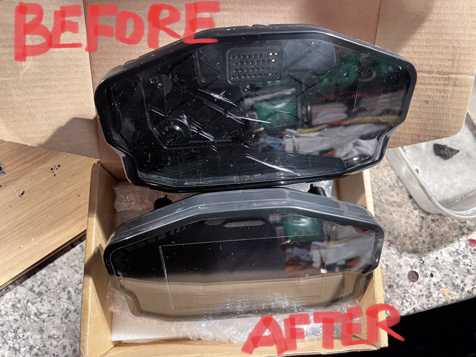

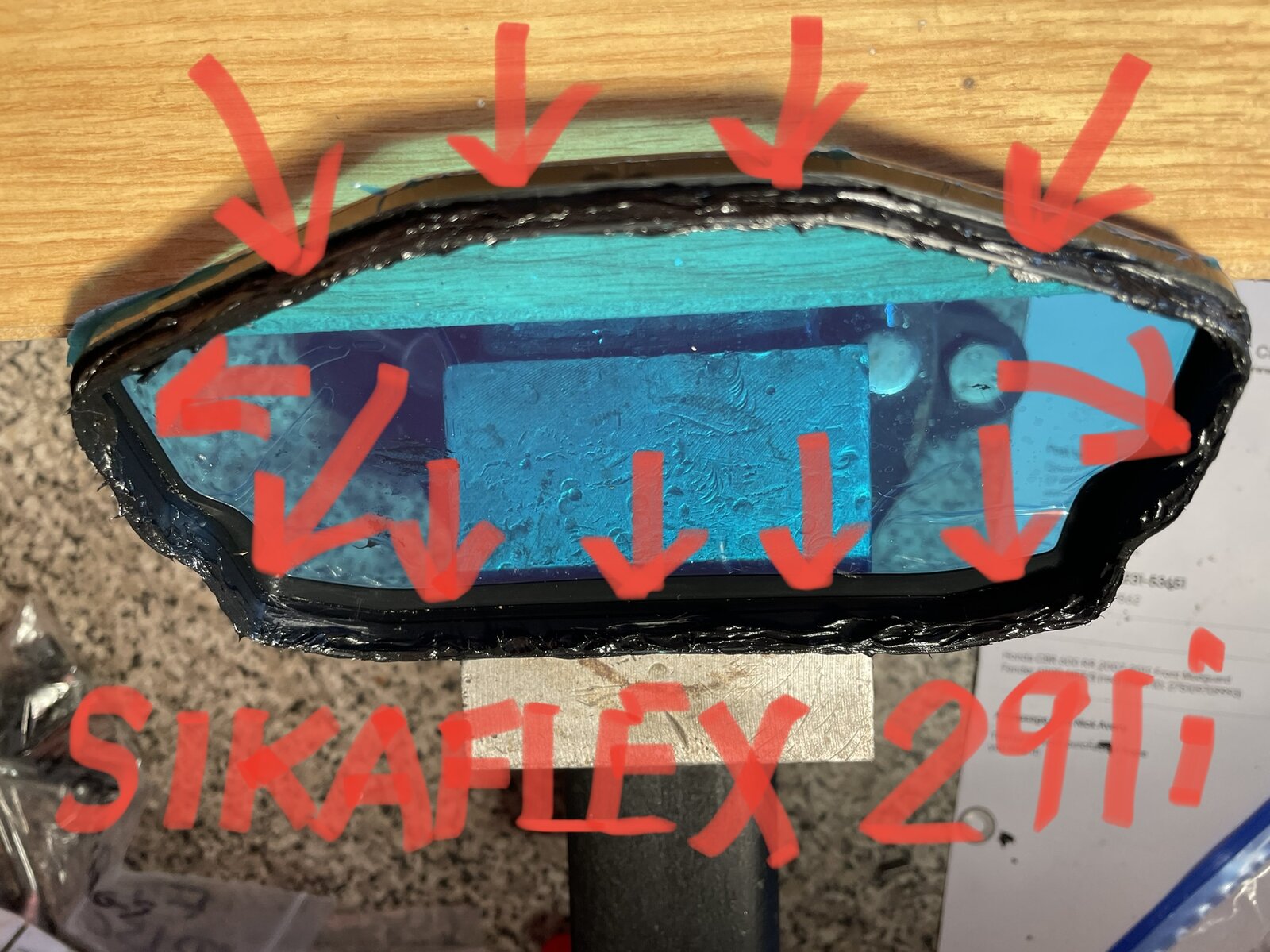

  17. 5350DE16-AF7E-4950-8845-62844871B9CF.jpeg 7BFFECB5-F2C5-4EB2-99CE-0BB350D1B00E.jpeg 055A2D0C-7864-40D2-9292-D060F26F7900.jpeg
    That Threebond will probably/possibly work but I did a bit of research, read numerous reviews and I used Sikaflex 291i, black. It’s used extensively in the boat building and boat repair world, it’s adhesive, flexible and waterproof so ticks all the boxes. Worked perfectly :upyeah:
    ps. I nipped the end of the nozzle (heat with hairdryer or heat gun, nip with pliers and let it cool) to make it narrow and could fit down the groove of the back case, before pressing on the top clear screen. Also made a yellow mark near the end so I knew I was going to full depth).
    Tip! Put some protection over the coloured dash so you don’t get the sealant on your dash.
