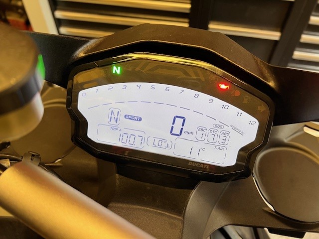

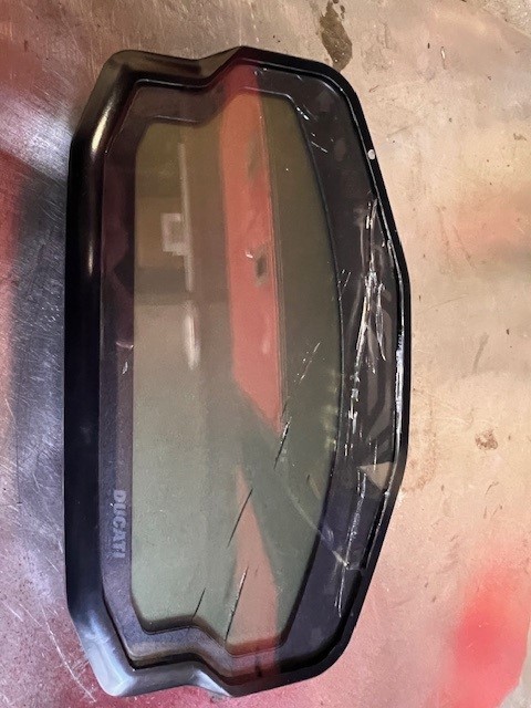

  3. ok so just in case someone is looking to do a replacement, i did mine to day, and i have to say i was dreading it
    a few videos on youtube and in the manual and i have to say it was pretty straight towards to get nose cone off, took me about 45 minutes
    got the tacho out and run a junior hacksaw through the groove between a front and back and it came apart very easily
    i didnt want to take the chance of damaging the tacho electrics so i used the old back, left all components in place
    i took the front replacement from aliexpress and rubbed it on a flat surface with sand paper until there was about 1mm of the internal flange left
    offered it up to the old original, size was pretty much bang on, held it in place with rubber bands and fixed with super glue, running a bead around it, covered that black tape
    all in took about 3 hours and the worst bit was getting g the mirrors back on
    all in all very very pleased

  9. Just to add my tips, as i've done this on a V2 dash. The case was extra glued, it took quite a bit of prying to get off, probably would have been better to hack saw it off. The V2 dash has 4 screws holding it in.
    I put the sealant onto the base of the dash before i put the pcb back in, this means you dont have to worry about getting sealant on the dash and i didnt feel the need to put it on the glass side of the case. Pushed it together and wrapped it with electric tape for 24h. Job done.
