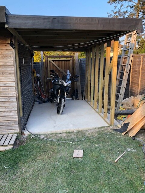

  1. Shed got to be the way to go
  2. Ohhh nice shed :)
  3. Whether a shed or open port (a lean-to shed would be my preference ;)) watch out for Planning Regs especially as you already have two more.
  4. Thanks
    Why is that your preference please?
  5. Well, a single plane lean-to roof falling away from the existing shed would be a lot easier to construct than a double pitch roof. And less likely to create water ingress problems.
  6. Shed, but I think the door may be a struggle with the space you have.

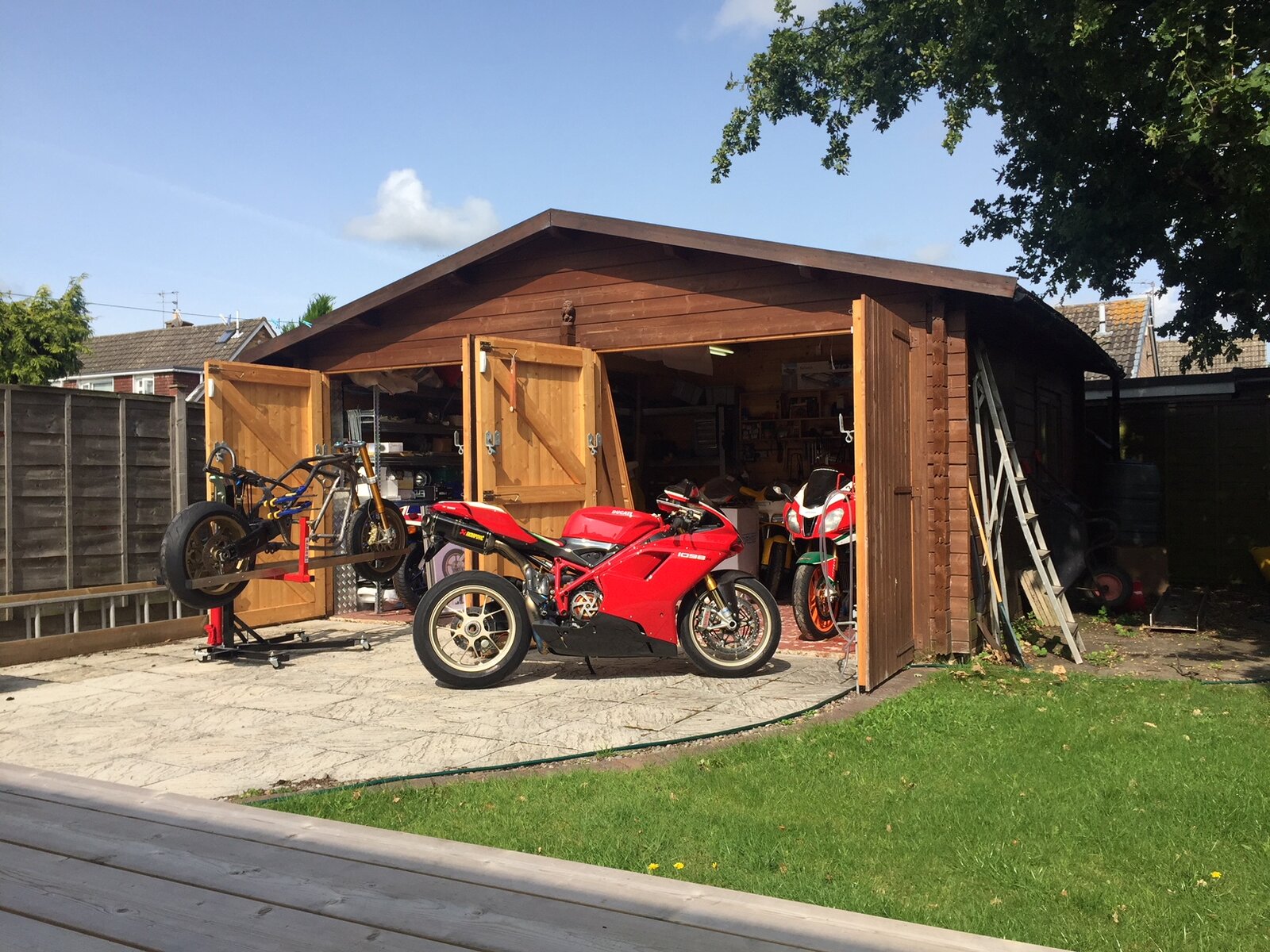

  7. I thought it was a garage*
    *technically, you thought it was a garage, I've always insisted it is a shed and @Exige agrees with me. He's an expert, you know.
  8. That won't be a garage as it can't fit a car in. That's how insurance companies differentiate between a shed and a garage. But you knew that already didn't you, you little button pusher you.

  9. I can fit 2 cars in, maybe 3

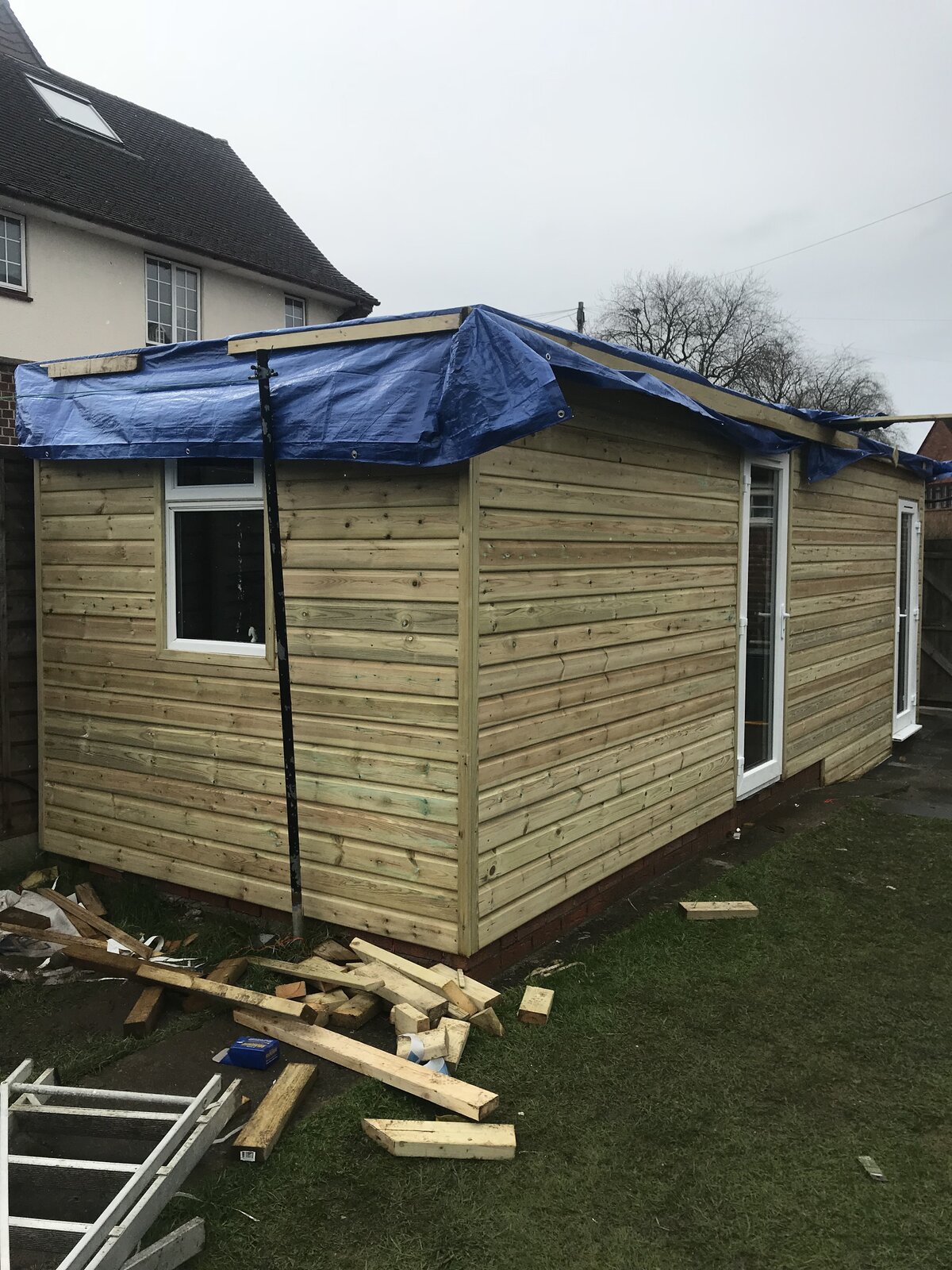

  13. I did read the rules before starting my first shed (5mx5m) I left a 1m gap to the fence (although I did later put a roof over that as a kind of extension to store the kids bikes), the second shed was a terrible brick shed that had been there since god was a boy, I kinda built the second shed inside it but extended it backwards 9m lol, this new shed/lean to, is next to the first and at the end of the garden, maybe 40m from the house, next to back fence/boundary, I seem to remember the rules saying it had to be below a certain height and distance from the fence and also not take up a substantial amount of the garden, I reckon there is plenty of garden left for the dog as the kids no longer leave their bedrooms.
    But! and its a big but, if you build it out of wood you can call it a temporary building, how long is temporary? and the height is from floor level, well if you pile a load of soil around it, what is the floor level? so IF any of my lovely neighbours ever complained (which I am hoping leaving stock pipes on my bike(s) will keep them happy? and we a really friendly with all of them) I will argue these points which as we know the wheels on the planning bus move very slowly, if I eventually lose, which I probably would, then Ill have a rethink after the temporary period expires hehe
  14. after that long explanation I figured id post some pics :)
    this is the only picture I have on this computer, during construction
    the second one extends further than the pic and looks a bit like a giant caravan, this was stolen from me by the angry teenagers and the wife, its half a games room and half a laundry room grr

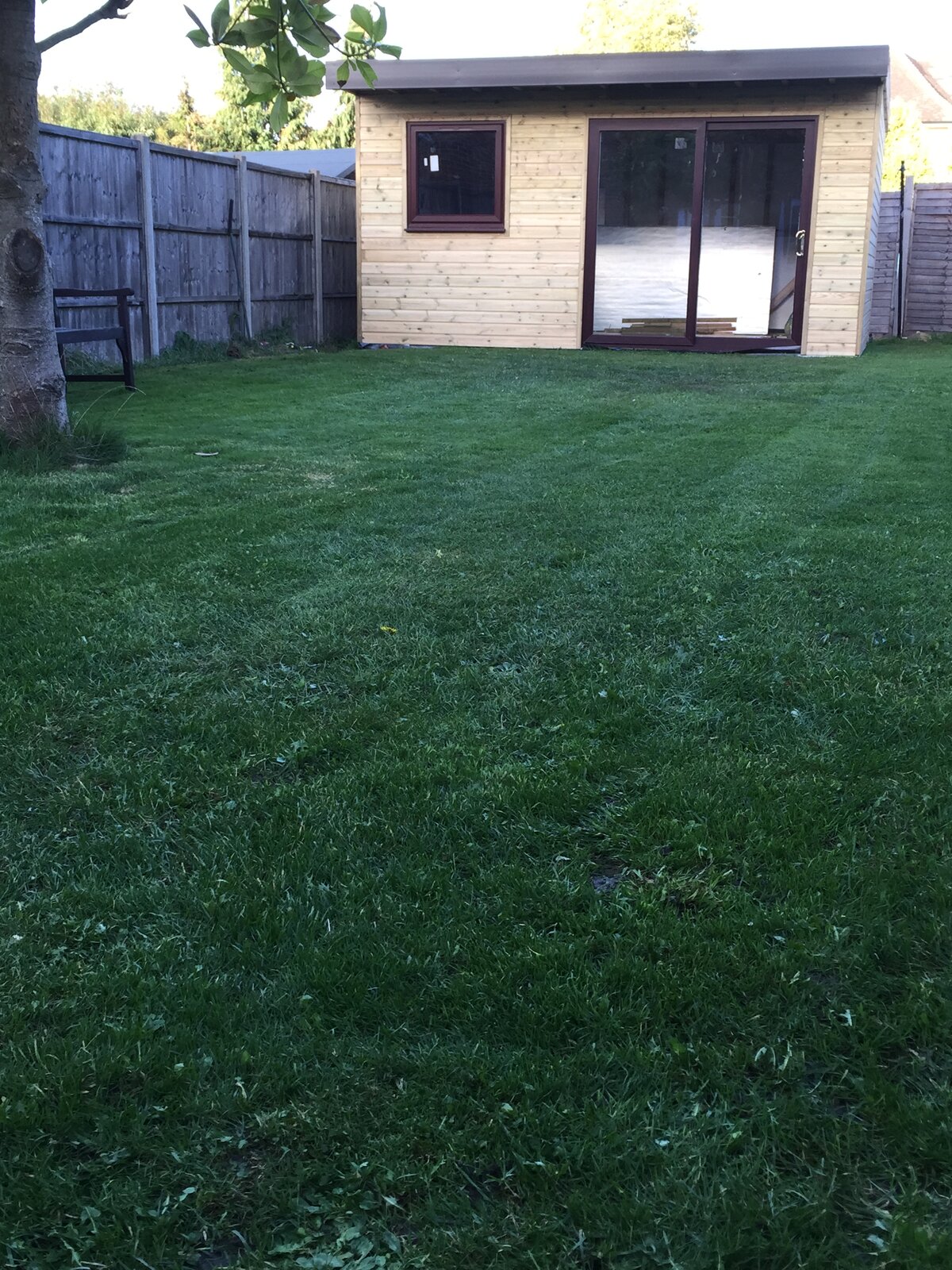

    Just because youve all been wondering/worrying about my shed/lean to
    Ive made it as a lean to that I can make into a shed if the mood takes me, the only thing stopping me making it a shed and knocking through is I will need a doible glazed door to maintain the warmth but I would have to drive over the door, any ideas?
  20. I have to say,not see diagonal noggins for a very long time as they're normally horizontal:thinkingface:.but it looks like you're moving in the right direction:):upyeah:
