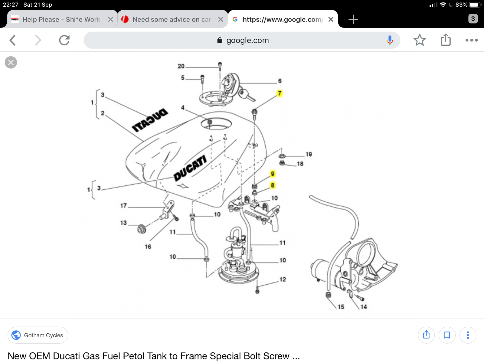

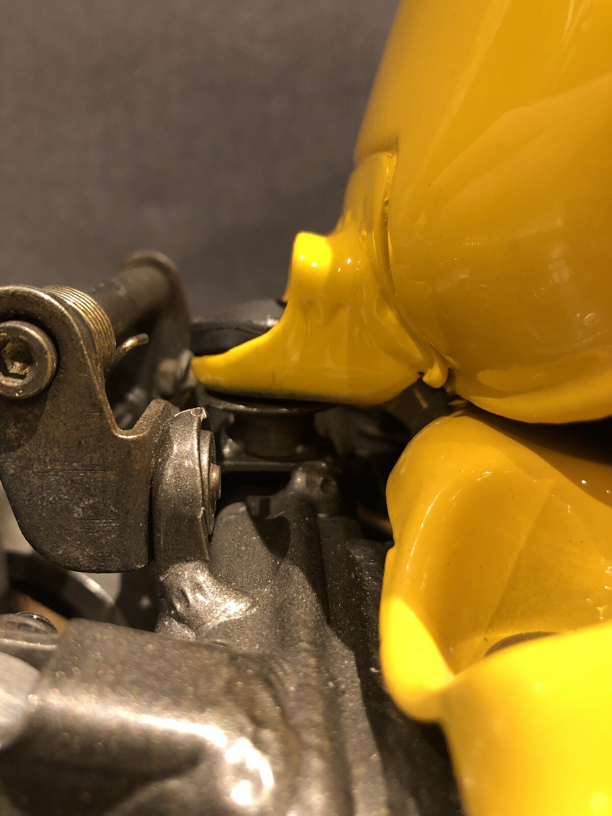

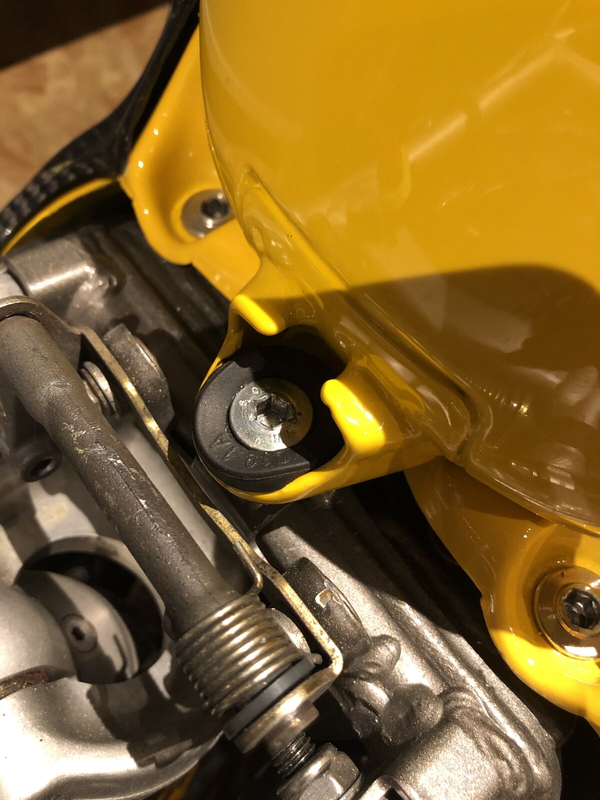

  1. Yep. The tank should be sitting on the rubber not directly on the metal frame.
  2. Cheers Paul.
    Thought as much, I’ve just turned it round and it looks a lot more like it should.

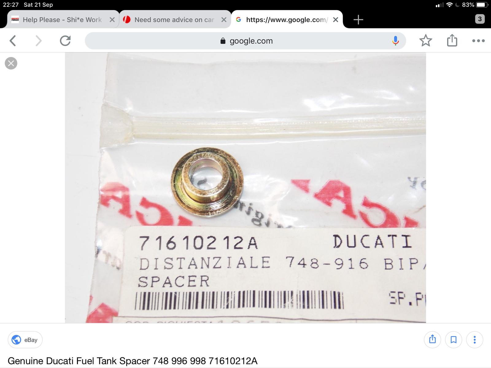

  3. There should also be a top hat spacer underneath the rubber
  4. I remember there being a bit on top and a metal sleeve running through it. So that’s not been refitted either
  5. 55357538-B0F1-4120-A1AD-5AF4F7ED5B1D.png 80E23791-74D0-423D-AE0E-B279B33AD721.png
  6. That’s the one! Amazing that they refitted it how they did. It doesn’t look anything like it should fit!
  7. Was their approved service centre something completely unrelated, like a DFS?
  8. You would think so by looking at it!
    I found the hose clip on the bottom of the tank loose and it has been spraying fuel into the airbox! Makes the fuel consumption glaringly obvious now, as I done a tank on a 90/100 mile ride! The only ride I’ve had of it since it came home.

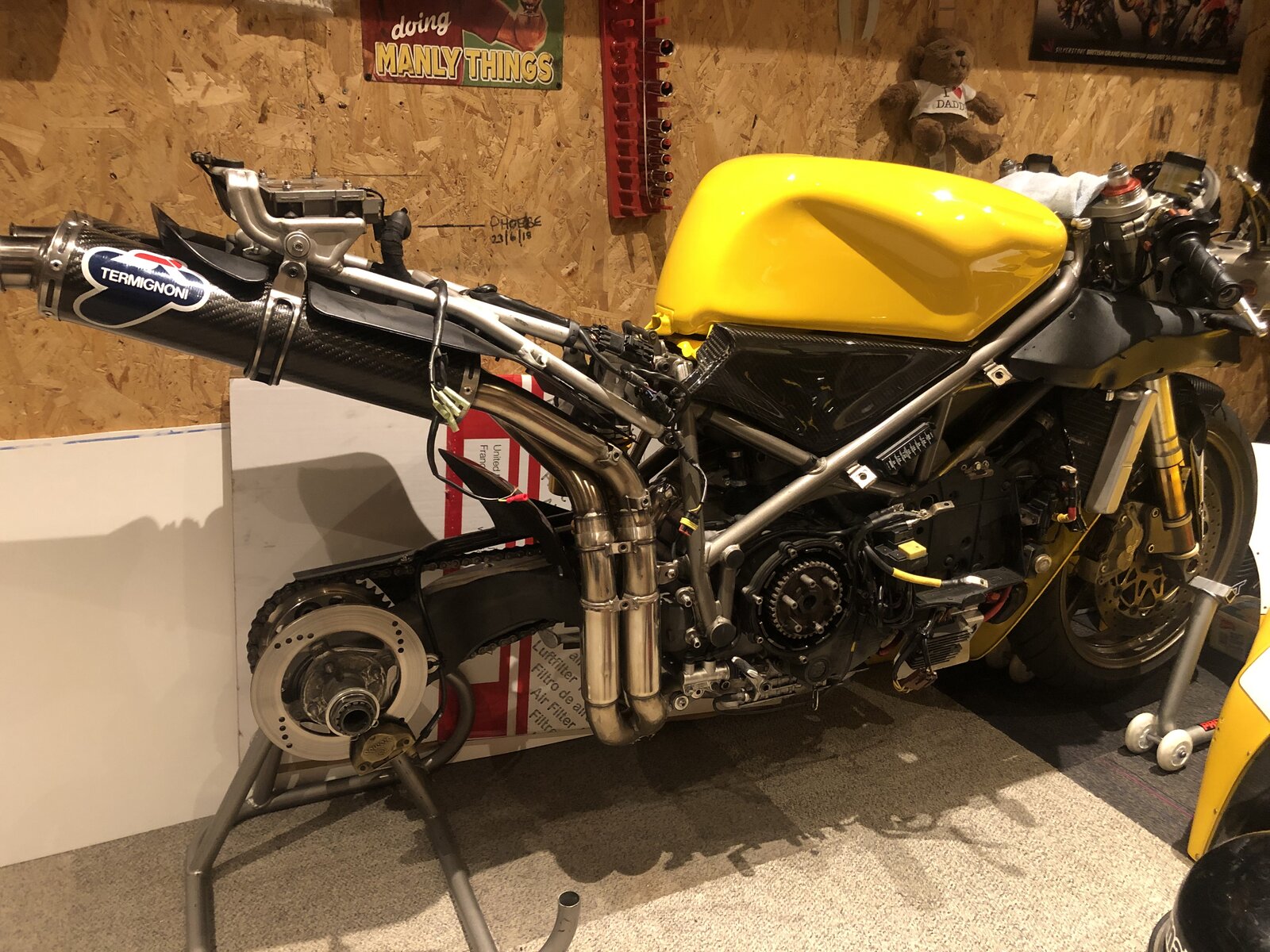

  10. I'll be putting the bike entirely back to standard, which should be a fun task!
    I was contemplating using the bike for track, but I would rather put it back to original and then possibly sell when finished next year.
    Seeing how values are widely different across the 748R range, it would probably be better off sold in standard trim without the Termis, carbon fibre and other aftermarket bits. Any opinions welcome!
