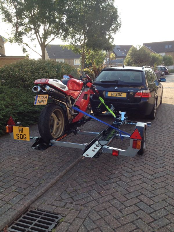

    Joining the discussion a bit late, but in case it helps. This setup worked for a European trip to Belgium and France. I did find the straps worked loose a bit, and just had to check them each time I stopped. For most of the trip I had a mate’s bike on the trailer too which helped balance things a bit and add a bit more weight. The front wheel clamp on this trailer helps a lot however, and so this strapping might not work without a similar front wheel clamp. Hope this helps.

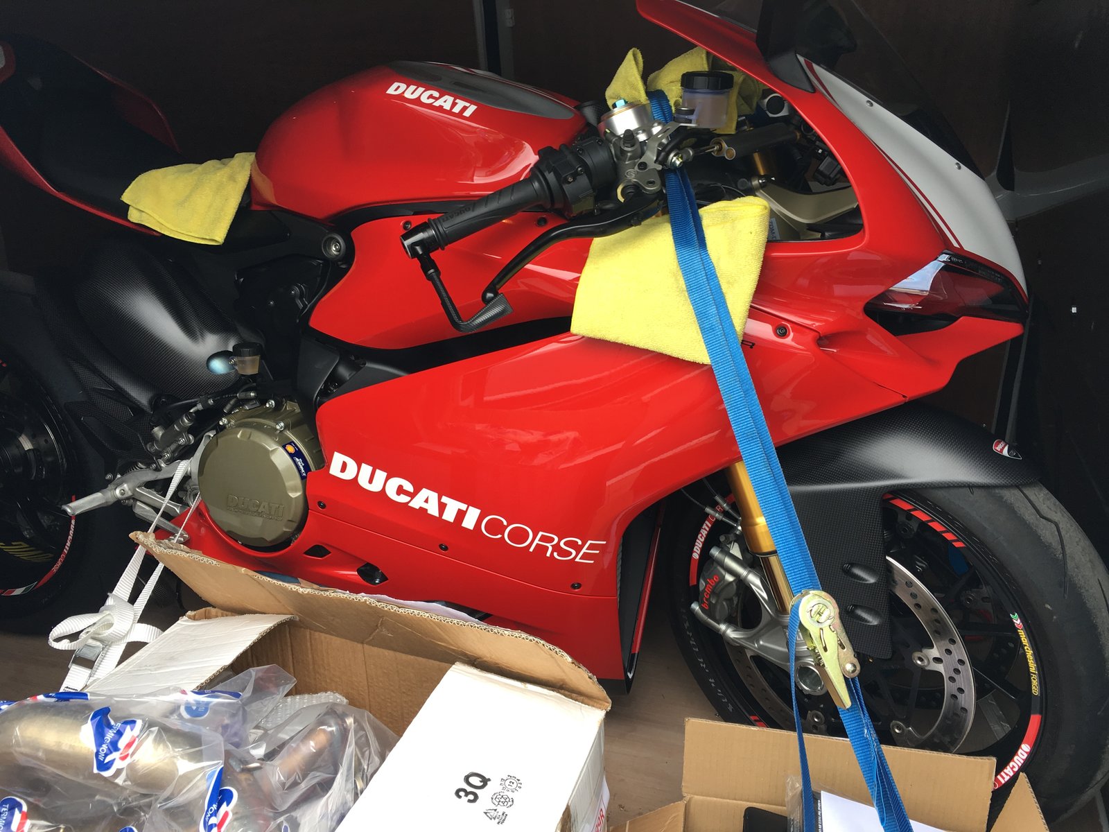

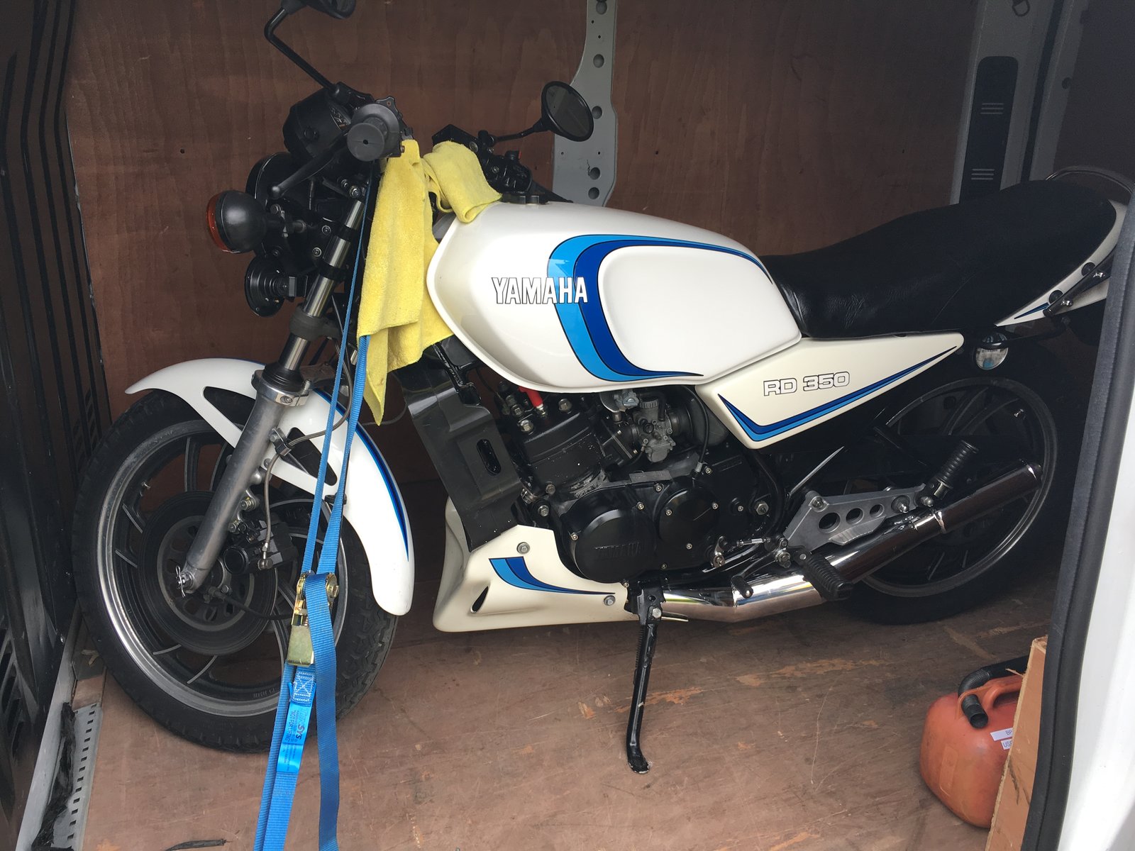

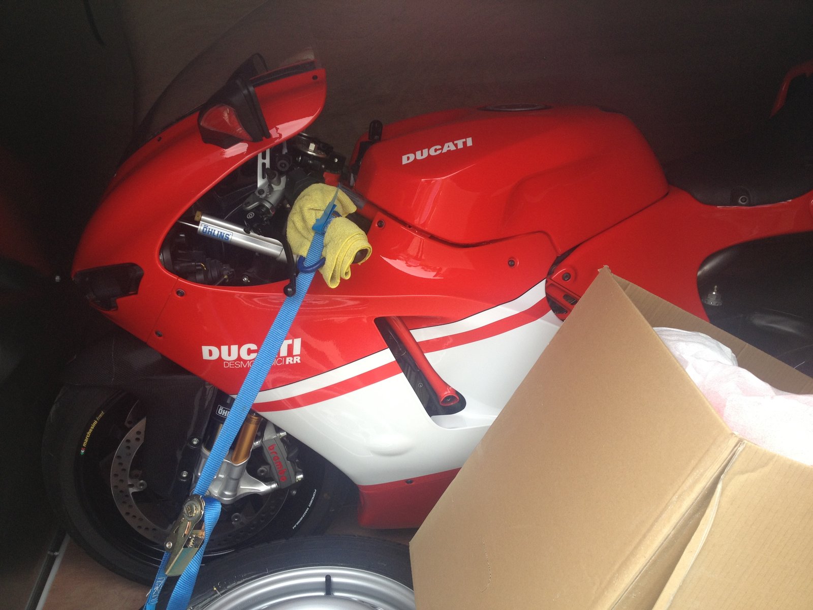

  2. I've always just used a couple of straps around the fork tops to the front corners of a van's loading bay hooks. If you see secondary straps in these pictures, it's because someone else did it whilst helping me :thinkingface:. Pulling the bikes front wheel into the bulkhead (usually straight on, but sometimes on lock) and compressing the suspension slightly. I only give the straps a couple of clicks past where they become taught, not yarking them down. I had a friend blow a seal on the Ohlins of an Aprilia RSV after pulling the thing down to the floor. I use microbibre cloths to protect paintwork on anything that's rubbing, and if a strap is seriously pushing against a panel, I'll relocate it (as shown on the Desmo, where I went around the bar). I've never had a bike go walkies yet and I've done this from one side of the country to the other. :upyeah: I always recheck 5 mins after setting off though for piece of mind. :yum

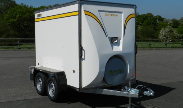

  5. It is in there, honest..
