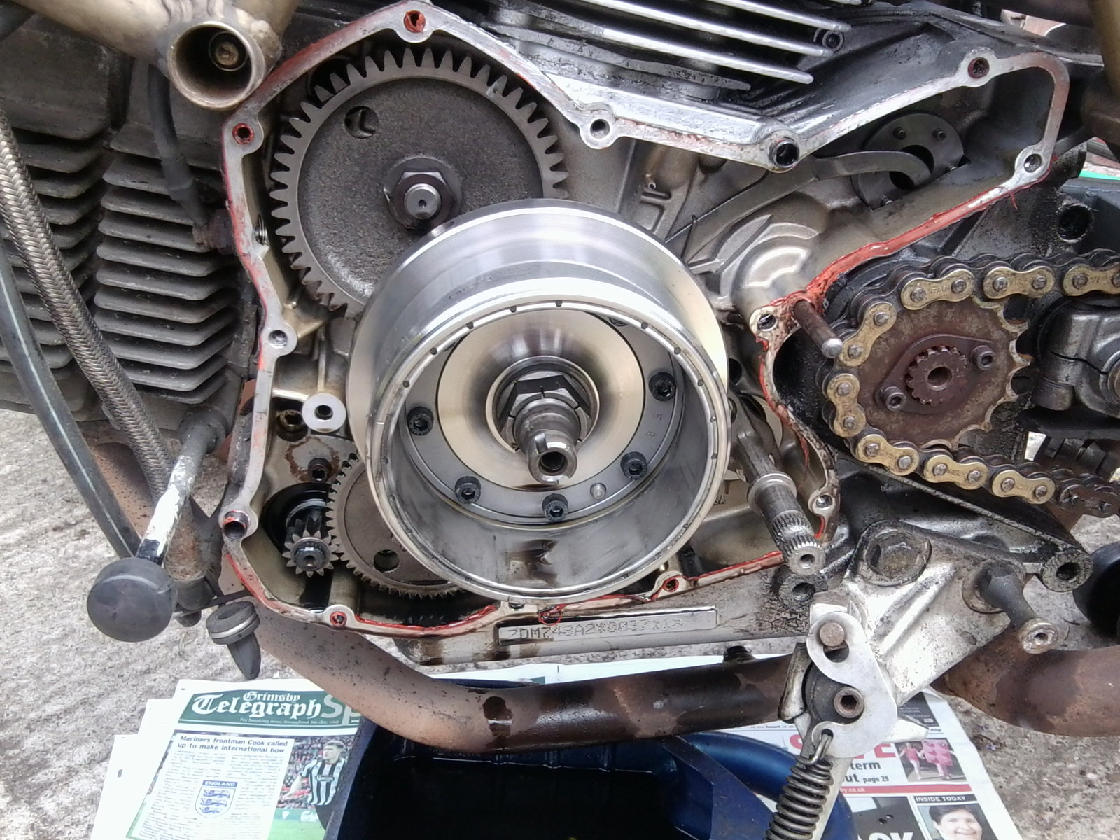

  10. here is a picky of what is on my side stand was on the bike when I got it
