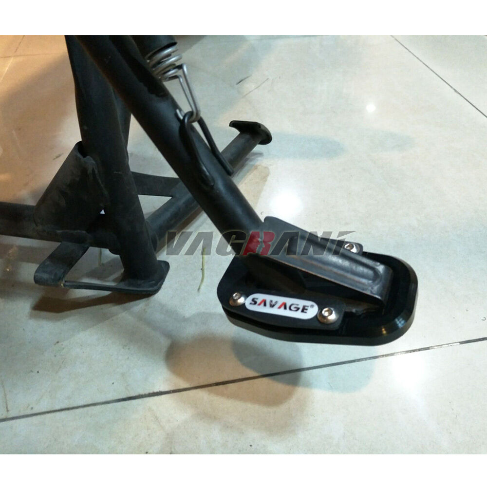

  9. The lean angle is not great for me, especially when the bike is loaded up, it's not bad, just not great.
    I purchased a sidestand foot £11 from ebay. It supported the bike through several days of heavy rain when camping in a field on the Isle of Man last week.
    I flipped over the top plate so the logo was hidden and used threadlock on the fasteners. For the money, it does the job well.
    Item no: 322711481503
