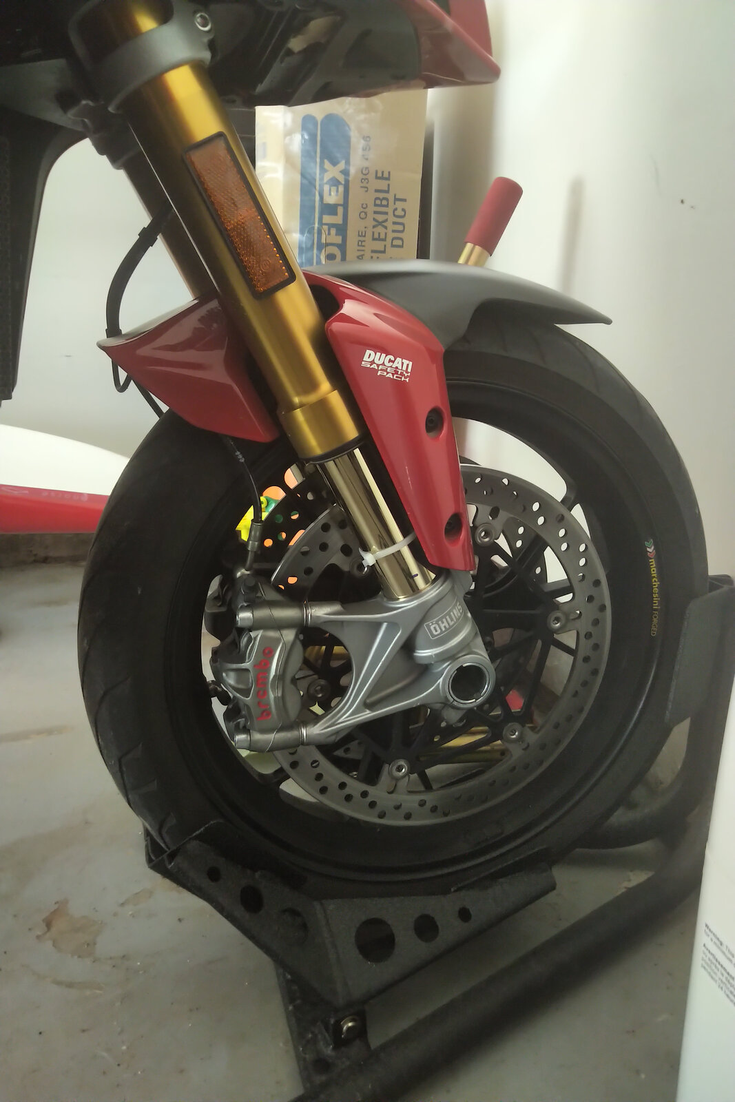

  13. I'm not too secure about the side-stand either. There was a recall a few years back for the 1260 which was done but not sure if it was the leg or the bolt. Anyways, I don't use it if I don't have to. I park the bike on a wheel chuck.
