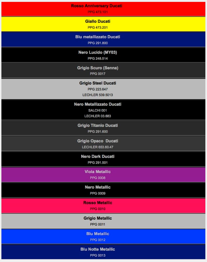

  3. Feeling really naffed off and not very happy with Ducati. I have been informed by Ducati UK (they have been great and very helpfull by the way) that the Ducati factory cannot supply any further information as to the paint or even the paint code that Ducati use for the engine crank/clutch casing on the Multi Enduro.
    I've manged to locate the company that supply the paint to Ducati (Inver) but they do not sell to the public but have a distributor here in the UK. However, the UK distributer also doesn't sell to the public. I've contacted several auto paint manufacturers and they want to help but cant because they need a paint code. For example LECHLER, PPG or Pantone. The paint code Inver use is their own in-house code so nobody apart from themselves now how the paint is made up.
    Don't get me wrong I know that bikes do become scratched or damaged through general use but surely the manufacturers have a responcibility to their customers (especially ones at costing £16K+). I want to get this repaired before the UK Winter starts rusting and ripping the bike apart. Maybe I was expecting a little more from Ducati but I'm not overly impressed with their customer service. I feel really let down by them but hey ho I guess thats how it goes.
    I'm now scratching my head wondering what I should do next. Any thoughts from fellow forum members would be greatly appreciated. Sorry for having a moan so rant over.
