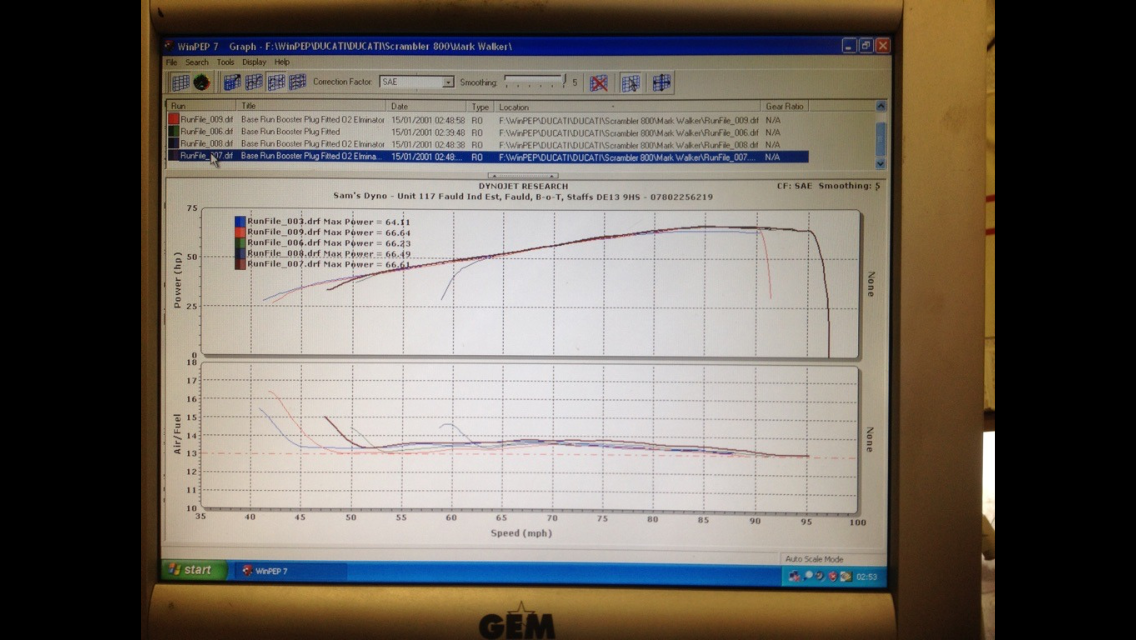

  9. Yes, provided you don't change anything after it has been set up I.e. Change the air filter, what isn't making sense though is your dyno shows a lean condition at higher revs, that's where the closed loop system should adjust the AFR back to safe levels regardless of changing the exhaust, so off the top of my head there's a few possibilities.
    1. There's a fault with the Dyno (poorly calibrated)
    2.there's a fault with the Lambda sensors.
    3.the arrow exhaust is so poorly matched to the bike that when the ECU goes back to the standard map closed loop even its richest map can't compensate for the exhaust.
    Ideally you could take the bike back to the Dyno with the OE can fitted, do a run, then fit the Arrow can and do another run and compare the results, depends how much messing about you want to do!

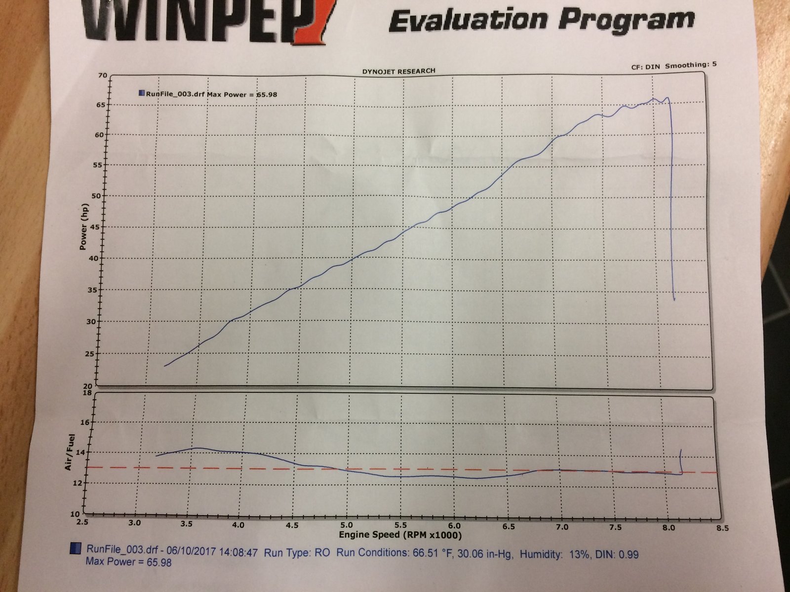

  11. Decided to have my bike run again on a different Dyno, I am happier now, the results seem to be good.
    • Dyno.pdf
      File size:
      423.2 KB
      Views:
      534
    Yes, fuelling looks very similar to mine , they run lean, most bikes do now, here’s my dyno, Scorpion exhaust, no other mods.

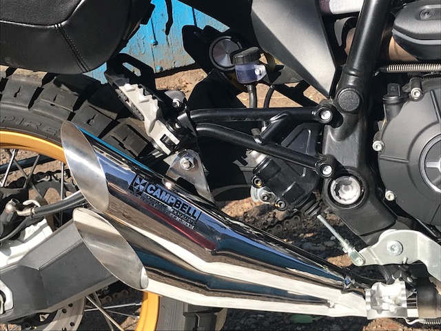

  13. I have just had a bespoke stainless exhaust made for my Sled by John Campbell exhausts. It looks cool pick it up tomorrow review to follow:
  14. It looks like a quality fabrication and blends in well:upyeah:
  15. Just collected the bike, What a difference!!! great sound not too obtrusive but sounds as a Ducati should. Performance and running unaffected and whilst these things are "personal opinion" looks stunning. John and Dave at Campbell exhausts have hand made this for me at a a fantastic price when compared to some after market exhaust suppliers. They can now make these exhausts from the pattern and have a couple of other designs.

  17. You tube video of sound doesn't do it justice it sounds just right.
    I'll do one without baffles to.
    John also does the exhaust in matt and black as well as in a sidewinder and pepper pot style.

  19. Hi,
    The stock pipe on my DS drives me nuts at stops me placing my oversized feet square on the pegs. Does the Campbell option give your right foot more clearance ?
    Also dare I ask how much one of thos babies costs ?
    Cheers
    Nick W.
