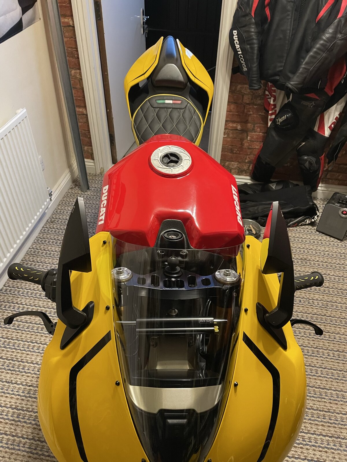

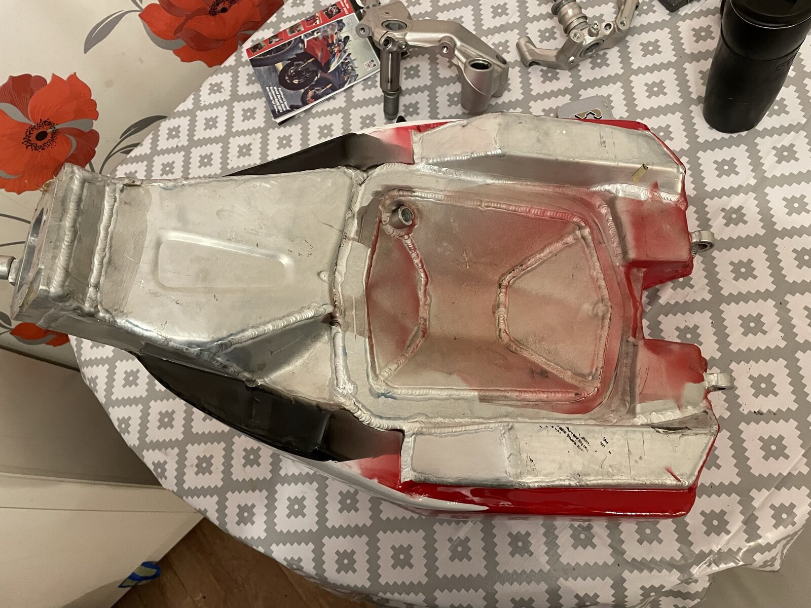

  1. Test fitted the new to me Tamburini Factory alloy 21 Ltre tank to make sure it fitted right before getting it wrapped / painted. Fits great and sat on the bike, the width makes it easier to grip.

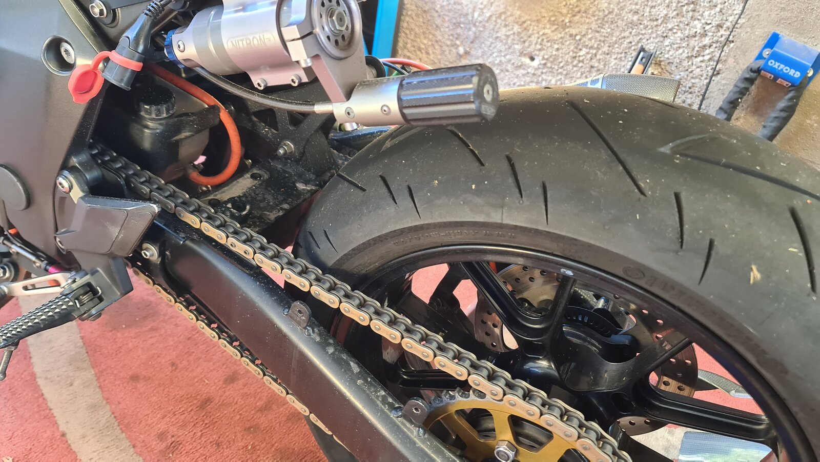

  2. Made a start cleaning the zed....don't laugh at the sidewalls on the rear tyre it's only real job at the moment it 2 miles to work in shitty weather....on the electric board when it's dry...

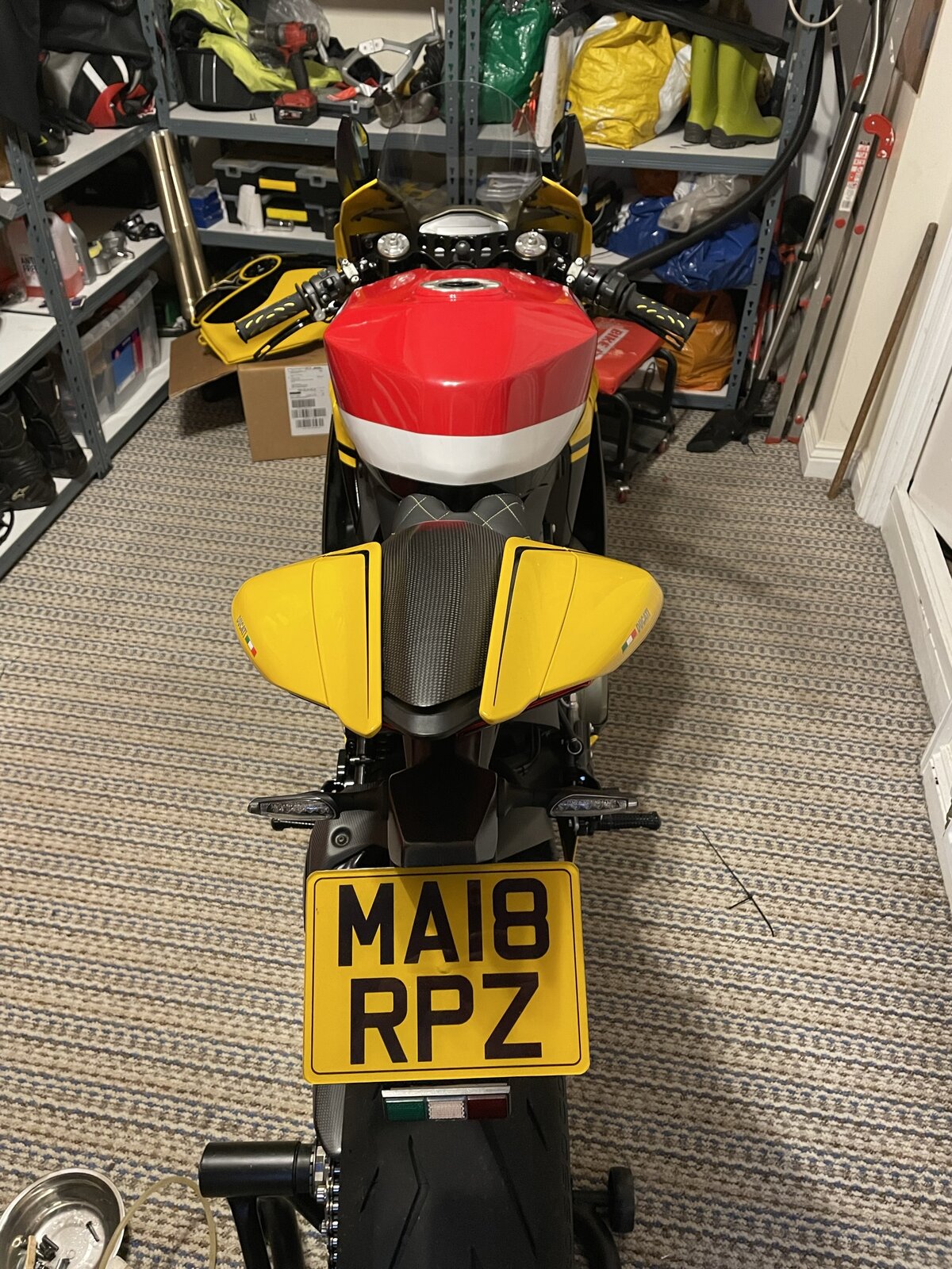

  3. What about when you're riding at night, your rear light fails and you don't realise? How about when your bike is parked on a road at night?
    Its a pretty sensible law.

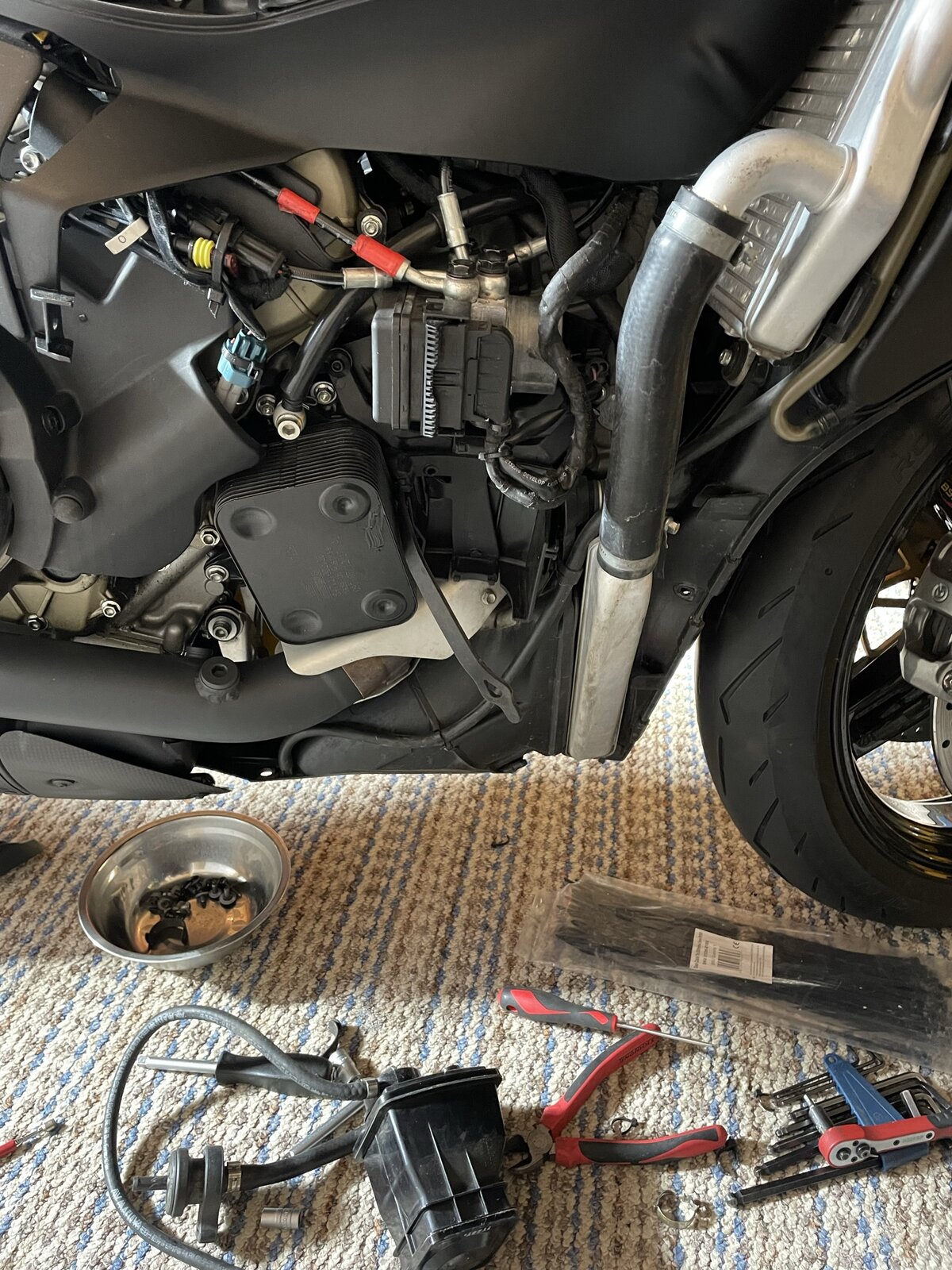

  4. So, after adding all these new trick bits, thought it about time I started removing stuff not needed as all the Euro 5 crap has been turned off at the ecu. First on the list and well overdue is the Evap canister and it’s purge valve. Job made even easier as there’s only one tube to cap off now as the new tank hasn’t got the little overflow or breather tubes on the bottom.
    Next on the list are the Lambda sensor and secondary air flow cables and tubes.

  7. Those are very rare scenarios. But if having a reflector gives you peace of mind, then go for it.

  9. Well if you tour/ holiday with your bike, its possibly parked outside pretty often. Electrical failures on Ducatis is not a rare thing either.
    I'm not sure whether there is fine for not displaying a rear reflector, I do know its a legal requirement. I think the police can issue a rectification notice for a minor fault on your bike, but if there are 3 defects I think it becomes a bigger issue. So loud pipes, small plate and no rear reflector...
    4. Lamps, reflectors and electrical equipment
    Headlamp, position lamps, stop lamps, direction indicators, rear registration plate lamp, rear reflector and direction indicator ‘tell-tale’ rules and inspection for motorcycle MOT tests.
    4.8. Rear reflectors
    4.8.1. Presence, condition and operation
    You must only inspect the one mandatory rear reflector on a solo machine, or 2 on a motorcycle combination.
    Motorcycles must have one red reflector aligned to the longitudinal centre line and positioned to reflect squarely to the rear. On motorcycle and sidecar, the sidecar must also have a reflector fitted towards the outer side and positioned to reflect squarely to the rear.
    Rear reflectors are not needed on motorcycles that:
    do not have front and rear position lamps fitted
    have such lamps permanently disconnected, painted over or masked
    Reflective tape is not an acceptable substitute for a rear reflector.
    Defect Category
    (a) Reflector defective or damaged:
    (i) by up to 50% of the reflecting surface
    (ii) by more than 50% of the reflecting surface
    Minor
    Major
    (b) Reflector:
    (i) not securely attached
    (ii) likely to become detached
    Minor
    Major
    4.8.2. Compliance with requirements
    You must inspect mandatory rear reflectors.
    Motorcycles must have one red reflector aligned to the longitudinal centre line and positioned to reflect squarely to the rear. On motorcycle and sidecar, the sidecar must have a reflector fitted towards the outer side and positioned to reflect squarely to the rear.
    Rear reflectors are not needed on motorcycles without front and rear position lamps or have such lamps permanently disconnected, painted over or masked.
    Defect Category
    (a) Reflector:
    (i) colour or position not in accordance with the requirements
    (ii) missing or reflecting white to the rear
    #3429 Jez900ie, Oct 2, 2022

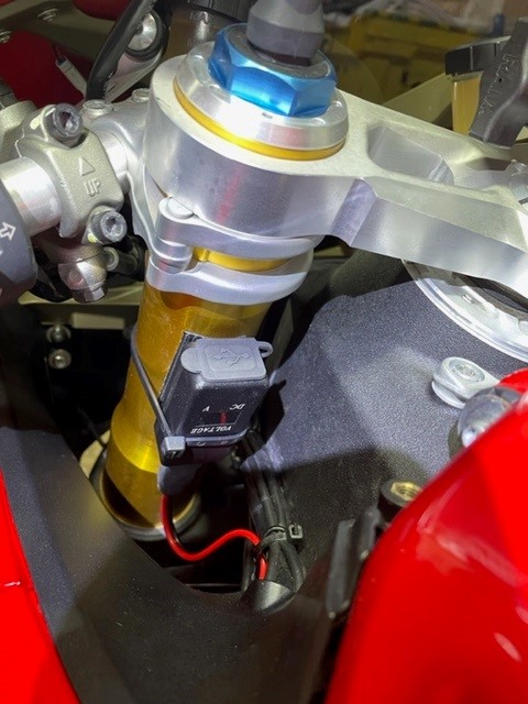

    2xUSB socket fitted to power my iphone and recharge my dildo on a quadlock mounted ram ball to centre yoke. 5V transformed supply and fused. Oh and waterproofed.
    Pain to find a place to locate it. Ended up mounting it to rear of lhs front fork via velcro (to act as a soft buffer) and a zip tie for now. This means it doesnt foul when on full lock.
