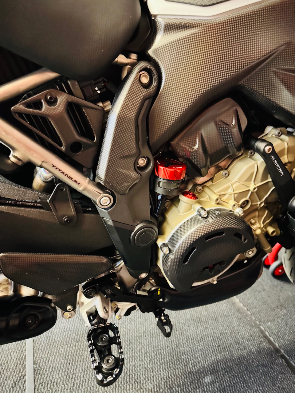

  3. Fitted some carbon to the new bike. I’m waiting for a PPF kit to arrive, which should be here by the weekend. I’m desperate to ride the bike, but it’d be Sod’s Law that I pick up a stone chip or two before fitting the film, so might wait until I’ve done it, before going out for a proper ride.

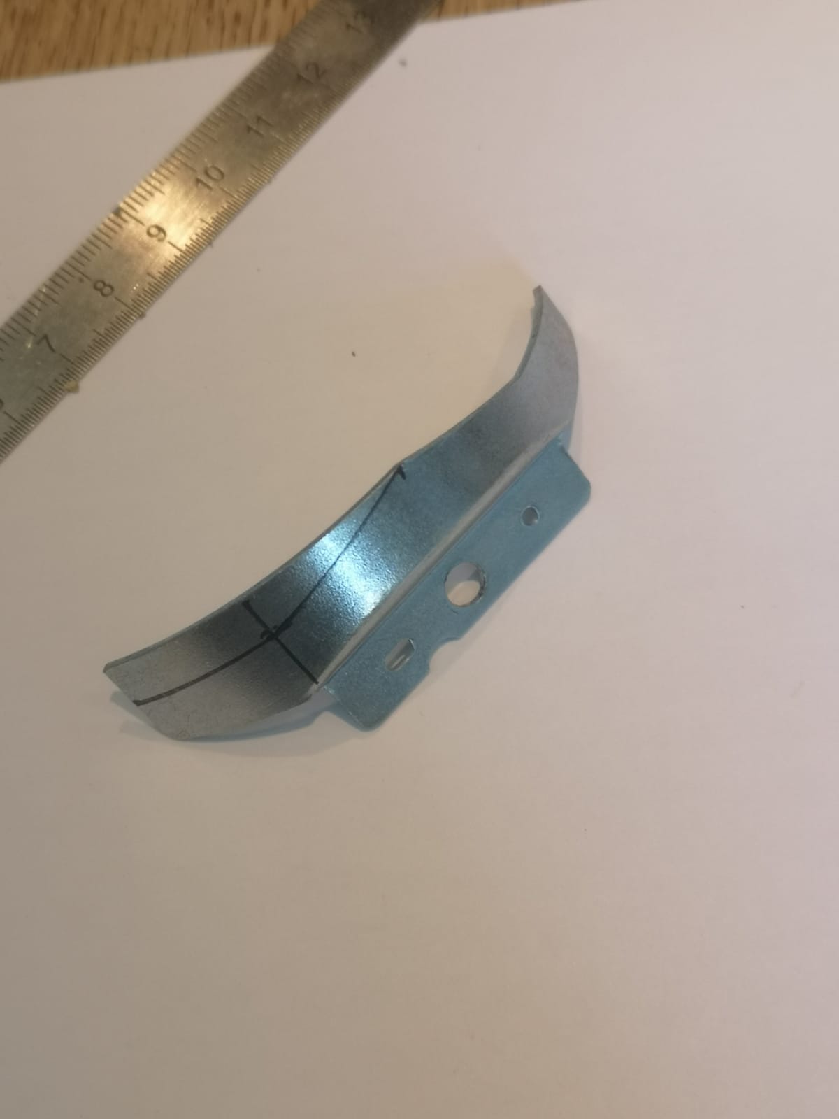

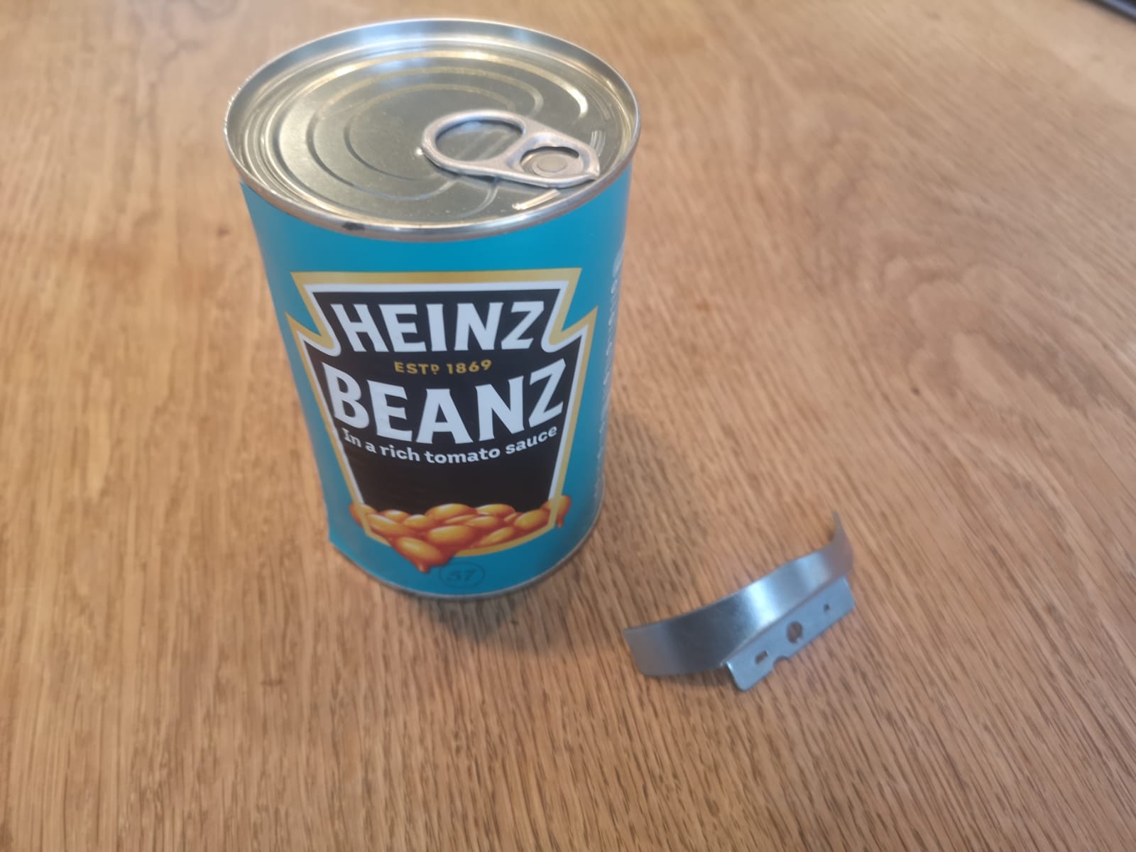

  4. Finally got around to looking at my 996 to get a European certificate of conformity (for France)... means I need to have the original exhausts, a 100hp Eprom, and dipped lights that face the opposite way to the UK...
    Was going to make the dipped "filter" out of a bean can...

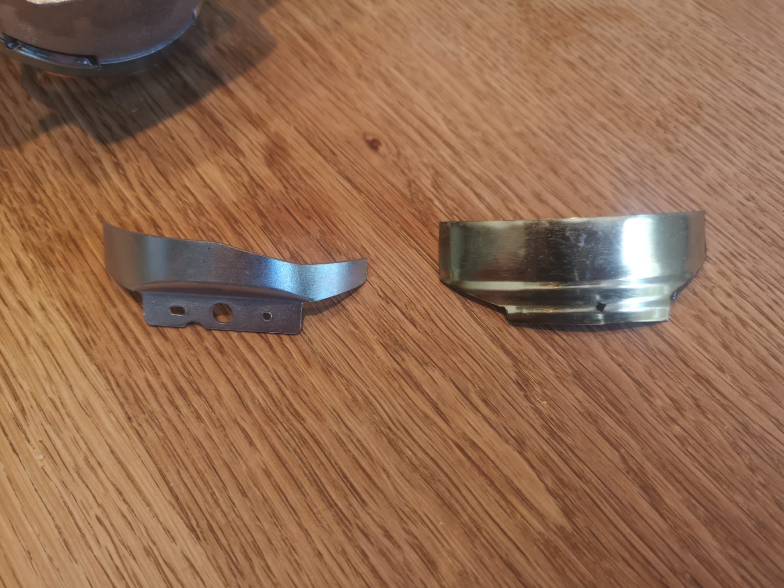

    but on cutting the can up I started to have a better plan...

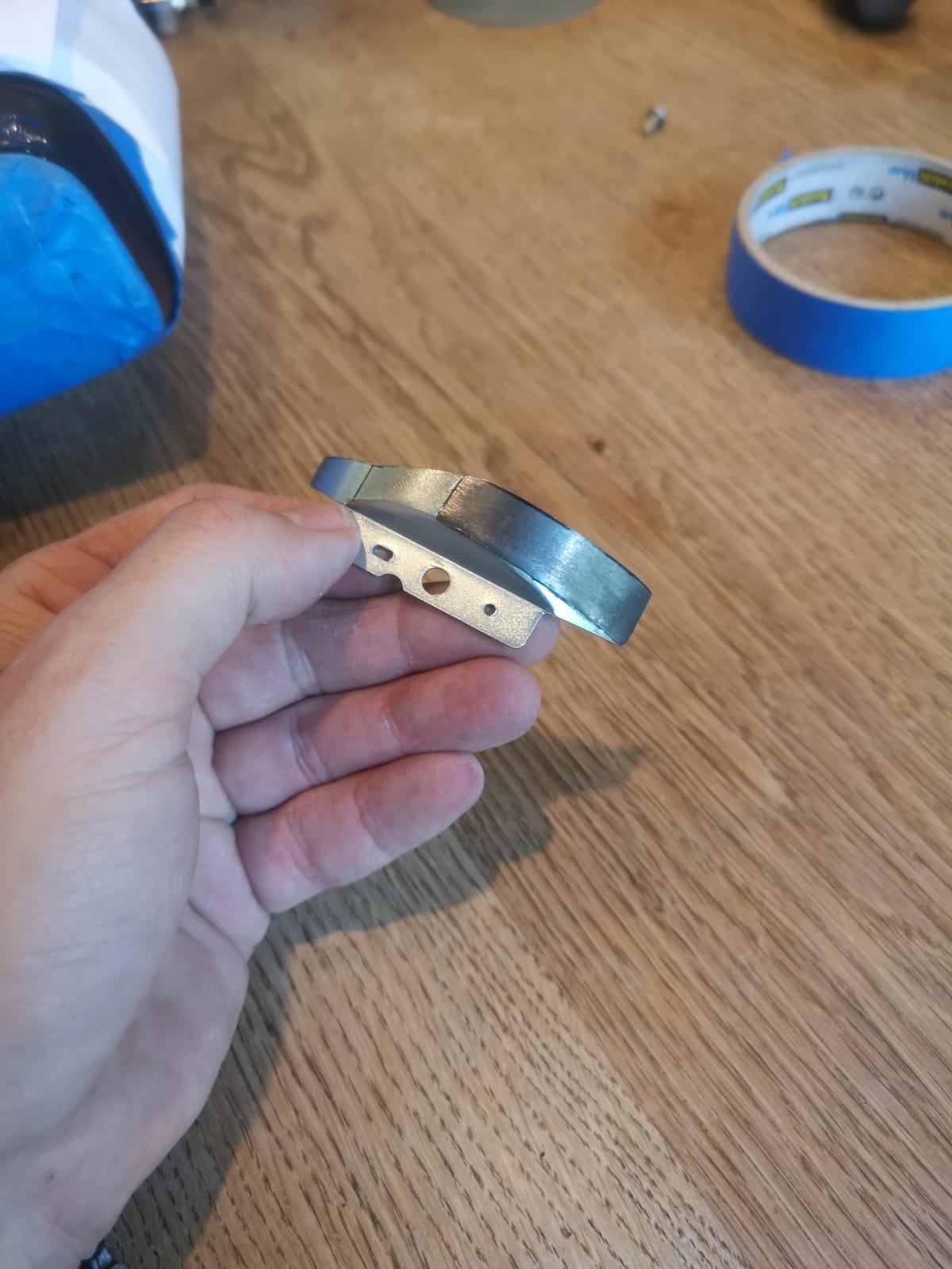

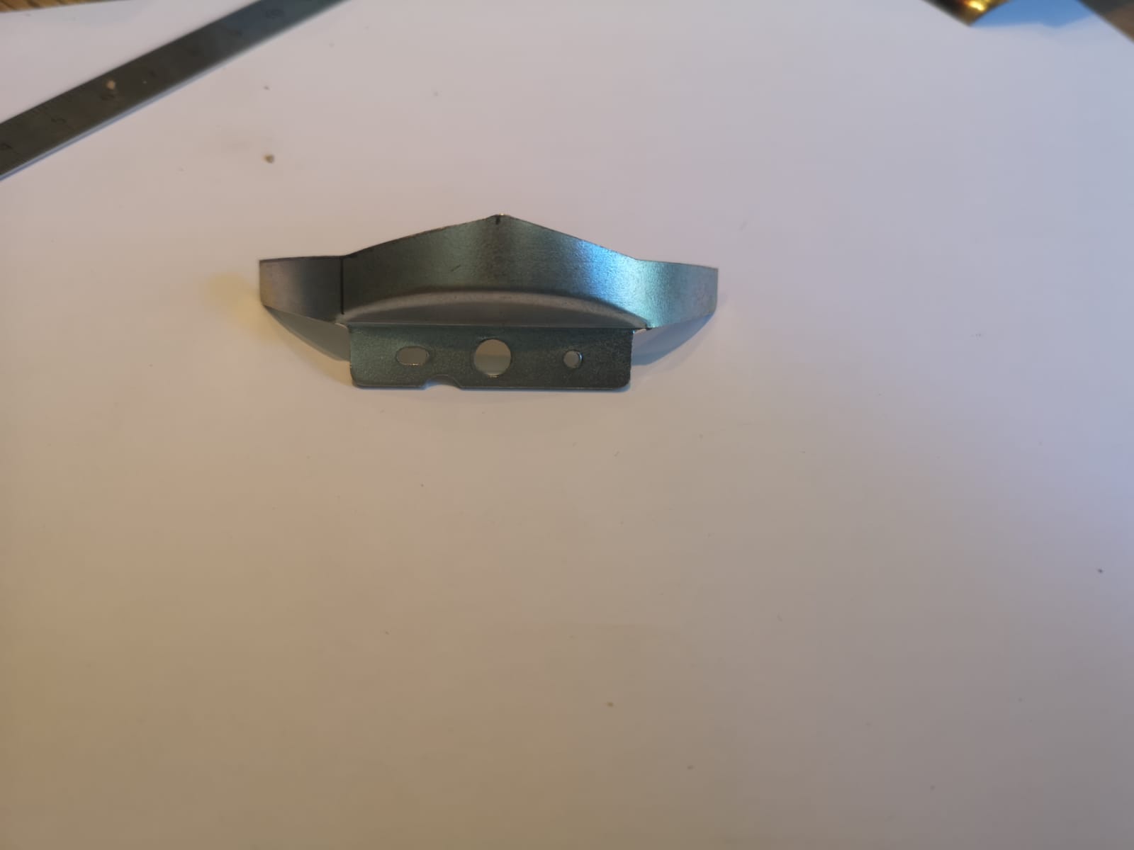

    Which was to cut down the left-hand side of the "filter" I already had, then build up the RHS...
    Voilà...

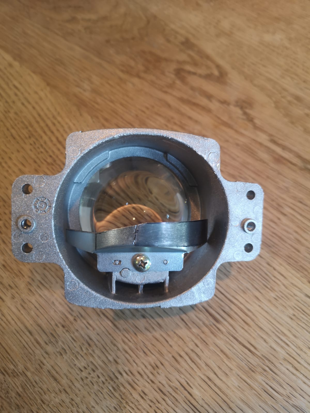

    I then Araldite-d a bit of the bean can to build up the other side! (150deg C usable opp. temp - so should be ok)
    Bosh...sorted!

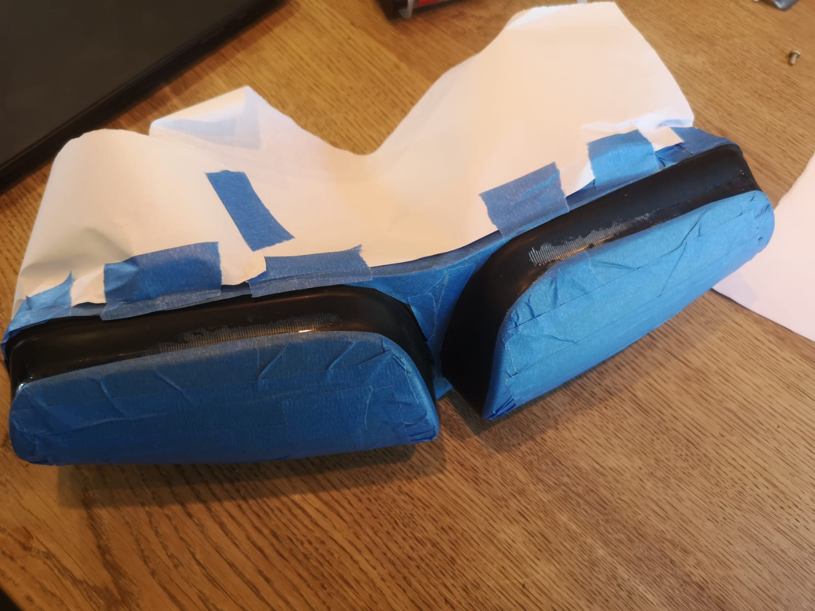

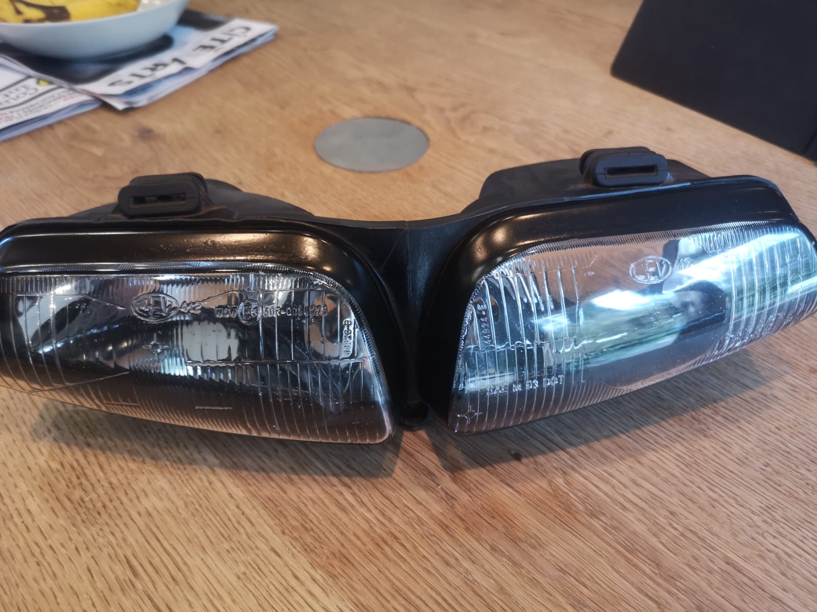

    and as I was in there, I re-painted the black mask on the lenses and de-fogged the inside. Successful day again. :D

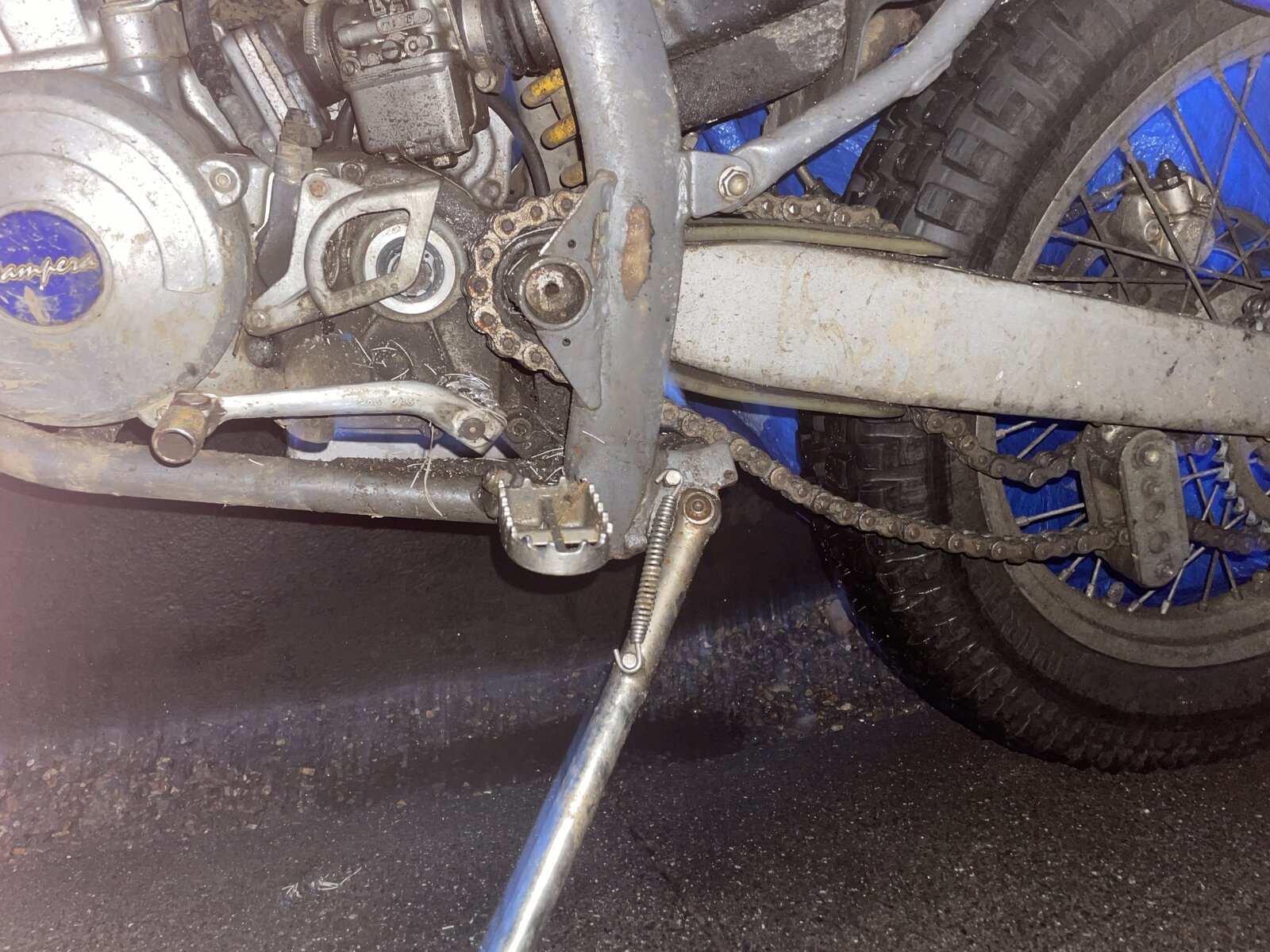

  9. Ordered new chain and sprockets for my Trumpet scrambler and enquired about a Roadlok for my 1098.

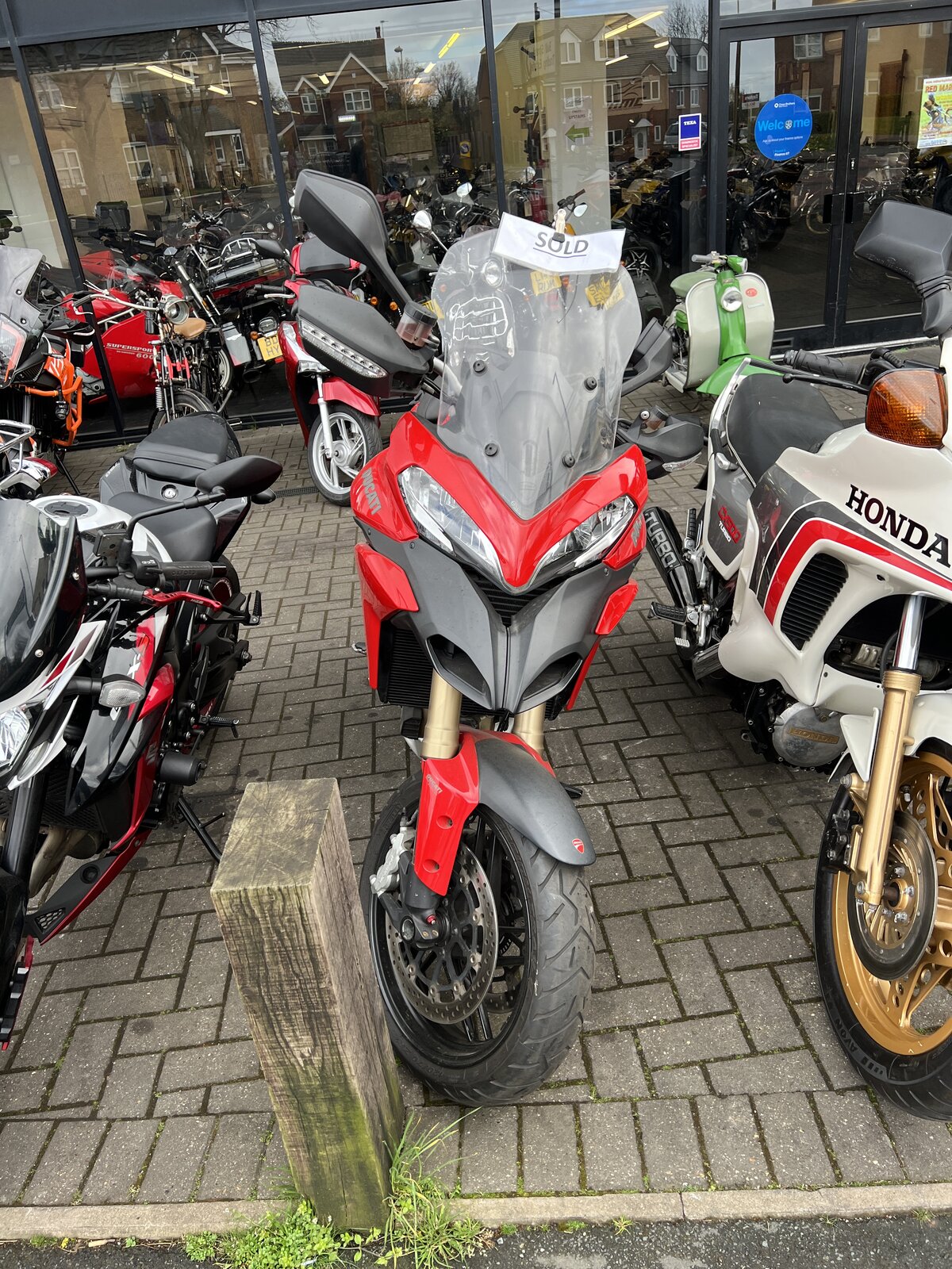

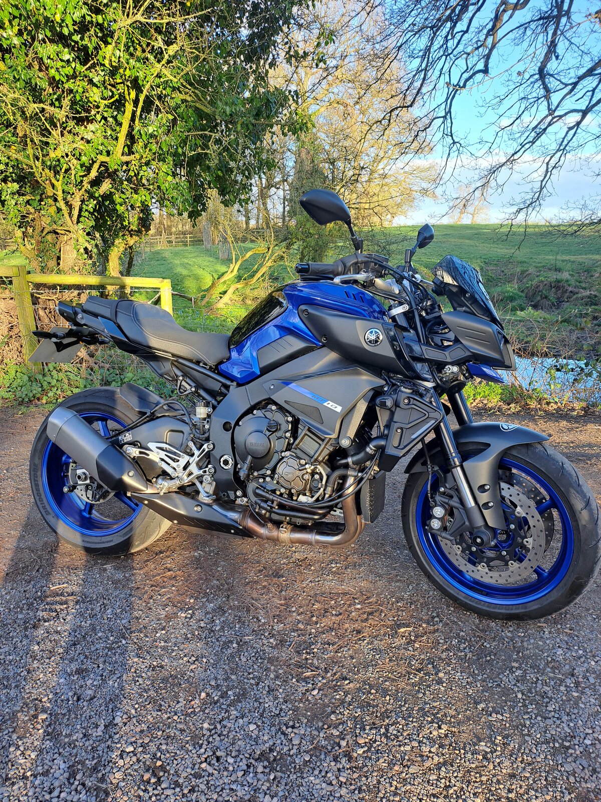

  14. Fitted a new air filter to my MT10.. Then took it for a short run to see if I really do want to sell or keep it a while longer.
    The ride didn't help the decision : unamused:
