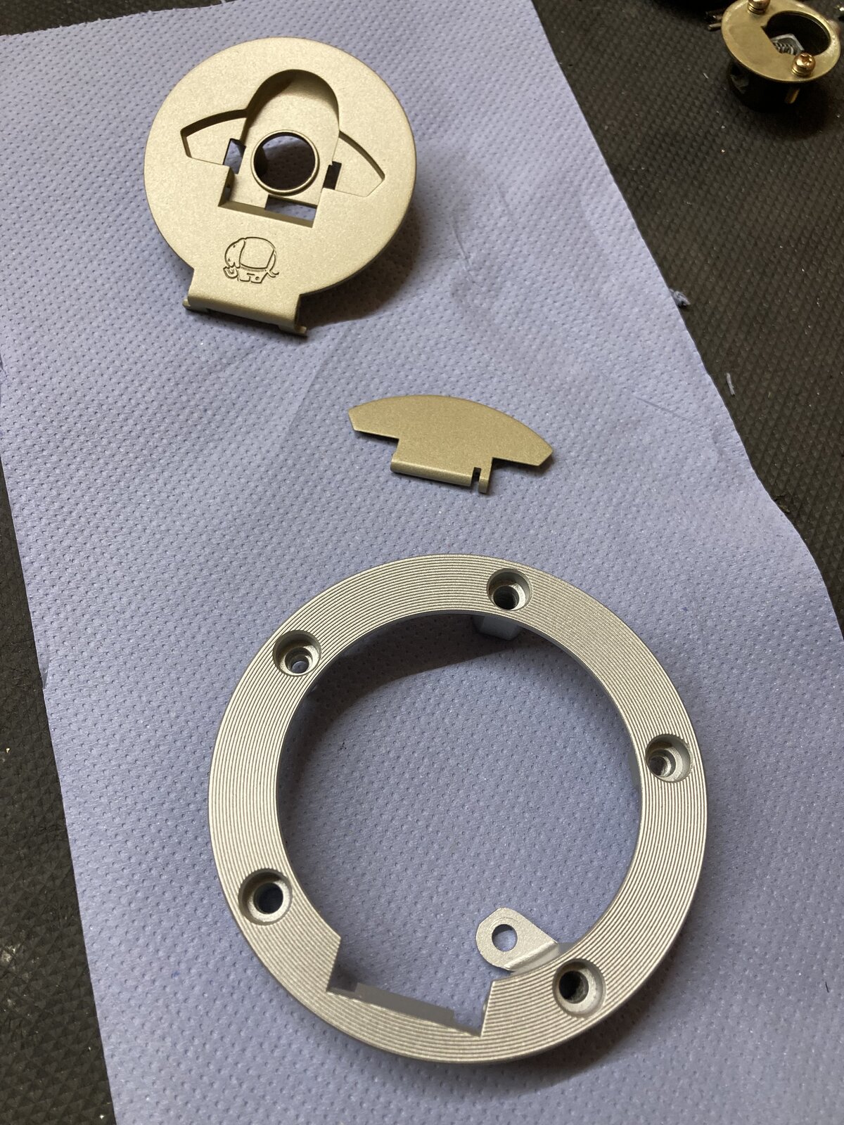

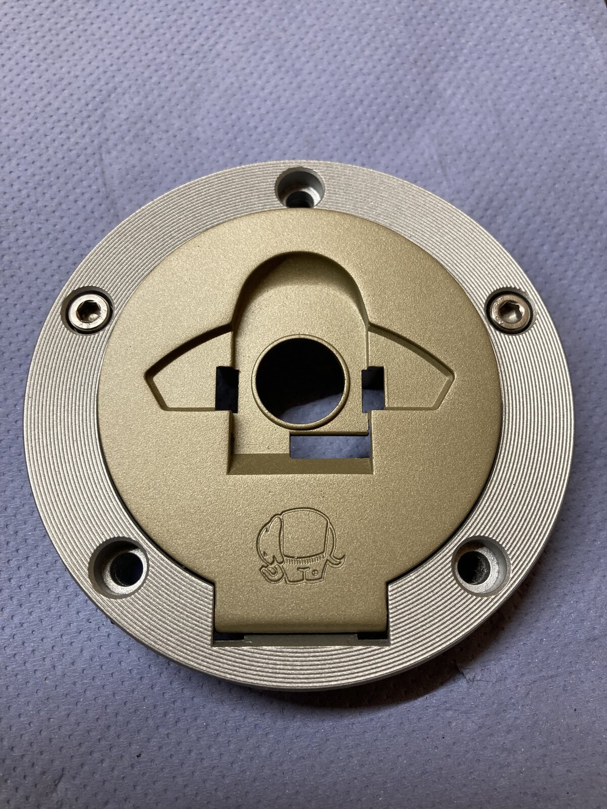

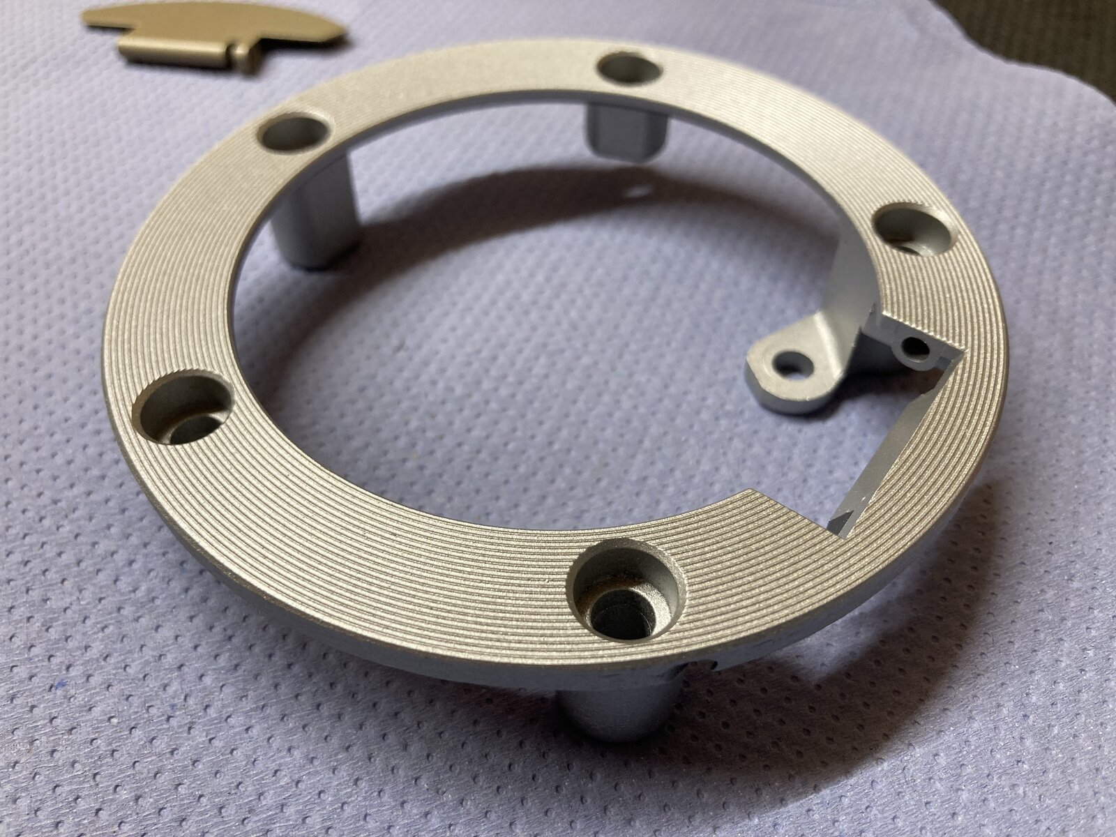

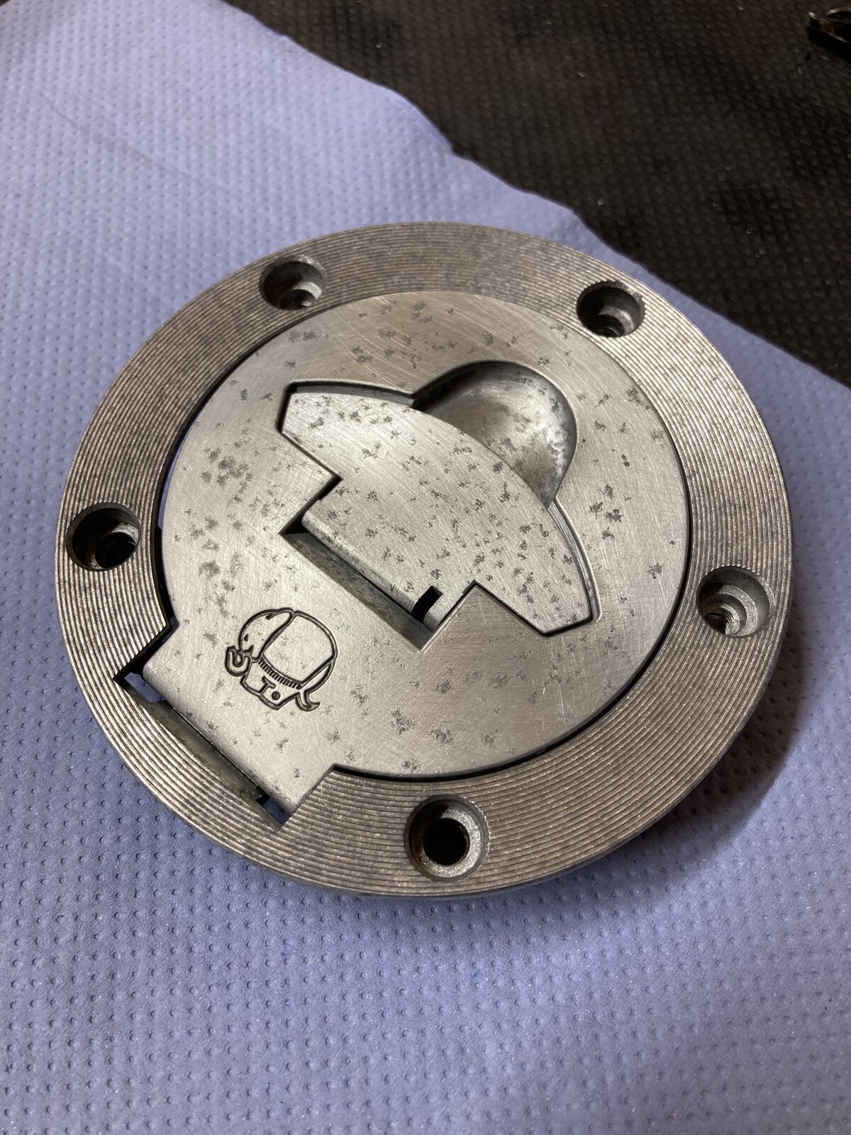

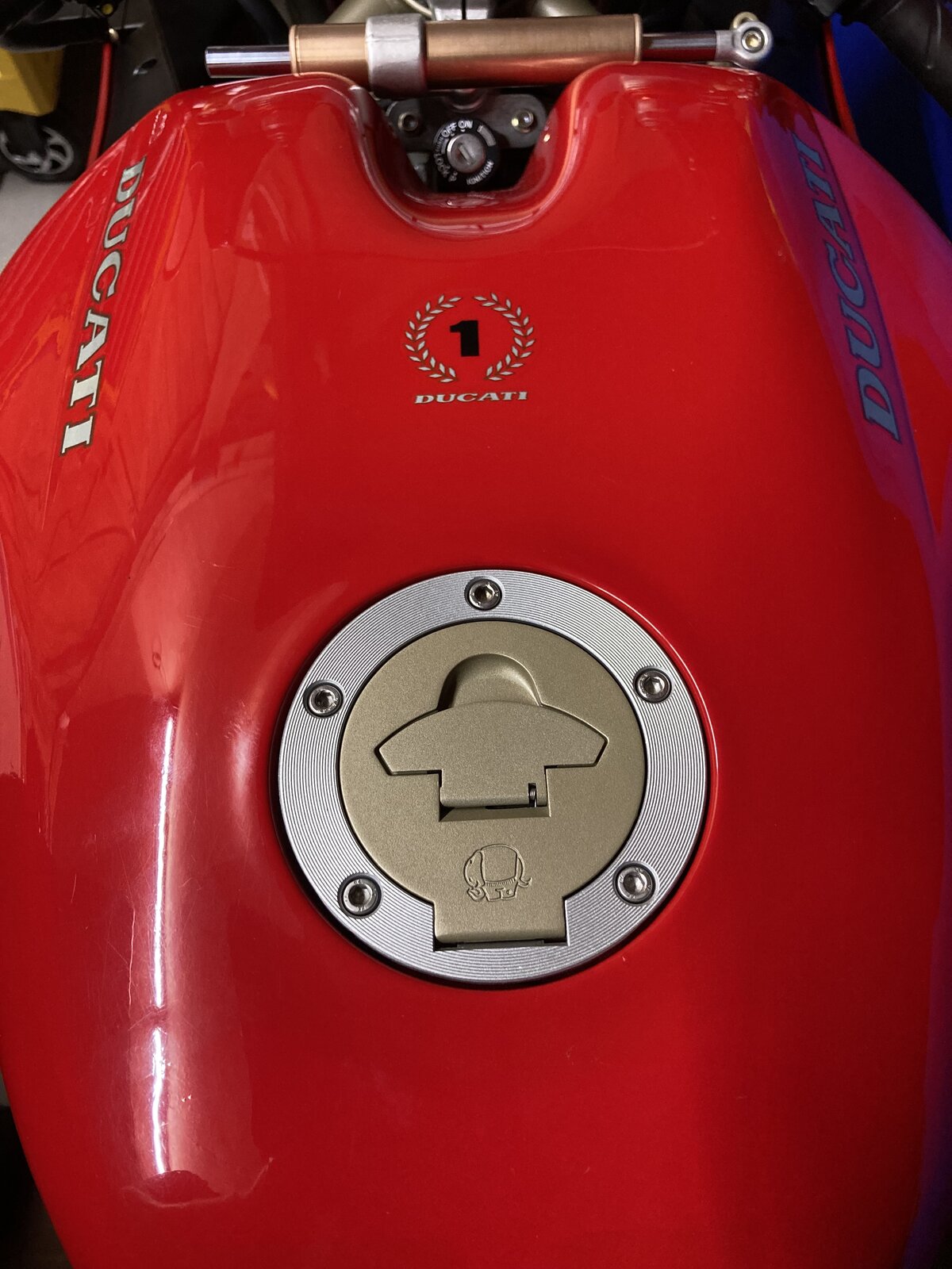

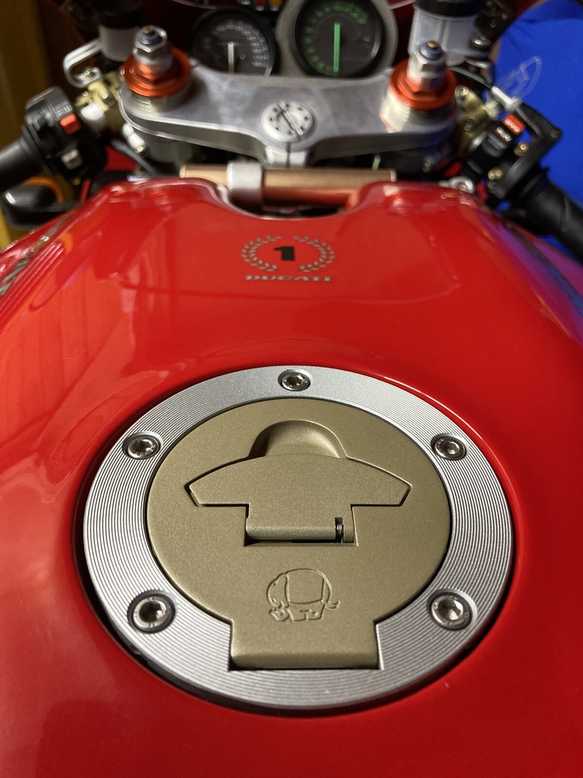

Refurbished my 916 petrol cap - the original paint wasn’t great & the alloy was lightly pitted. Completely disassembled, paint stripped, scotchpad everything, etch primer, Bronzo Opaco base cost (aluminium silver engine paint a perfect match for the outer ring), several coats of petrol resistant matt lacquer. Hardest part was removing the two roll pins holding the cap to the outer frame, as they cannot be pressed through, so I used some heat and a sharp pick to lever them out using the roll pin slot for purchase. Pressing back in was no problem though.
