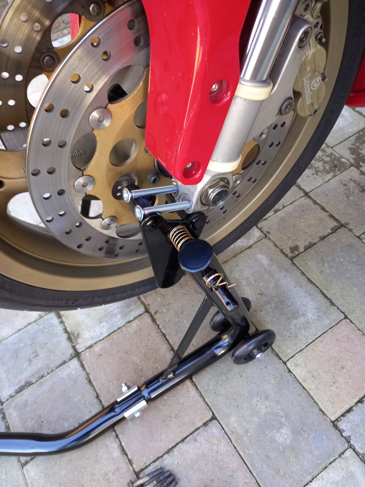

  1. Just be careful putting too much load on the bolts, the bottom of the forks can crack in this area. Usually because the clamp bolts have been overtightened but its still a weak point.

  3. That's a very pertinent point and one that I hadn't considered. I shall endeavour to come up with a plan B failsafe perhaps in the form of a cable from the rafter. Thank you.
  4. I should have added that the bolts are threaded right through the fork so the force is not actually just on the outer quadrant but on the entire fork. It was just necessary to get the vertical bar of the paddock stand away from the line of the axle.

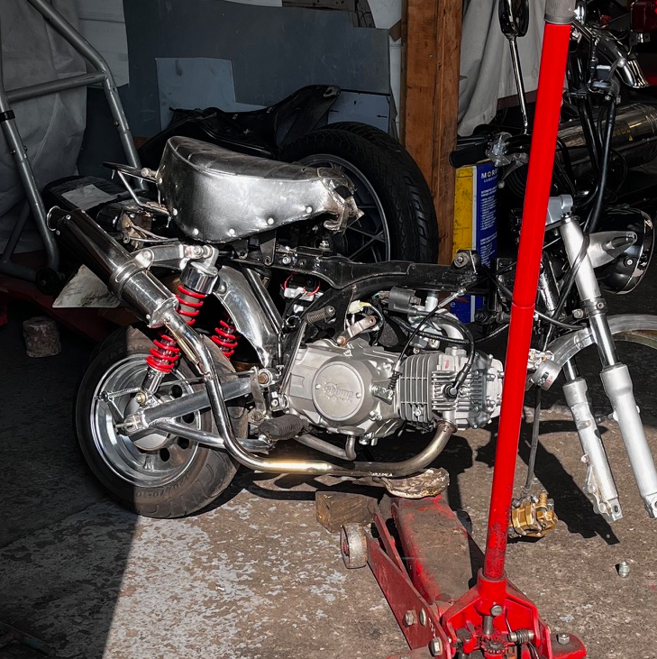

  6. A common or garden ladder over your bike and a few tiedown straps works well.
    This vid shows a Grom, but I've done this on much heavier bikes, without issue mainly using hooks
