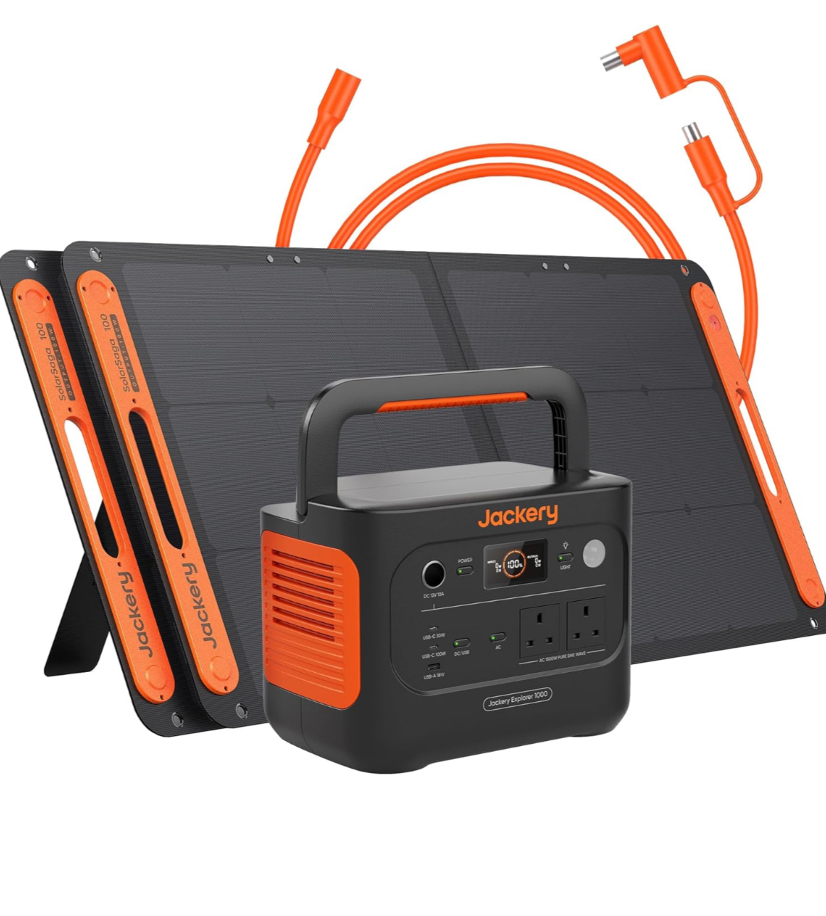

  2. We don't have EHU in/on the van at the moment, in do have an 1800w power bank with 200w solar panel to recharge if we need mains power, it also has 12V cigarette lighter socket, USB and USB-C sockets

  3. I’ve just bought one of these in order to improve my MH’s off-grid capabilities without having to go to all the ballache and expense of a solar installation.
    My MH is in for repairs at the moment so I’ve not used it yet, but they get good reviews.
    https://www.amazon.co.uk/gp/aw/d/B0...mob_b_asin_title#immersive-view_1760811051233
