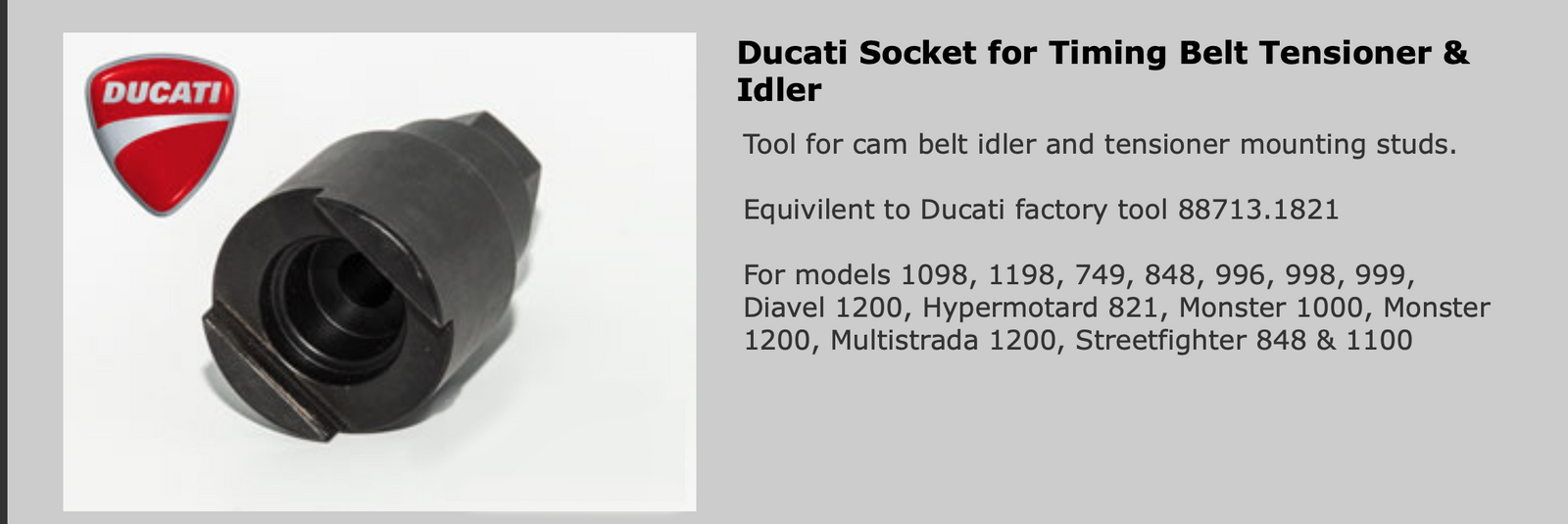

  1. Anyone know of a cheaper alternative (less than £50) for this tool?
    Ducati tool 88713.1821 for removal/installation of timing belt idler & tensioner studs.
    £50 is a bit rich for a one off job.
    Or has anyone got a used one they would like to part with?

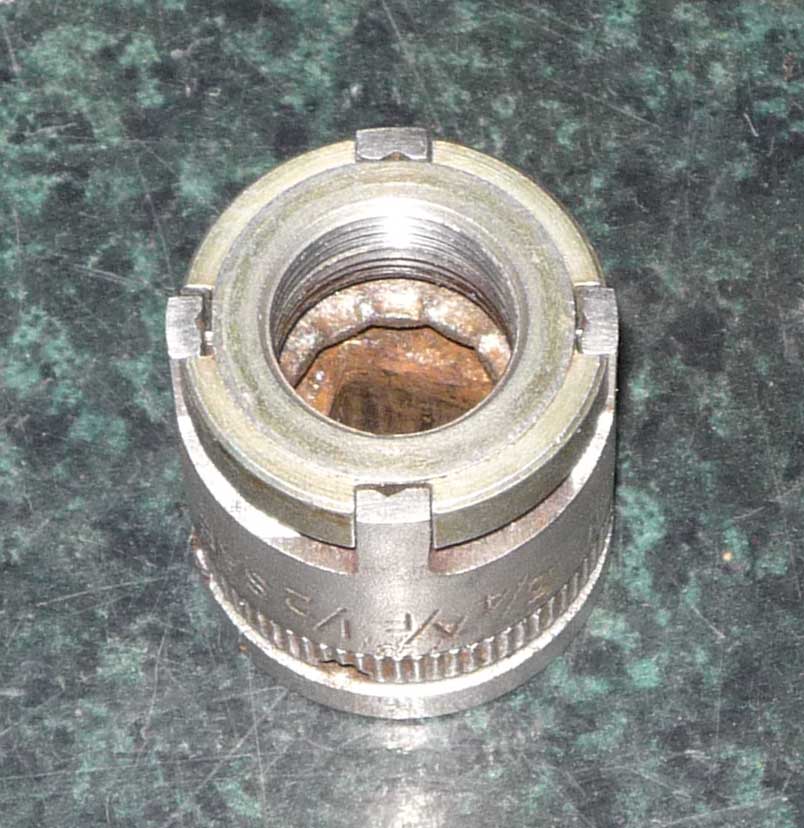

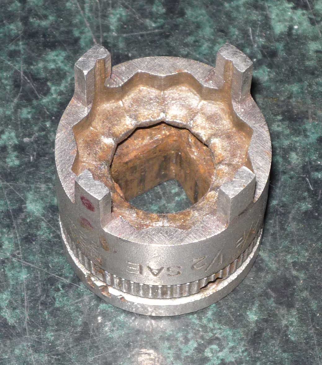

  8. Make one.
    Here is one I made for the other type of silly nuts......
  9. Can you do a drawing for what you need?
  10. Surely coming away from the centre of the nut/bolt to be torqued would be a false reading ie over torquing ?
  11. No.....just an old socket, a hacksaw and a file.
    All you need is the other type of socket with six flats that has the correct dimension across two flats......Cut out the four flats that aren't needed.
    Much easier to make than my one........because you could use a grinder.
  12. And we're off.
  13. Nice job Al, I’ve made several similar items over the years, they’ve all worked well but looked wanky, yours is a work of art! :)

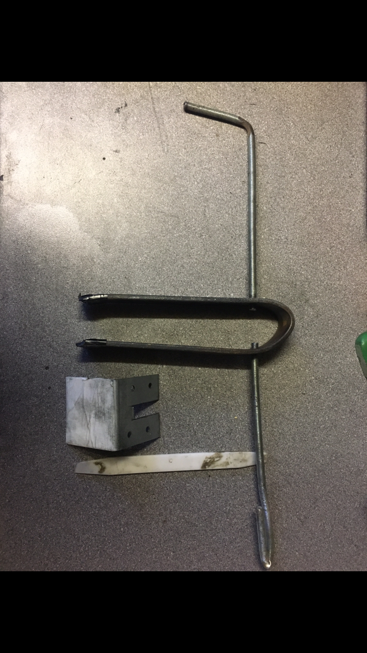

  15. Well if you do OT please include my superb fork spring compressor :)
