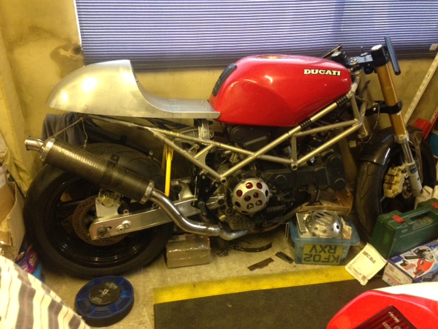

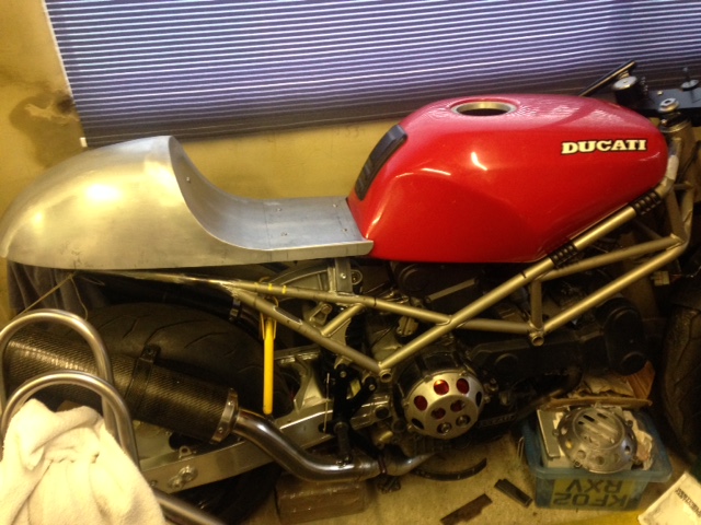

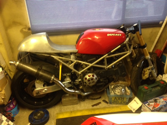

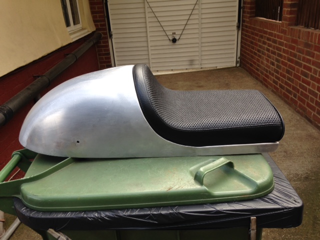

  9. @ducati dad where did the tank come from?
    Also that frame's been chopped and altered at the back hasn't it? Did you do that yourself?

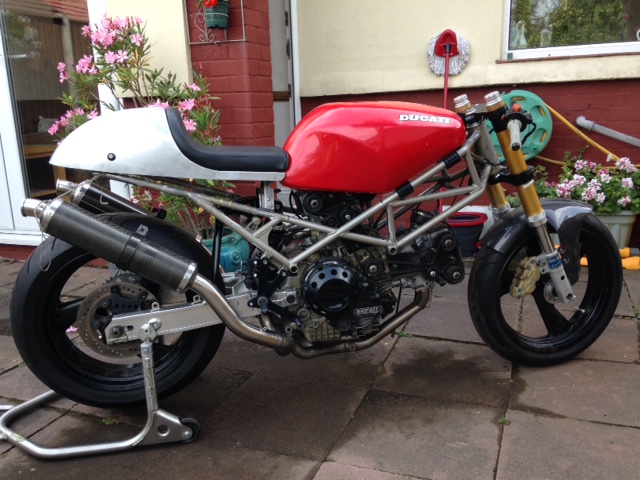

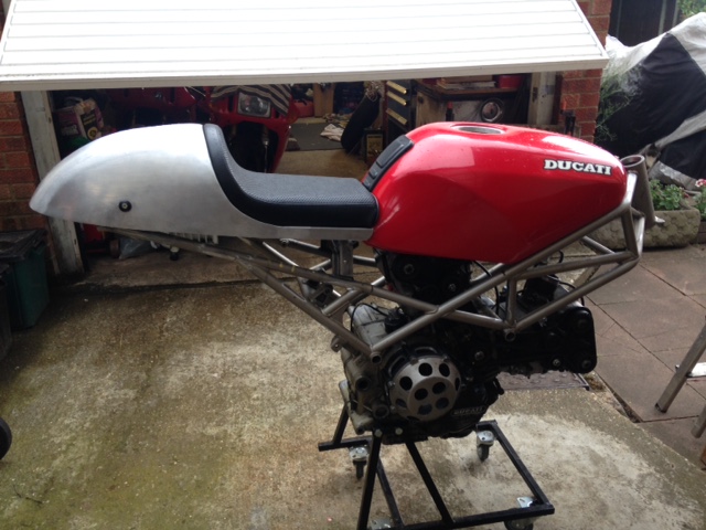

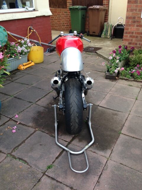

    • Like Like x 7

  12. The tank is an early alloy 851 but not the one I'll be using, I will be using a later alloy 851 tank purely because I have the fuel cap and surrounding gubbins [there is a difference between the two] .. I cut the rear frame loop once I had the rear seat unit to determine the length visually where I wanted it to end.. [ I hope that makes sense]..

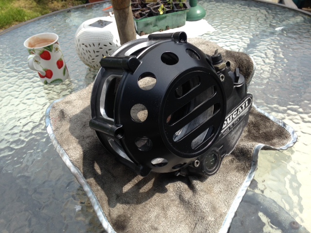

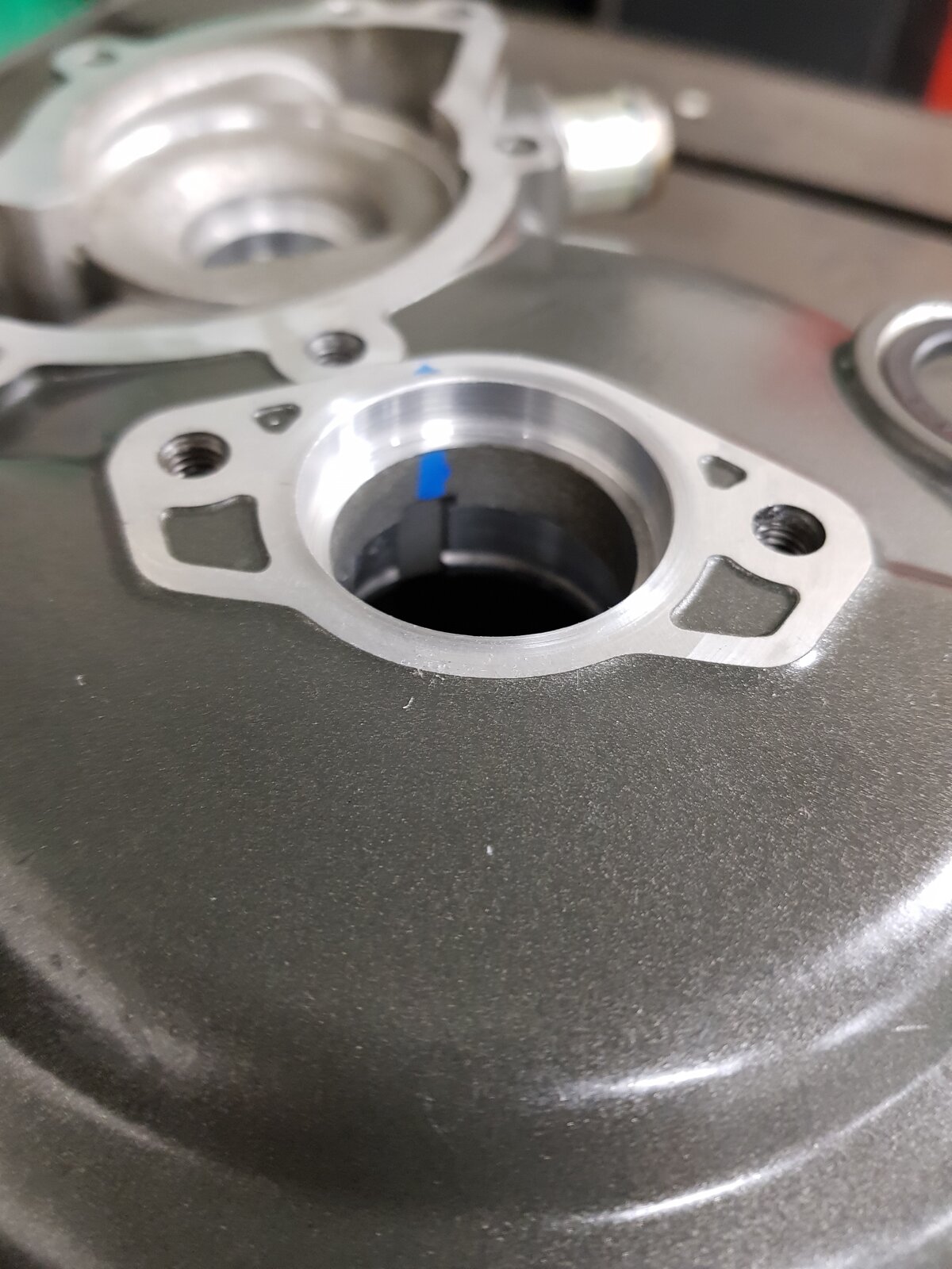

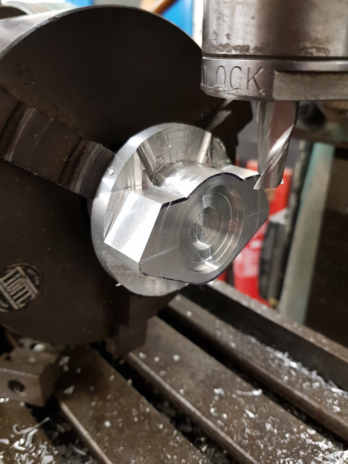

  14. 996 Alternator cover modified to convert 888 engine to 3 phase alt. Spigot bearing needs moving to the outside section of the cover.
    New inspection cover being made to compensate for longer 888 crank.

  17. Especially when he's machining parts for me...:upyeah:

  19. The bike will run on 1098 loom, ecu and dash.
    The cover is a single pickup, I think late 748 or 996.
    A 748 straight cut timing gear set has been fitted. With the cut outs on the gear.
    To get the timing correct for the crank position/ and pick up, a few options are available.
    1, everything lines up...
    2, broach a new key way in the gear.
    3, weld up the gap in the teeth on the timing gear and machine the gap on the teeth where needed.
    4, machine and weld a new boss on the alt cover in the correct position.
    5, see if the map in the ecu can be altered, to compensate.
